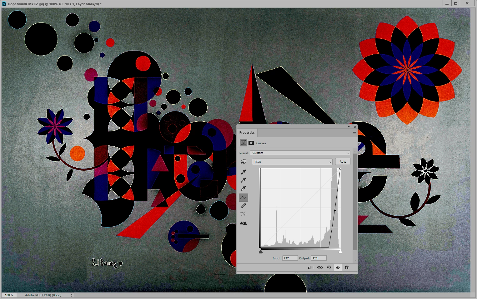

Here's a neat trick: put a steep curves layer on top. This will immediately reveal uneven lighting and other problems. Add anothe layer underneath to correct using masks and soft brushes, painting in the correction.

Thanks for the advice! I learned a few of the lighting things you mentioned the hard way, lots and lots of images. In the case of this mural, it is a large mural in a small space so light angles were definitely a problem. I had heard about the cross polarization idea before and I would like to try it. Unfortunately it will have to wait a while (starving artist). In the mean time I will try your post photo suggestions. Not sure what a steep curves layer is (noob), but I will look it up and let you know how it works. Nice to know I am not the only one suffering the ravages of fine art photography.
