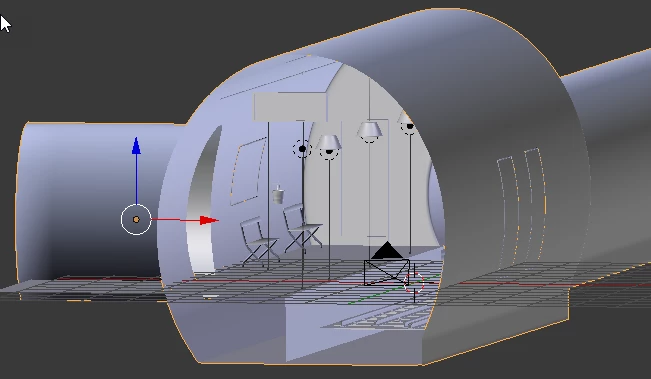

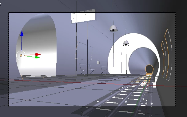

Hi Trevor
Thank you. For anyone interested , the objects are modelled in Blender, including things like the rails, clips, insulaters etc. Then the finer surface detail, including the tiles and  grout, was added in Substance Painter building up the surface materials in layers. So the recessed grout is not modelled but uses a normal map to simulate the position of the fine surface details. The render then uses the normal map to cast the shadows and catch the light on the surface realistically.
The untextured model looks like this:
So back to SFTW - have fun !
