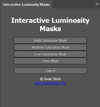

    David, it sounds like you are talking about a classic luminosity mask.  Tony Kyper is probably the best known producer of a LM extension, but his are not free.  In use Sven Stork's Interactive Luminosity Mask extension which is free, and works really well.
    https://www.adobeexchange.com/creativecloud.details.12307.html

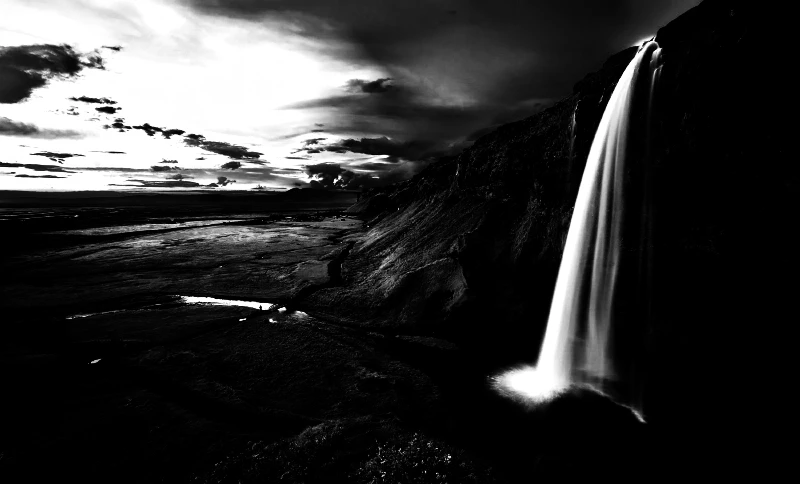

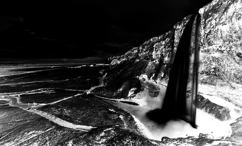

    So if I start with this high contrast landscape

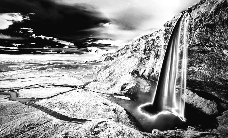

    I can split it into Highlights
    Midtones
    And shadows
    It will also produce Saturation masks.

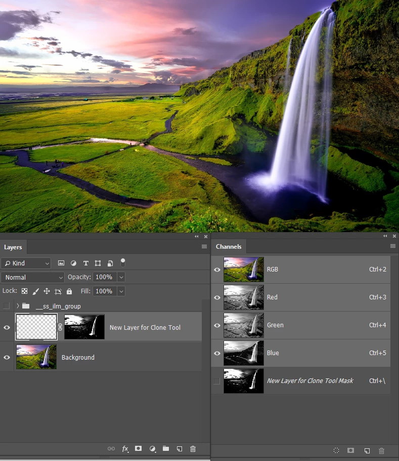

    Incidentally, and I hope I am not teaching you to suck eggs, but one way to achieve your end goal is:
    Having produced the first Luminosity Mask — in this case the Highlights
    Add a new layer (I have named it Clone tool)
    Ctrl (Cmd) click any of the Channels to load it as a selection.
    And add a layer mask to the new layer.
    Turn off the Luminosity Mask group, and you are good to go.
    I am sure you knew all that, but it might be helpful to someone.

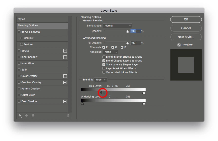

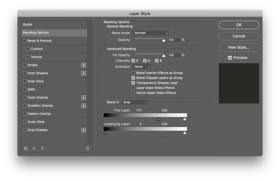

    What you can do is this. Make two copies of the image in a new layer. Select the top layer and go to Layer Styles - Blend if. Move the left slider to 170. That make make the top layer transparent for each pixel that is below 170.
    Select the middle layer and do the same, but for this layer set the slider to 85. That will make the middle layer transparent for each pixel below 85. So you now have three layers: all pixels below 85 will effectively be in the background layer, all pixels between 85 and 170 will be in the middle layer and all pixels above 170 will be in the top layer.
    The transitions will be hard, however. If you want smoother transitions, then hold down the Alt-key and drag on one half of the slider. That will split the slider into two parts, and the transition will be between the two parts. For the middle layer you could set both halves to 80 and 90, for example.
