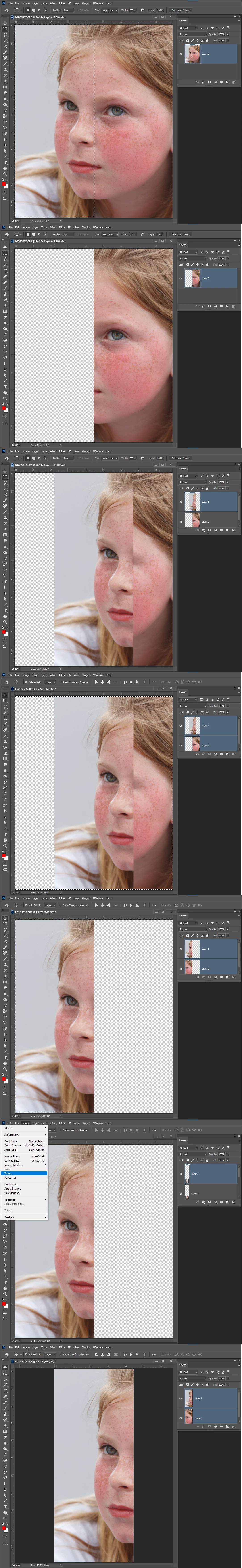

Select the left half of your image in a normal Layer 50% width 100% height
Ctrl+X cut the left half.
Ctrl+V paste left half in as a new upper layer
Ctrl+A Select All
Target Both Layers
Align Layer to selection left.
Image Trim to remove the transparent area.
Print your two 4.5" x 11" 300PPI  layers one at a time.
You can save the document as a PSD for future use.
JJMack

it seems the easiest way for me to do this at the minute is how the first comment suggested, i basically make 2 copys of my png,make a selection of where i want the cut to be,delete half, then go to the 2nd copy, invert selection and delete that half,that way i know both layers will join together, then i just close the image and dont save so it stays as 1 image,but im thinking now that i could save them as that way i dont have to mess about when i need to do another print.
