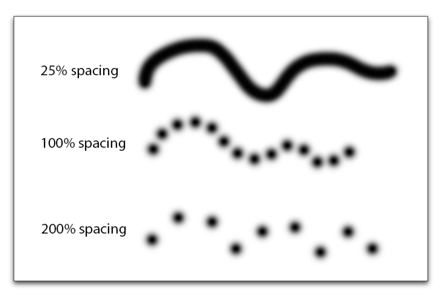

    Hi. When using the spot healing brush, have you ensured that you're:
    1) using a spacing setting that's appropriate to your brush size?
    2) using Content-Aware, instead of Create Texture for the brush Type?
    Checking those may help.

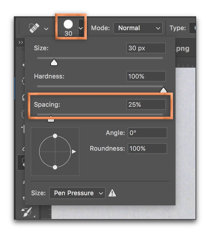

    It's the spacing value. You can reset all defaults, or just reset the brush.
    1. Select the Spot Healing brush
    2. Click the brush on the Options Bar
    3. Change the spacing back to 25%.
