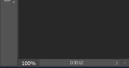

D3D12 is desired when you switch to GPU mode.

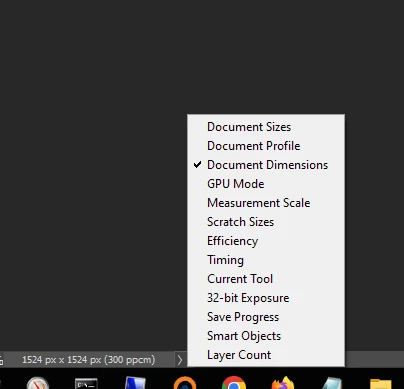

November 10, 2023
It was on 'document dimensions' but I switched it to GPU with no noticeable difference. Still freezing and lagging

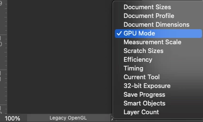

Kevin Stohlmeyer
November 9, 2023
@ianf39773764 in Photoshop go to the lower left corner of your open document workspace. Change the setting to show GPU Mode. What does it show when you stall?
