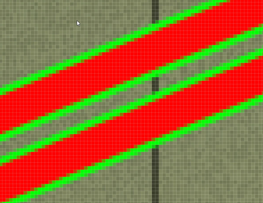

So I make a red shape with a green shape surrounding it, Merge the shapes but I need rotate it (to be exact I just rotate as perfect 45 degrees). But when I rotate the shapes I get arttifacts on the edges (as always), and I have to penicil in the full colors, which takes about an hour.

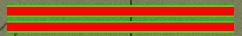

Here is what I see when I do it: First solid Shapes:
Now after the rotate:

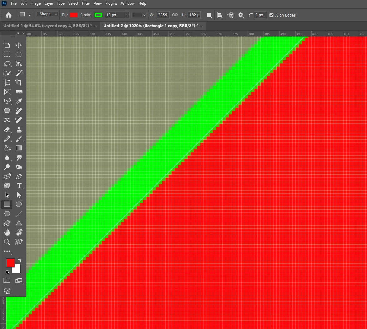

You are zoomed way in to the pixel grid, and looking at anti aliasing.
That looks like you are using raster (pixel) layers.  Vector Shape layers still use Anti Aliasing, but it might be less pronunced.
This is a stroked vector shape layer rotated to 45° with a similar zoom ratio (we can see the pixel grid)

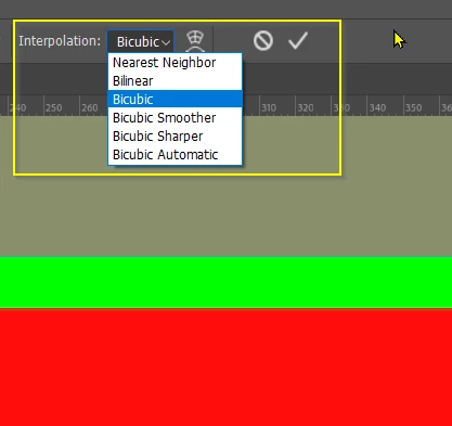

When you rotate a layer using Free Transform, yoy have a choice of Interpolation method
If you use Nearest Neighbor it will not use anti aliasing to smooth the diagonal.

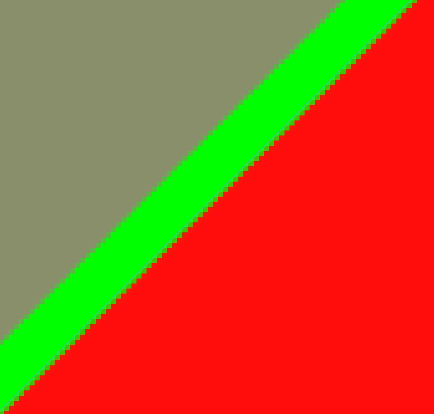

Yep, using nearest neighbor when rotating dit what I wanted to do.
Thanks again for your replies guys,

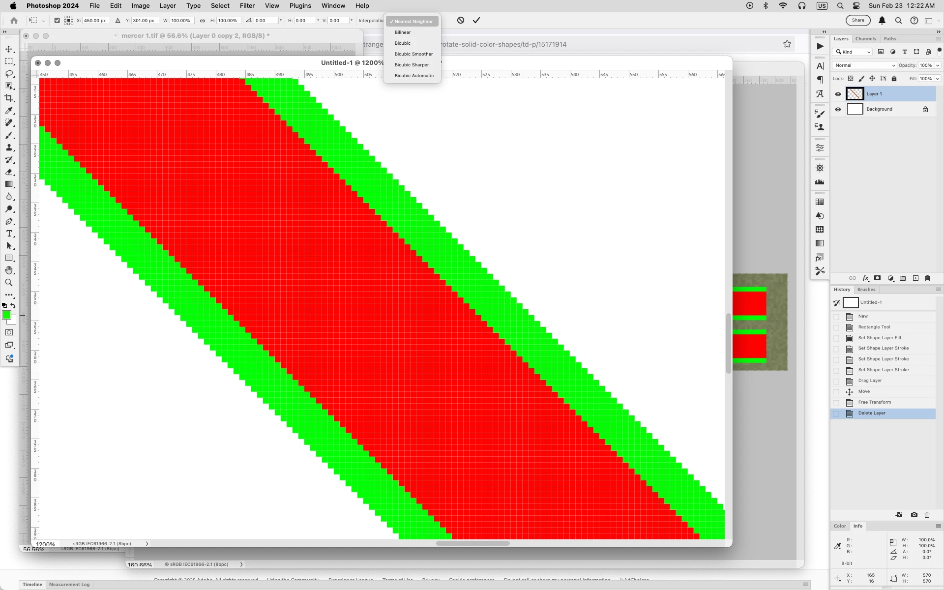

Before rotating change the interpolation method to Nearest Neighbor in the tool options bar.
