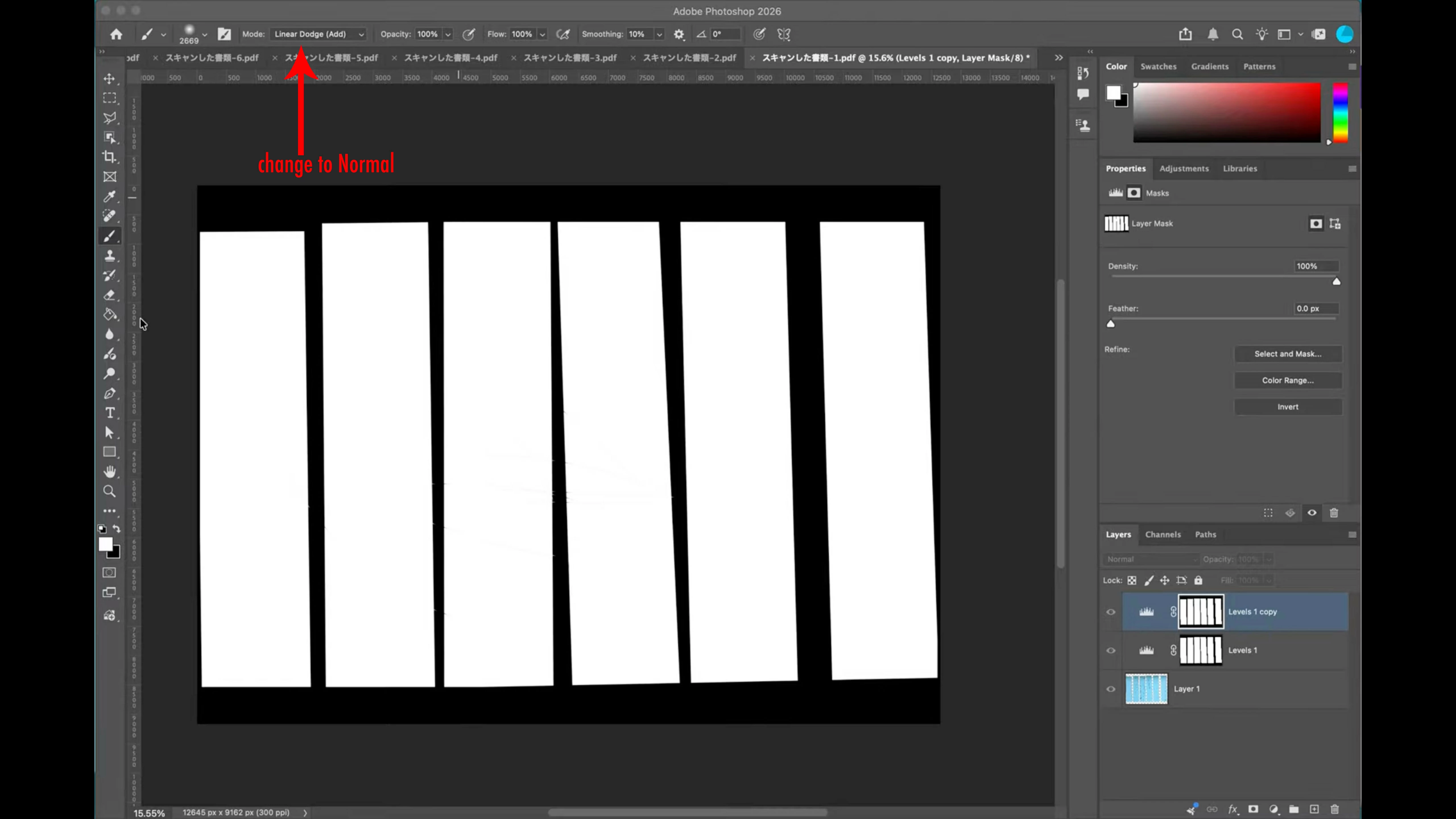

the mask brush does not work
Even though i am selecting a black brush, on the mask layer, I am not able to brush the mask with black. On the other hand there is no problem with using a white brush, as seen on the youtube video.

    Jeff ArolaCorrect answer
    Jul 15, 2026 5:44 AM UTC
    Change the Brush Mode back to Normal
