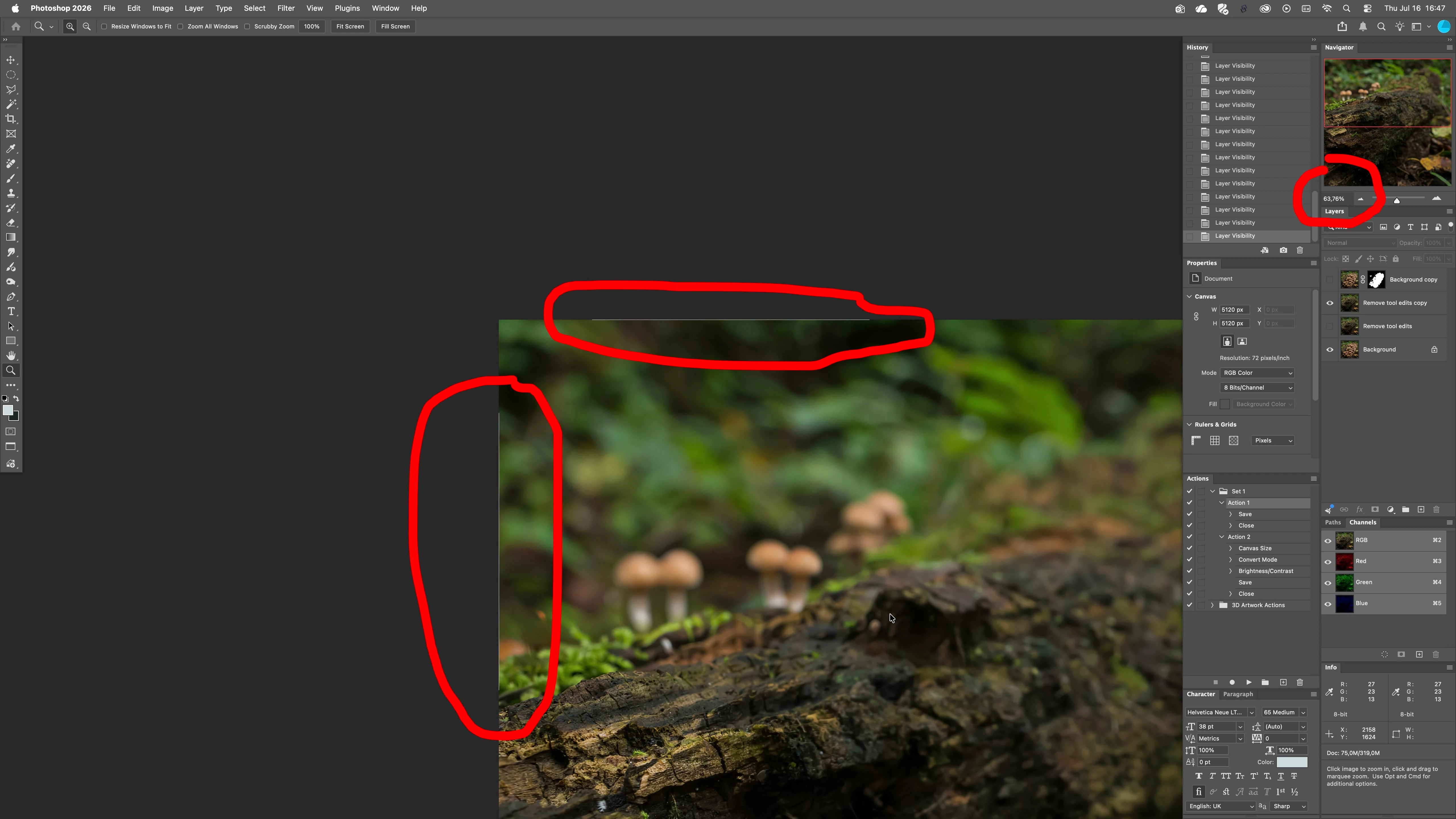

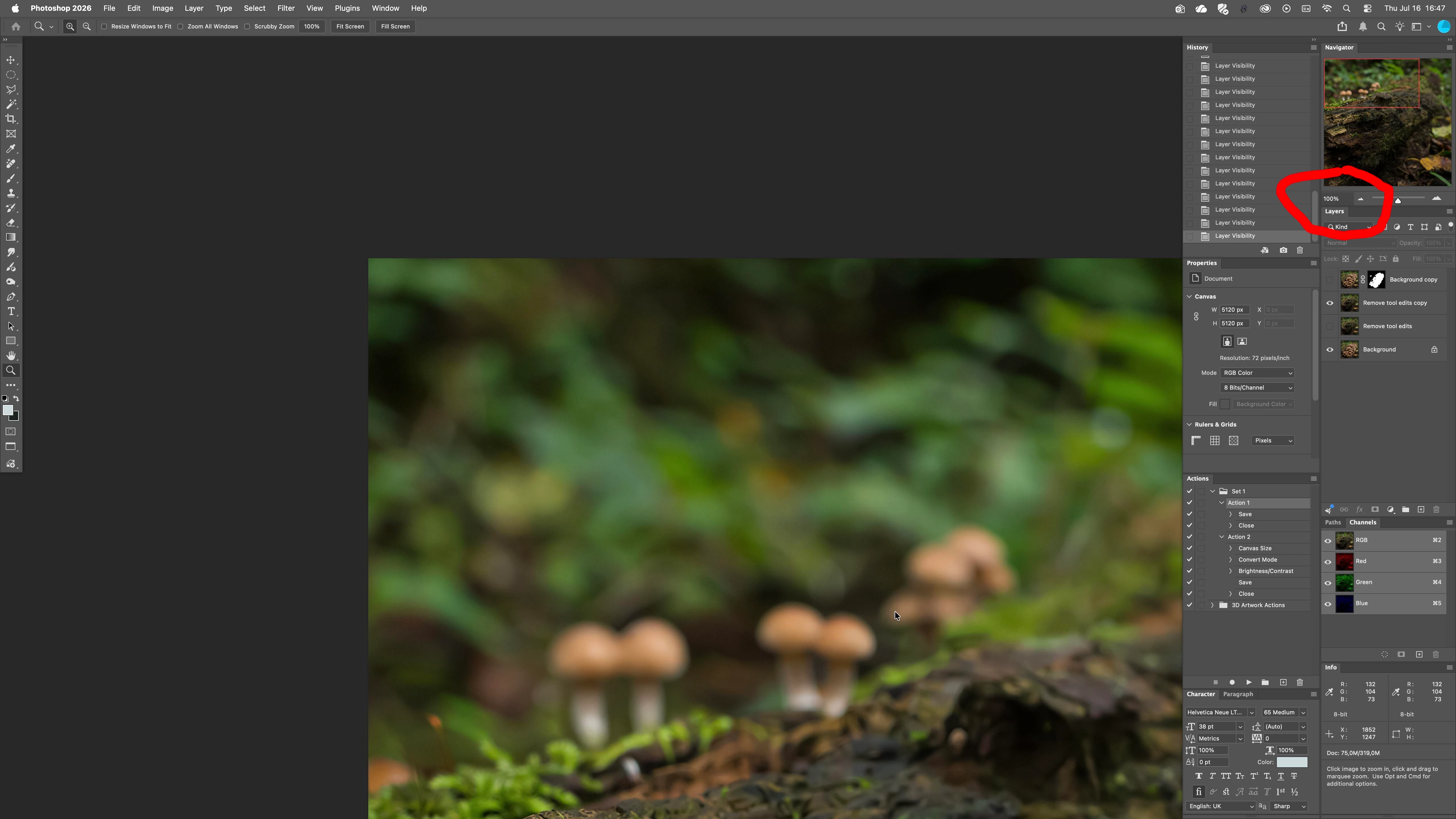

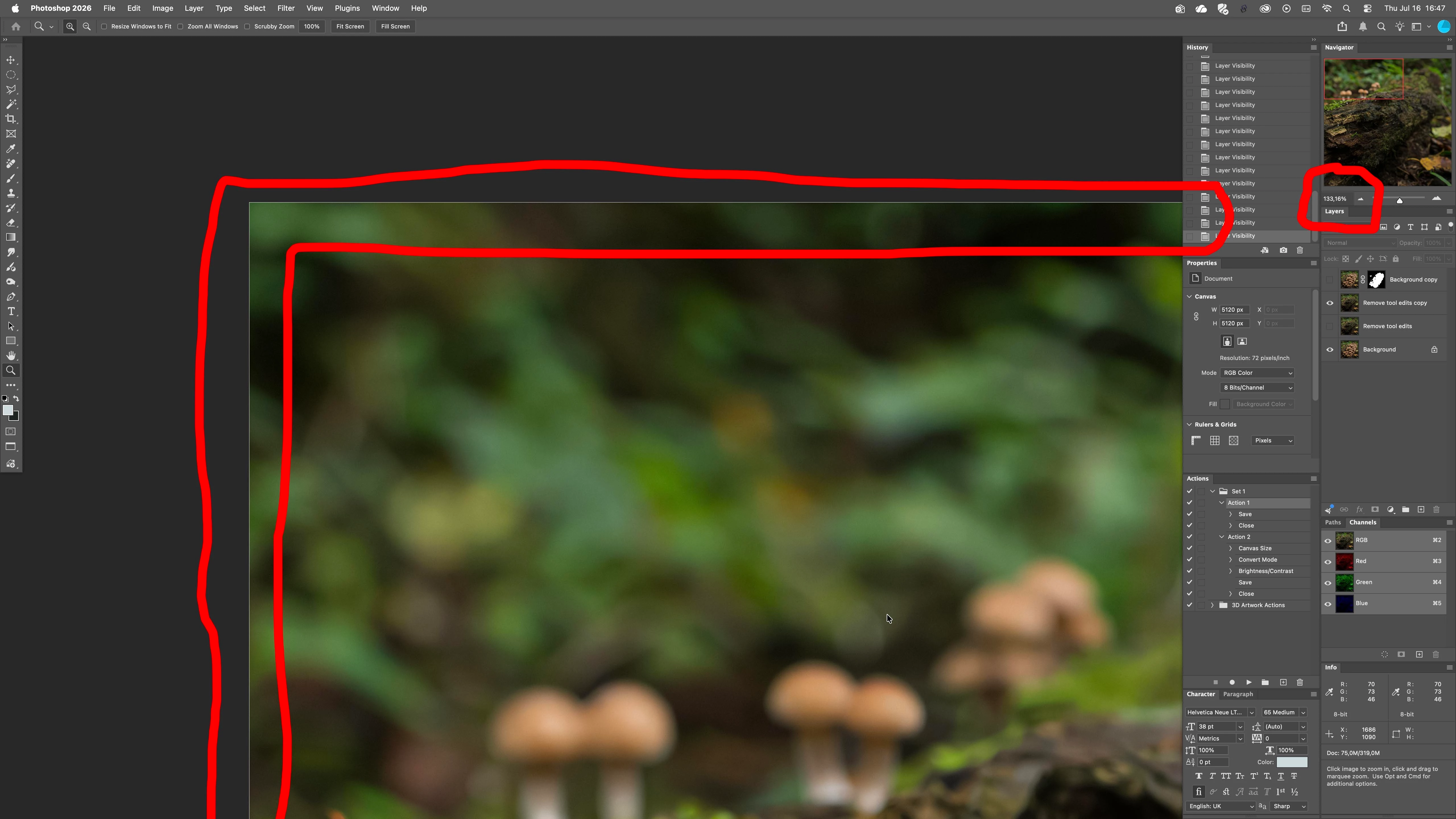

    Jul 16, 2026 2:52 PM UTC
    See attachments for the issue. Is it recognized as a bug? Is there a plan for a fix?
    D Fosse
    Jul 16, 2026 5:07 PM UTC
    ​@JacquesCapeTown
    As explained elsewhere, this is a result of screen resampling of floating layers. A floating layer can contain content outside the canvas boundary, so the transparent pixels outside the canvas are included in the resampling.
    In other words, not a bug, just a side effect of layer properties.
    It does not happen at 100% with no resampling, and it does not happen wit a flat background layer with no off-canvas pixels.
