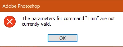

"the parameters for command trim are not currently valid"

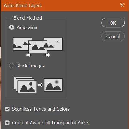

Hey i've got this problem where whenever I do an auto blend it comes up with "the parameters for command trim are not currently valid". I've been autoblending for a while and it always worked but now it is coming up with this error so I'm not sure what to do? For this im using autoblend panorama with both options ticked which I have always been using and I've check other videos of face swaps and stuff. Does anyone know how to stop this error?
Thanks if you can help

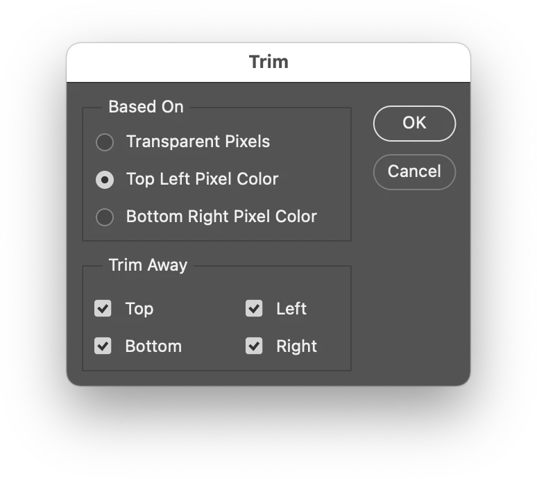

If Auto-blend is using the Trim command silently in the background without user input, perhaps looking at the Trim command options and comparing to your document will provide a clue:

Hello, maybe there's no answer because no a lot of information was provided: the size of images, their type, an example, to see if there is enough overlap, if it was tried with the options below unchecked; the exact version of Photoshop where this happens, the operating system, the troubleshooting steps that have been tried so far...
