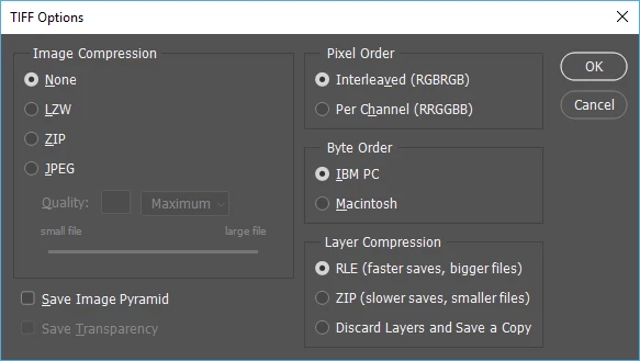

JJMack is right if you select discard Layers under Layer Compression under the Layer Compression options that should decrease your file size considerably.
JJMack
July 19, 2018
Tiff file format supports data compression and can save a flattened version without layers. Have you tried all the data compression options available to see if any will save under 4GB
Reduce to 8 Bit Color if 16 bit color to cut the size in half.  Also 8 Bit color can use Jpeg  compression however its a lossy compression your image will loose much quality below quality 10.
Most Printers only support 8bit color....

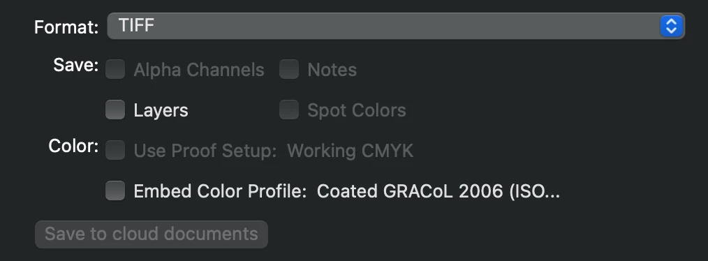

March 4, 2025
This was helpful, thank you. For me, I had to use the SAVE A COPY option, then unchecked the LAYERS option.
