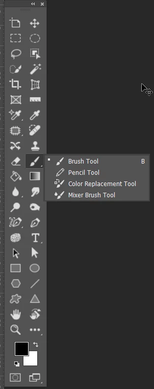

Hi!
I use Photoshop on my primary monitor, and I have an additional monitor to my left. When using photoshop, the tool selection overflows to my left monitor instead of remaining on the primary monitor, and I cant find out how to disable this "overflow" setting:
This can become quite annoying, as you can imagine. I have googled different phrasing of this, and have come up blank. Thank you for any assistance!

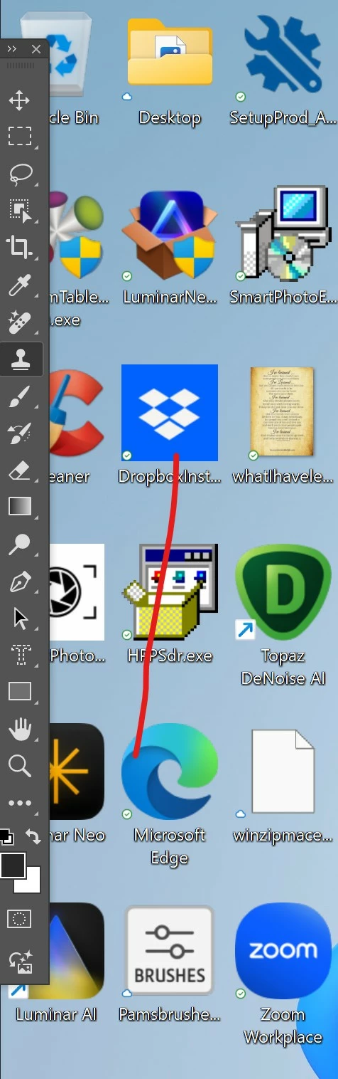

I am having the same issue with Photoshop 26.6 -- 2nd monitor (larger one) does NOT display the Photoshop menu on the leftside -- the overflow of the left tool bar menu (brushes, move tool, etc.) is on the FIRST monitor on the laptop.  Very annoying -- is there a FIX for this or steps on on the modify the screen?  Thanks

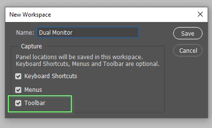

Have you tried arranging the panels the way you like them and saving it as a Custom Workspace?
I am not entirely clear on what we are seeing in your screen shot. It is nearly always best to show the entire workspace including aditional monitors, and upload it at full resolution.
Is this your main display below?
Why are we seeing the desktop?  It seems odd to see the toolbar and desktop together.

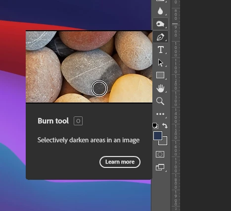

I'm still having the same issue on Photoshop 2024 on Windows 11. I still have tooltips showing up on my secondary monitor to the left
The workaround that has worked best for me is to run photoshop floating with and nearly fullscreen.
Here's an example where the tooltip should be displaying to the right, but is displaying almost exclusively on my secondary screen

Yep, I also see the description tooltip displaying on the left secondary monitor in the most recent version.  However I'm glad they at least fixed the location of the tool selection menu, that was far more annoying.

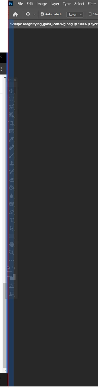

Same issue. Haven't found a fix yet. For now there are two options; undocking the toolbar or not maximizing Photoshop.
The problem is the Photoshop doesn't maximize properly, and thinks its rolling over onto the next monitor.
You can clearly see that it even cuts off the ruler as well.

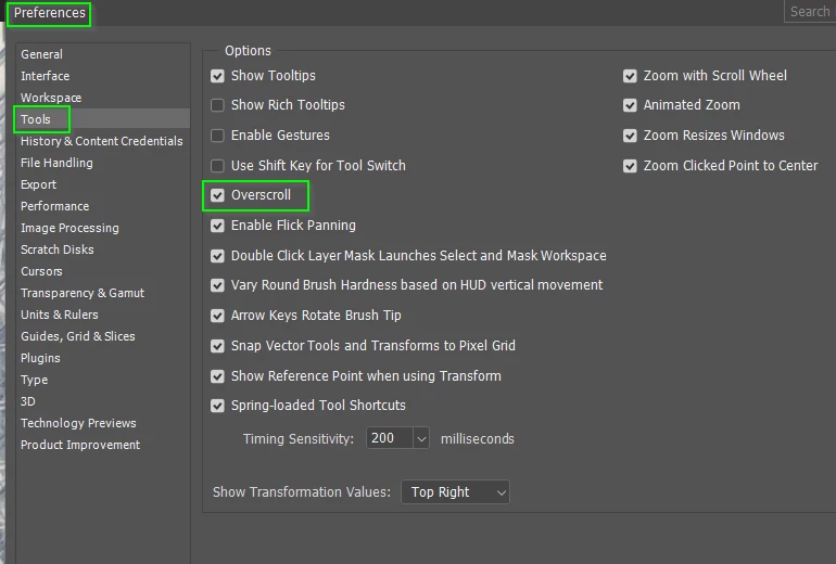

It might be worth making sure that Overscroll is turned on.  AFAIK it does not affect the UI as such, but it does affect how document windows are displayed.  So a long shot but worth trying.

When you get it right, save it with your default dual monitor workspace.

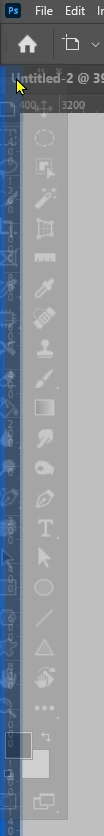

Mar 2, 2023 2:03 AM UTC
Thanks! The toolbar is docked, but you did give me an idea: Undocking the toolbar and moving it about 10px from the edge seems to solve the issue, kind of annoying that I can't dock it though. When I do dock it I get an "overflow" of blue onto the second monitor:

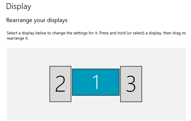

Check your display settings. (right click the Windows Desktop).  It's not possible to move one screen away from another, but try dragging the second screen to see where it springs to.

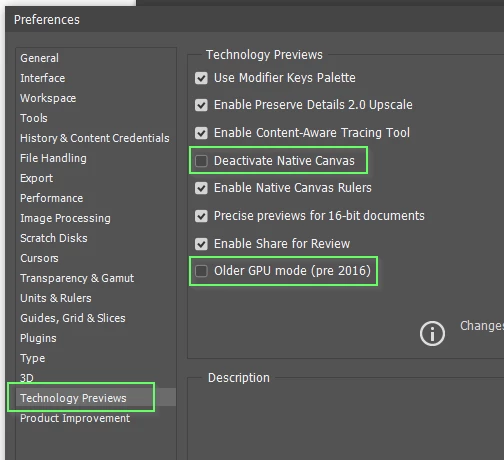

What version of Photoshop are you using? Try experimenting with these settings.
The bottom line is, and I am not 100% on this, if the toolbar is docked, I don't think it can overflow into the left hand screen.
