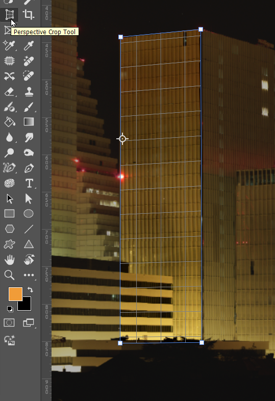

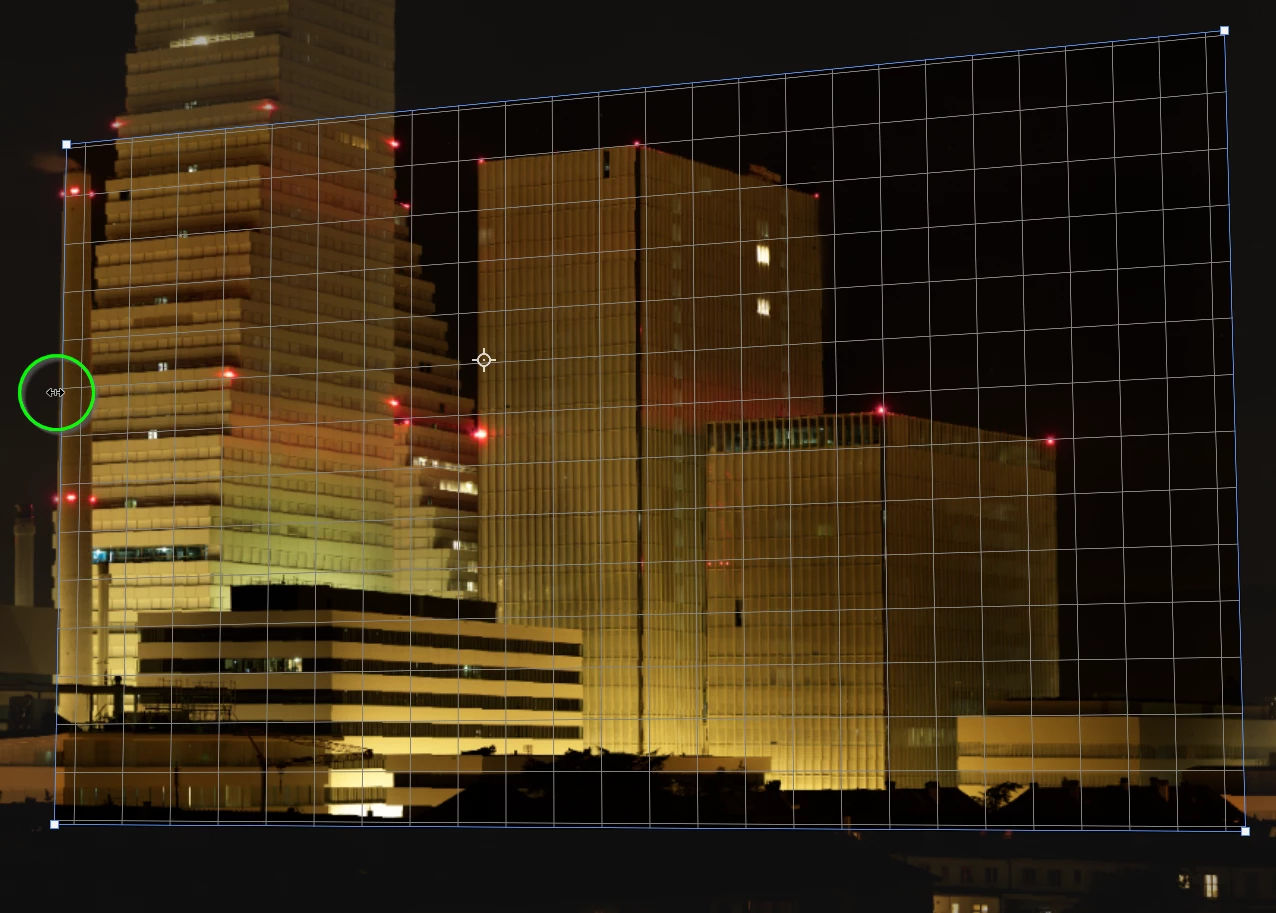

I generally use Perspective Crop for this situation.  Even if you can't see all four corners, you can align the PC grid lines to windows etc.
When you a good alignment on a good reference object like the building above, you can drag to open the sides of the bounding box to include other objects/building that are on the same plane
OK that and you are good to go.
Bobus tip:  😉   I turned on the Grid above to reference the alignment against.  A quick and easy way to adjust the Grid density is to open the Image Size dialog, uncheck Resample and increase Resolution to make the grid less dense.

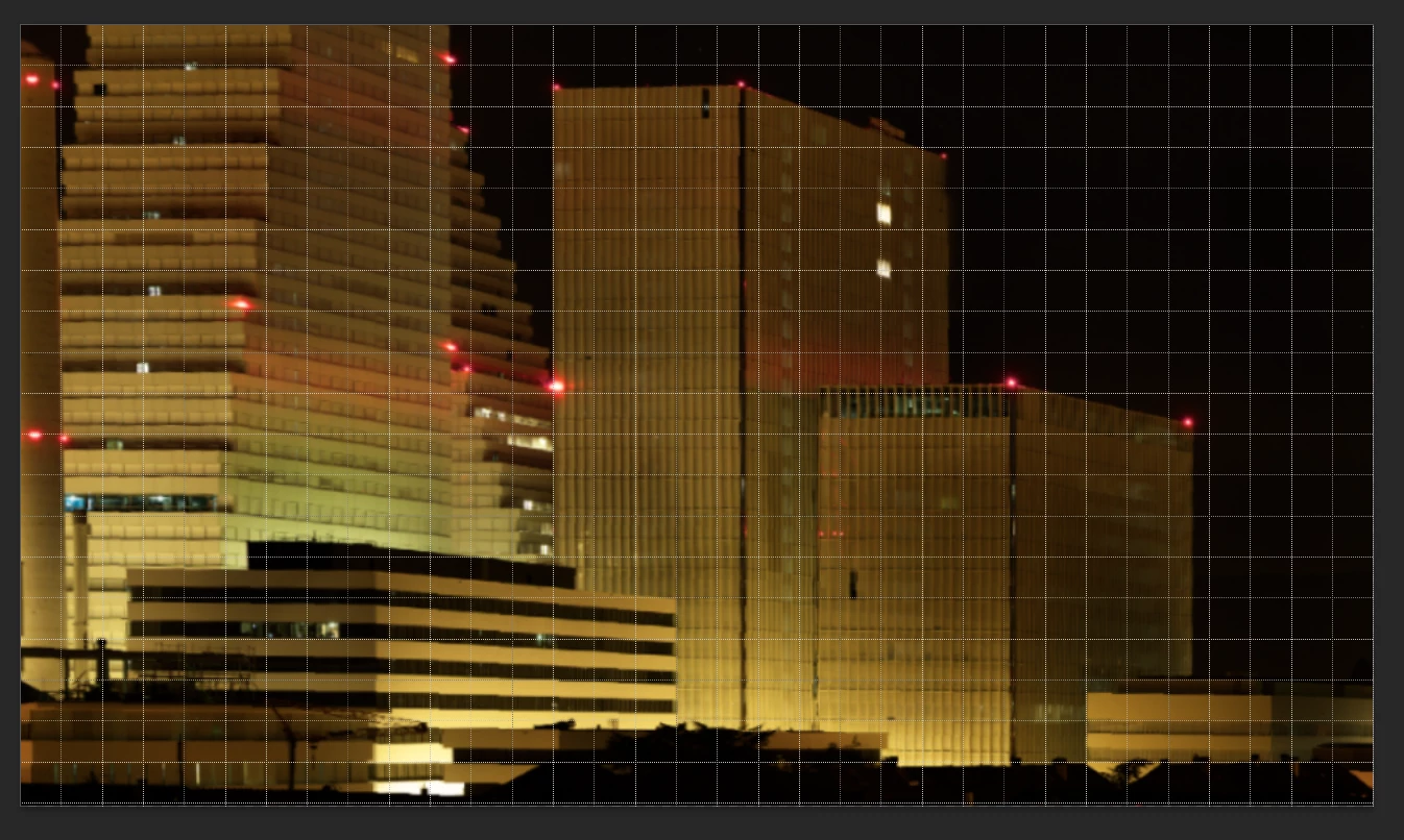

Which side of the buildings are you interested in? The angled steps on the one building could be tricky. I would probably us Free Transform (with the Grid showing) for this sort of thing, but a better answer is to photograph the subject from a more straight-on vantage point.
June 24, 2024
Thank you folks. So indeed free transform and perspective warps are the way to go.
