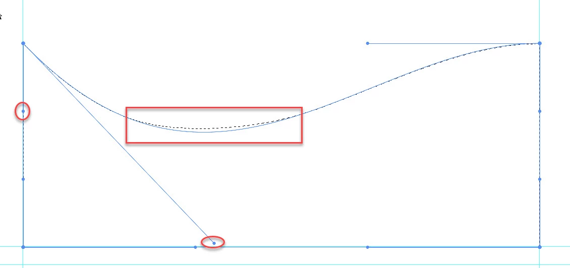

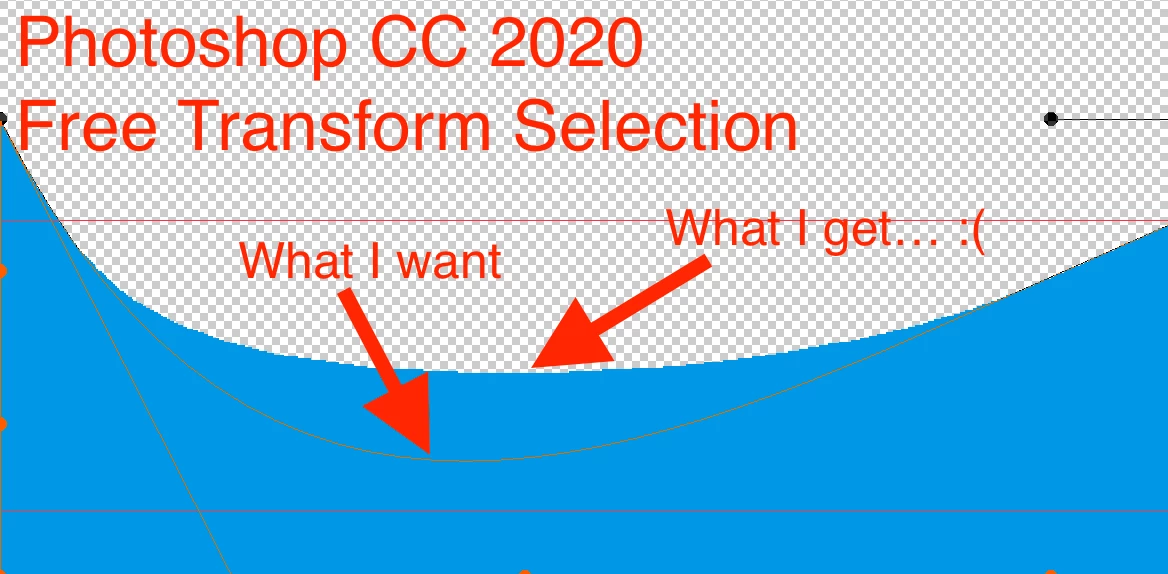

I'm trying to create a "wave", but something's off, I'm not able to explain it, which is why I have attached a screendump, with what I what, and what I get.
This is extremely frustrating!!!! (Sorry)

I can replicate your issue here. The marching ants showing the selection are not matching the curve set by the warp selection curve.
It seems to happen when you drag the top control well below the level of the side control.

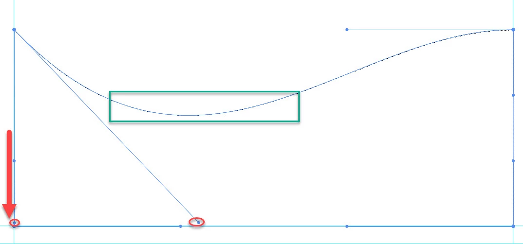

Grab the side control and drag it down to correct the issue
Although that get's around the issue, it still may be worth reporting as a bug at the link below where developers will see it:
https://feedback.photoshop.com/photoshop_family
Dave
Dave

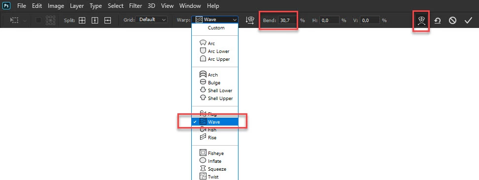

Let me gues, you are using Free Transform > Warp? There is preset list in the Options bar with Wave preset. have you tried that? You can also adjust Bend from the Options bar.

I need the wace to look exactly what I have intended, and not a standardised version (even though you can probably edit the preset wave).
Also, I need to know what I'm doing wrong, so that I may learn 🙂
