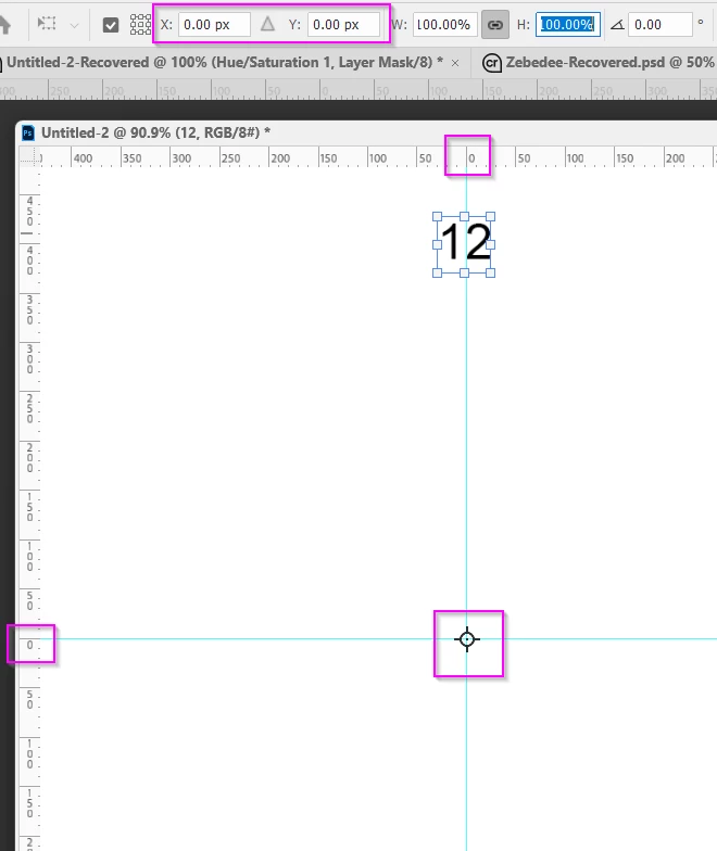

  1. What I do is drag intersecting guides to the required location, which is usually the centre of the canvas.
  2. Unfortunately, the FT Reference point will not Snap, so I drag the grid zero, zero to the guide intersection, which it will snap to.
  3. I then start the FT and Alt place the Reference close to the guide intersection, and manually type 0.0 into the X: and Y: fields in the Options bar.   BTW  The nast UI colours are for the sake of the screen shot.
I mainly use this for FT Step & Repeat when a small offset will be multiplied with each new layer, but any time you need perfect locations it will work for you.  It's just a pity that the Reference point will not Snap.

Trevor, I use Step-and-Repeat a lot, and share your frustration with the lack of snap. I usually just get it close, zoom in to 1600% to fine tune. I'll give your method a try. Ideally, I'd like to set up and perform the transform without taking my hands off the keyboard. As it is, I press Ctrl+T, grab the mouse to get to the Option Bar, and back to the keyboard to tab through the fields. This is a gripe I have about using the Option Bar in general.
The icon for the Reference Point is not, as far as I can tell, able to be accessed from the keyboard, and requires a click on a tiny, six-pixel square from a tight grid of nine. Having to squint at the screen to set it sure slows things down.
