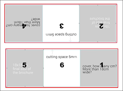

Assuming the folder is being printed on cover stock, the usual pages 4/5 are narrower in width by 1/8". (The. best  confirmation of this adjustment is to get a sample of the stock and test that allowance.) Cover stock may also require scoring. For the smoothest fold the grain of the paper should run in the direction of the fold, not across the flat sheet. Note that beyond the trim size you should provide a 1/8" bleed allowance as indicated by the red line in the diagram above. Images and tints running to the edge of the trim should extend to the bleed line. Note also that the work should be prepared head-to-head of avoid an error in planning the brochure and accommodating the 4/5 narrower panel. Black trim and fold marks. and a red bleed line should appear on the work.

Only another thing: when folded, pages 2 and 5 they should be placed side by side exactly, since they contain the same image (half on one side and half on the other), which is seen whole when folded.
I'm afraid that by making the 4/5 narrower, I would see the white that stays underneath, and it's not nice.
So I was wondering if it was possible to leave pages 3, 4, 5 and 6 of 18cm, and instead increase page 1 (therefore also page 2). And in this case, of how many millimeters?

The usual procedure when you have an image that splits across 2/5 is to extend the page 2 part of the image a strong 1/8" into page 3 -- in other words, beyond the fold.  Also, printing (ink density) on both sides of the sheet must be held to very tight tolerance and, from a folding machine standpoint, it is best when diagonals in the image not occur in the split. (In reality, sometimes that cannot be avoided. That is an additional reason scoring is advised.)

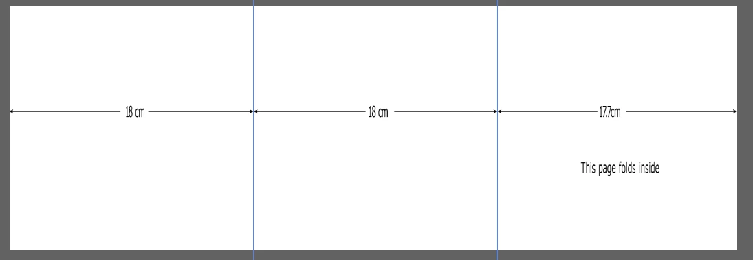

I would suggest making a document 18cm x 53.7cm. The part that gets folded inside would be 17.7 cm wide, 3mm less that the other two, so that it would fit comfortably.
This layout would be for the inside pages (when opened up). For the back, you would use the same layout, only rotate it 180°, putting the narrow page on the left.
You might have to adjust this on advice from your printer, about the allowance need for the folds.

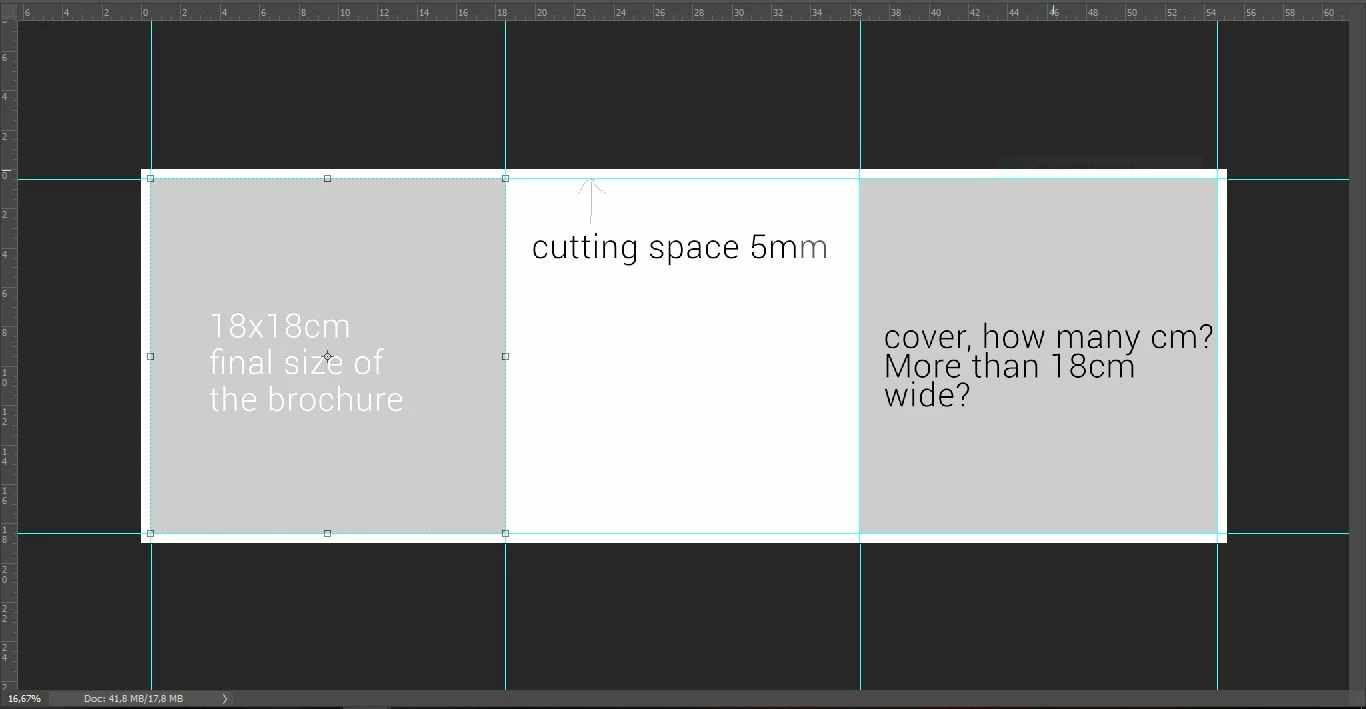

For now I tried to set the grids like this:
Searching on Google I found this: "When using a tri fold brochure template, keep in mind that each individual panel is slightly different in width, with the "cover" panel being the largest (widest), to accommodate the other two folds. It allows for the other folds to tuck up neatly, ensuring a crisp finished product"
Now I would like to know, how exactly is the size of each panel? is it ok to make the first panel (from the left) 18cm, second panel 18cm and "cover" panel 18,16cm? Or 18,16cm is still too small?
