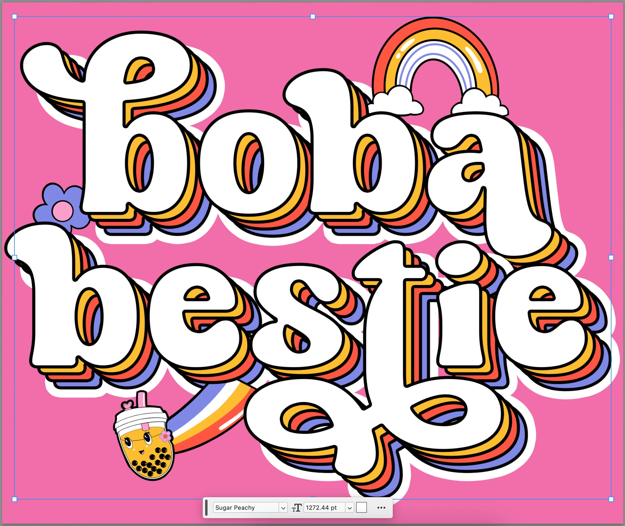

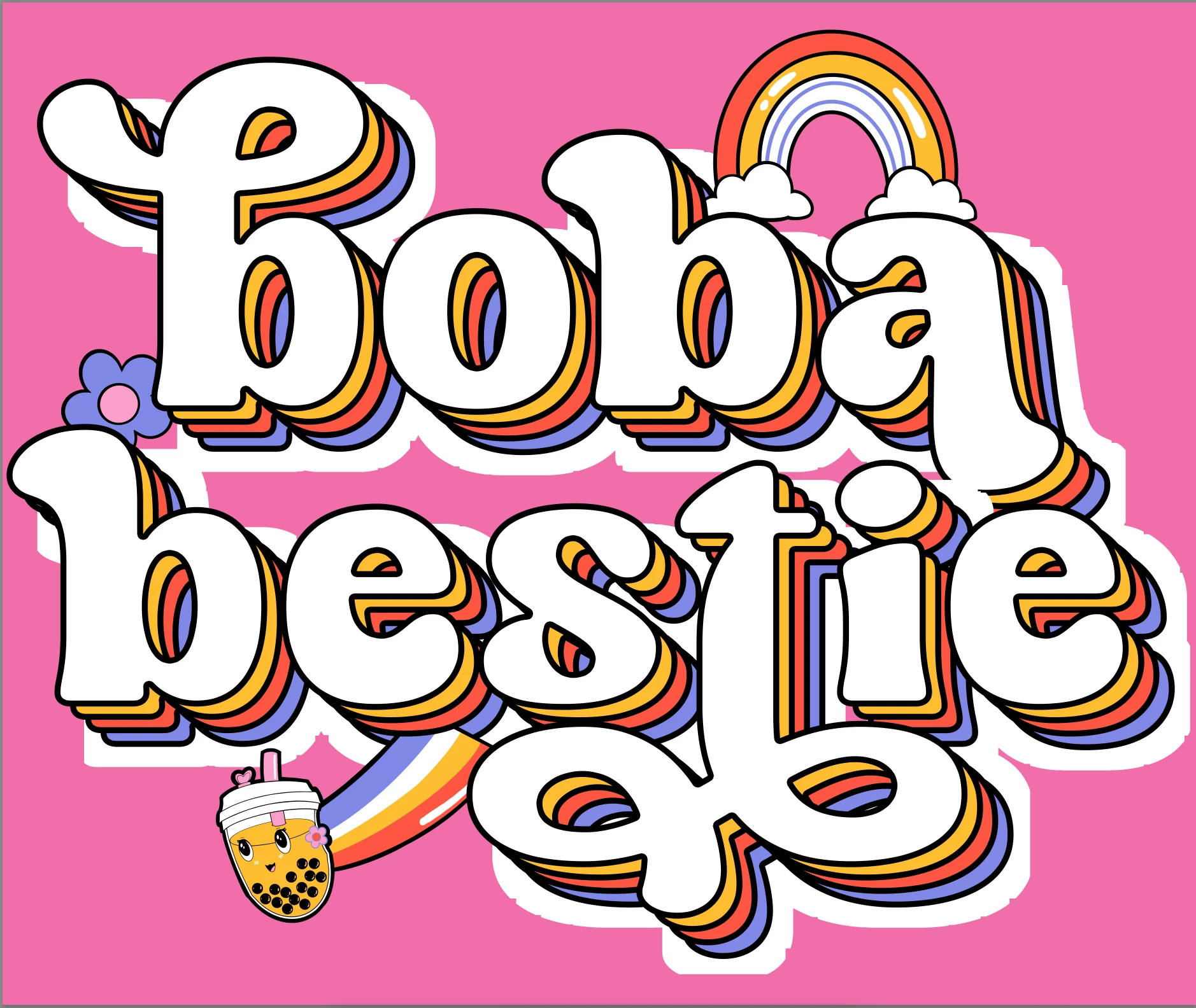

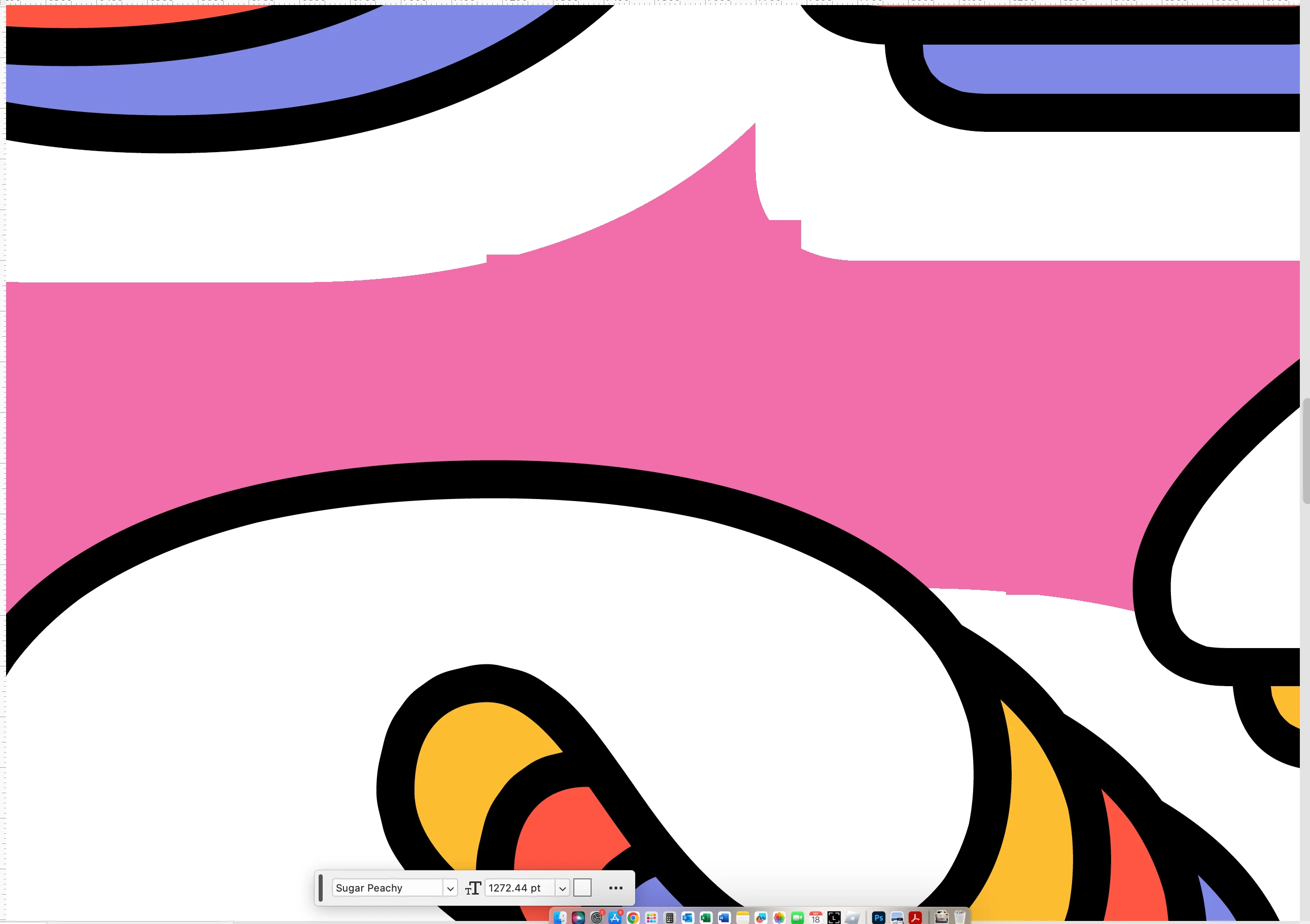

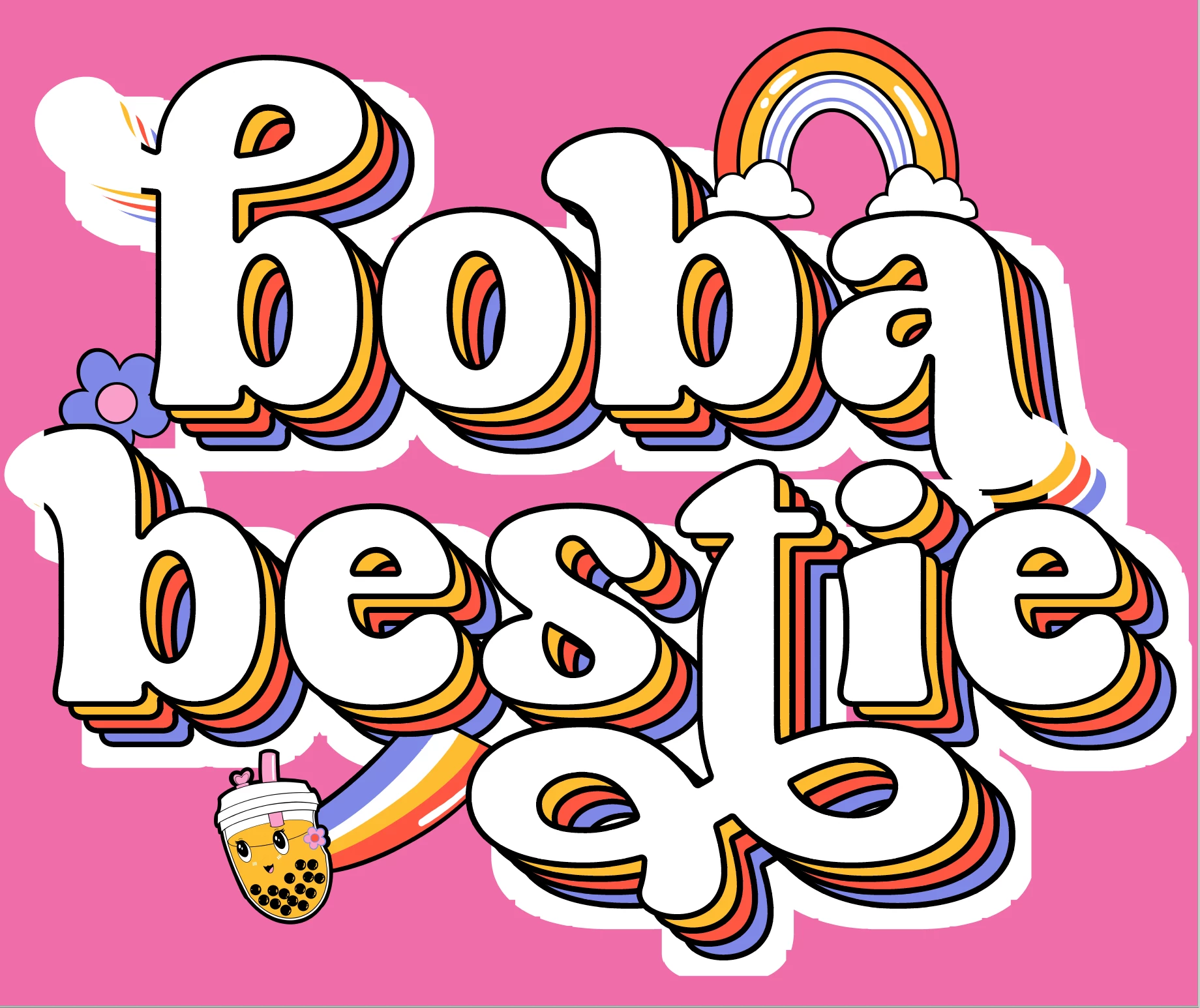

Hi there!  I am a super newbie self-taught Photoshop user, and need to send my logo file to a printer.  They require AI or PDF format, but i've been having troubles with my artwork.  My logo has several layers, and the one has a solid white outer glow (used as a thick border).  Whenever I've tried any of the below, I get the same issue of the solid white outer glow suddenly having jagged clipped edges.
Export as PNG
Save as TIFF
Export as PDF (does some other strange things)
Merge Layers
Turn into smart objects
Flatten Image
Rasterize Layers
Can someone please help?
What it's supposed to look like
*(I added the pink background to help show the white outer glow of the last layer)*
What it looks like when I do anything I mentioned.
What it looks like when I save as PDF

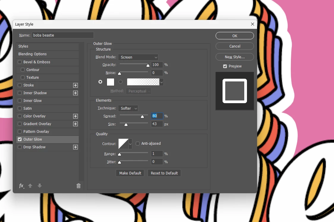

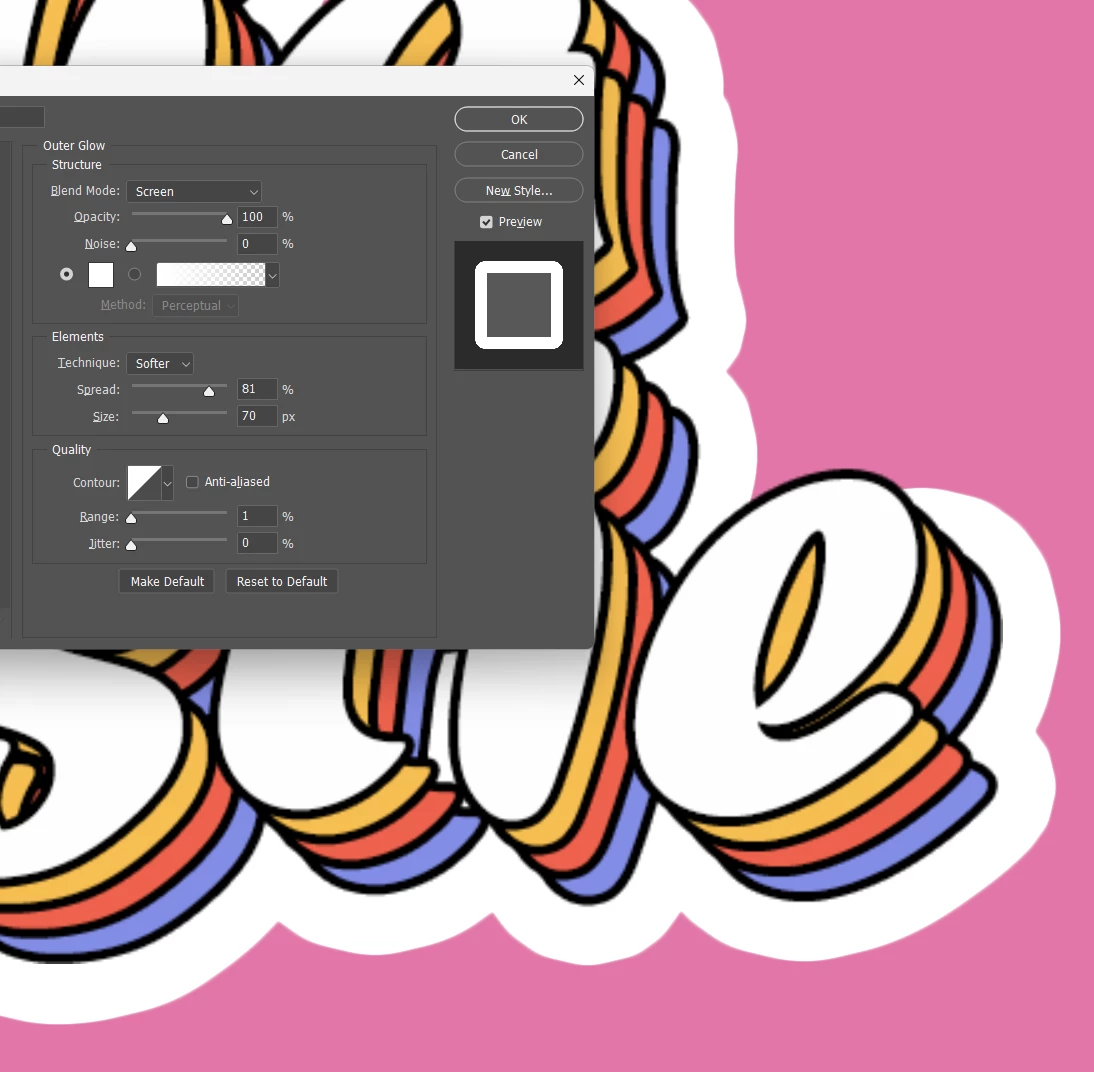

So it looks like it was there in the image, but not visible when zoomed out.  I'd be thinking about a different approach not using Layer Styles.  I didn't know that Outer Glow was prone to ragged edges at large values, but Stroke can be.
I've increased my logo size to 3000 pixels wide here with zoom set to 100% and it is starting to get a bit ragged.  In fact it looks like it could do with some anti aliassing to soften the outer edge.  We can do something about that.
I've reduced the Spread to 80% which has given us the AA we were looking for, but made the size a bit smaller.  Can we bring that back up without reintroducing the ragged edge.  I think we can.
There you go.  Size increased from 43 to 70. We have increased the border while maintaining the AA without a feathered edge.
I have always thought that Outer Glow was not an intuitive effect to use, and I can certainly remember floundering unable to make it do what I wanted.  So I hope this helps.

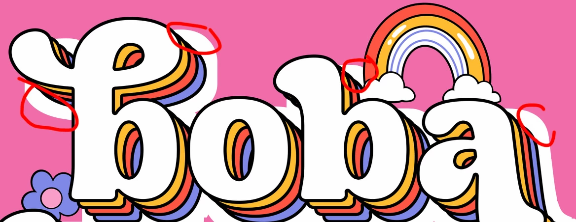

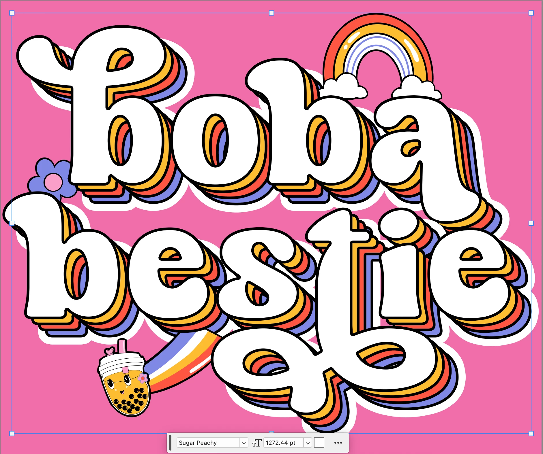

I have the solid white outer glow on just the last purple text layer, rather than around the entire word like in your example (so cool that you recreated that so fast by the way).  This is just a design preference.  And I like the solid, hard edge look instead of soft cloudy edges.  I always work in the "Fit on Screen" view mode, and my file is sizes 50x42".  Pretty large, but I print them on banners etc.  However in this particular need, i'm going to also print onto plastic cups at 3x2.5" as well.  Since you mentioned to view at 100%, I went ahead and did that and noticed that same jagged edge outline.  This is without me trying to convert anything.  I never noticed nor thought that it probably always appears this way, but for sure does not print jagged edge at 100% size on a banner.  Not sure what's going on here.
Viewing in "Fit on Screen" mode
Viewing in 100% mode.  This is the area above the "s" in "bestie".
Do you think it's just a matter of it viewing strangely on screen?  As I mentioned, I've never had print issues.  However, i've also never seen these jagged edges appear either.  And I still dont know why pdf doesnt convert properly.
