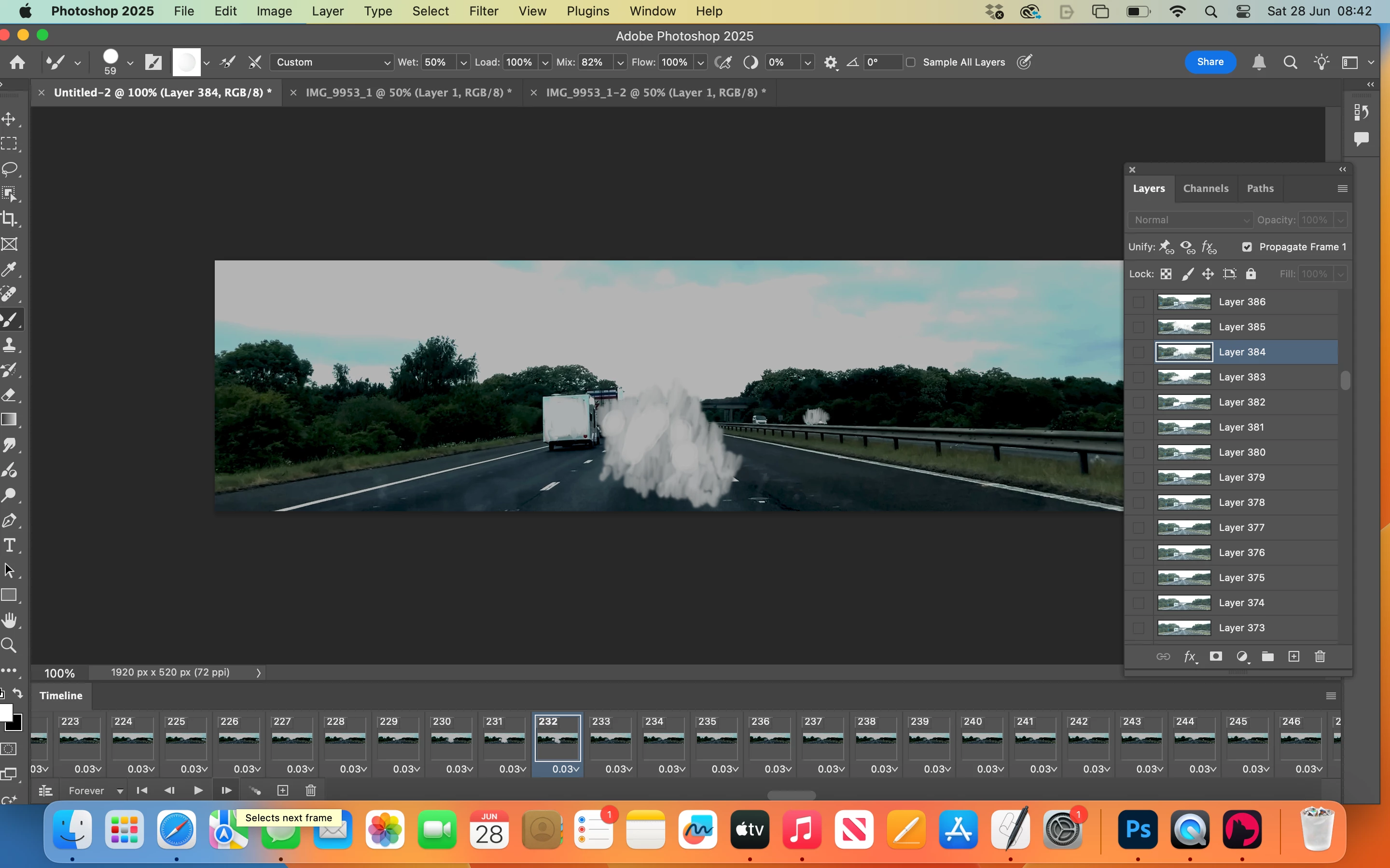

I've been making a timeline using the max of 500 layers.
I want to make a flickering light effect by duplicating a previous layer and adding a bit more onto it.
Because I can't see the previous layer (not sure how onion skinning works here) I'm having to guess/approximate what the previous layer looked like which makes it appear a little jerky.
Is it possible to onion skin the previous layer where I can then draw directly onto each individual layer?

Yes it is a video timeline.
It appears to be a Frame Animation, not a Timeline Animation.
As a work-around you could show the »previous« Layer and set the »current« Layer to 50% Fill.
That could be automated and triggered with a shortcut.
Thank you for this, with a bit of play, I think this method may work with what I'm trying to achieve. Always appreciate the help.

It sounds like this is a Video timeline?
[EDIT] as opposed to a Frame Animation.
Jun 28, 2025 7:47 AM UTC
Yes it is a video timeline. I'm wanting to make digital smudges that have a continuous 'look'. At the moment, I'm having to guess the previous layer which is OK but it would be good to have the option to see the previous layer.

Jun 28, 2025 9:38 AM UTC
quote
