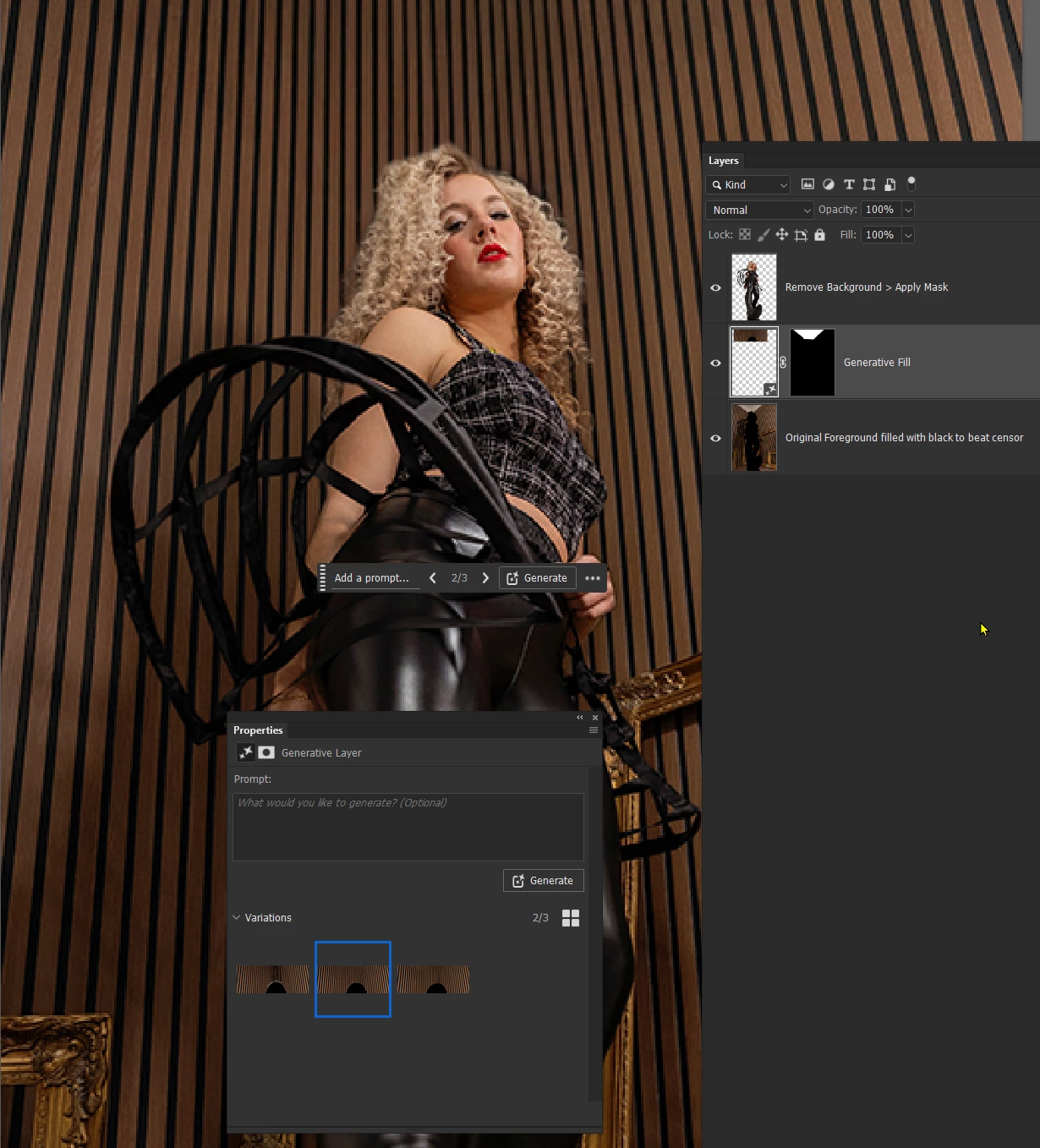

I needed the Gen Fill selection to overlap the model, so I copied the layer and used Remove Background, and then applied the mask leaving just the model.
Sure enough, when I used Gen Fill it decided that there was too much flesh, so Ctrl click the model cutout layer to load the selection , and fill that selection with black on background layer.
Use Gen Fill again — this time there is no flesh for it wory about, so it does what we need.
Turn the model cutout layer back on
Flatten layers > Job done

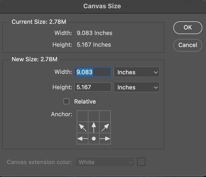

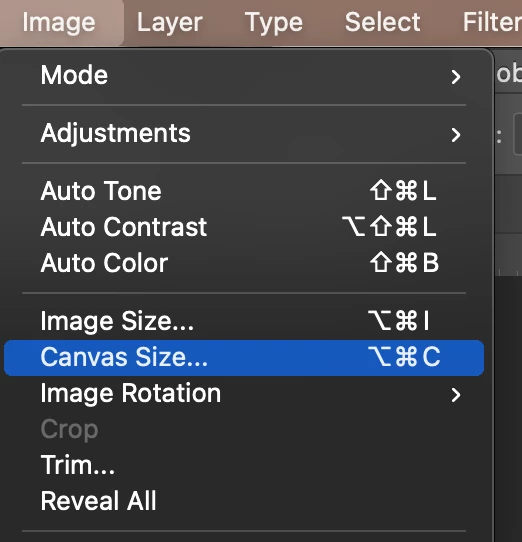

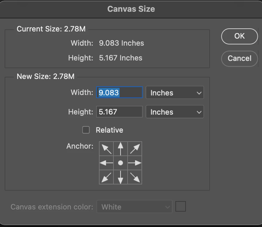

@jennifera82006732 to extend the background, your image needs more canvas space.
A pop-up dialog box will open.
So, if you want to add space to the top, then you need to anchor at the bottom as shown
If you want space all around, then you would anchor in the centre
Once you add the extra canvas to your image, you should be able to fill out the space nicely.

February 12, 2025
I know how to do that but I am trying to fill in the white wall/ceiling space with the striped background. I was able to do it on several pics but am having the hardest time with a few of them.
