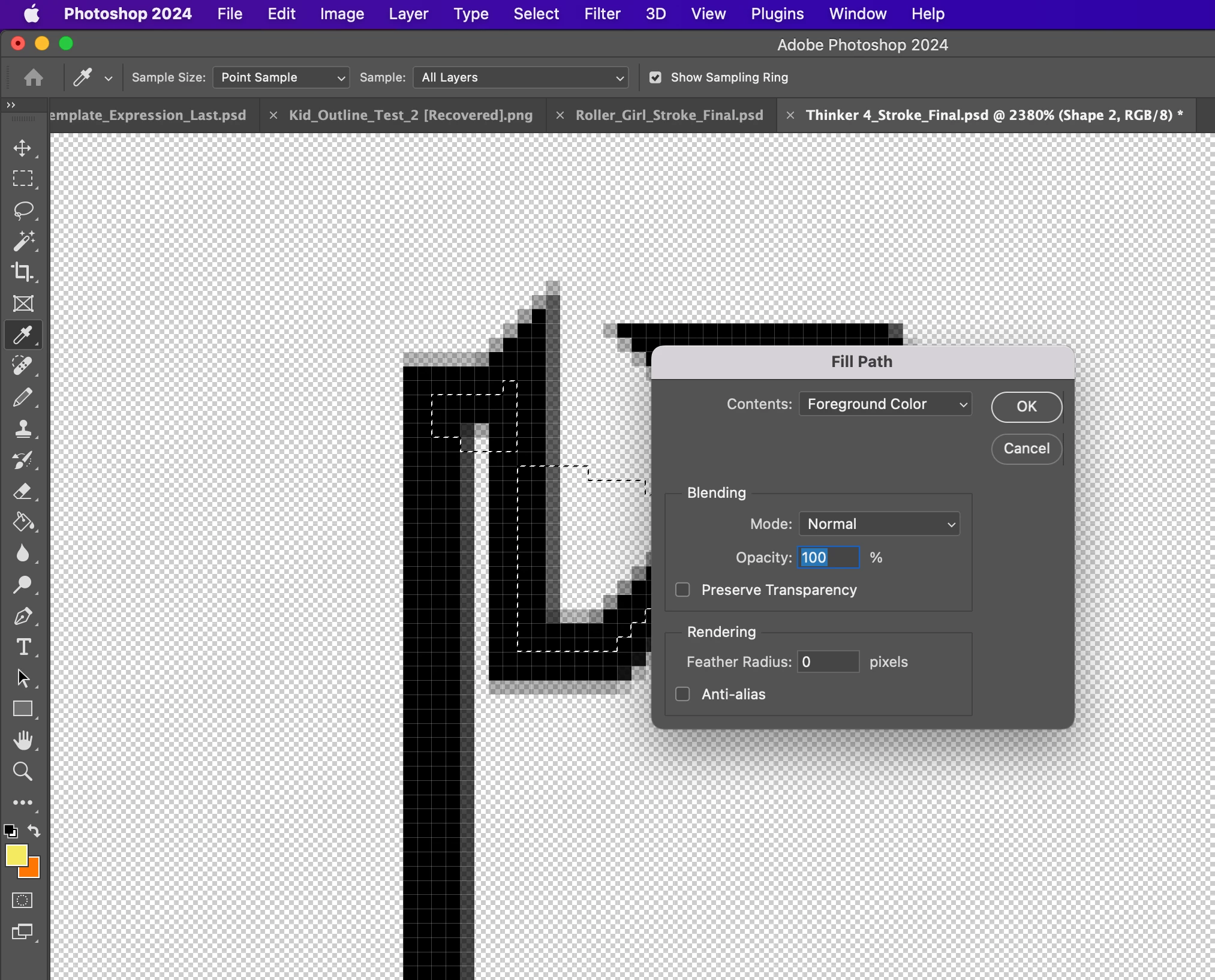

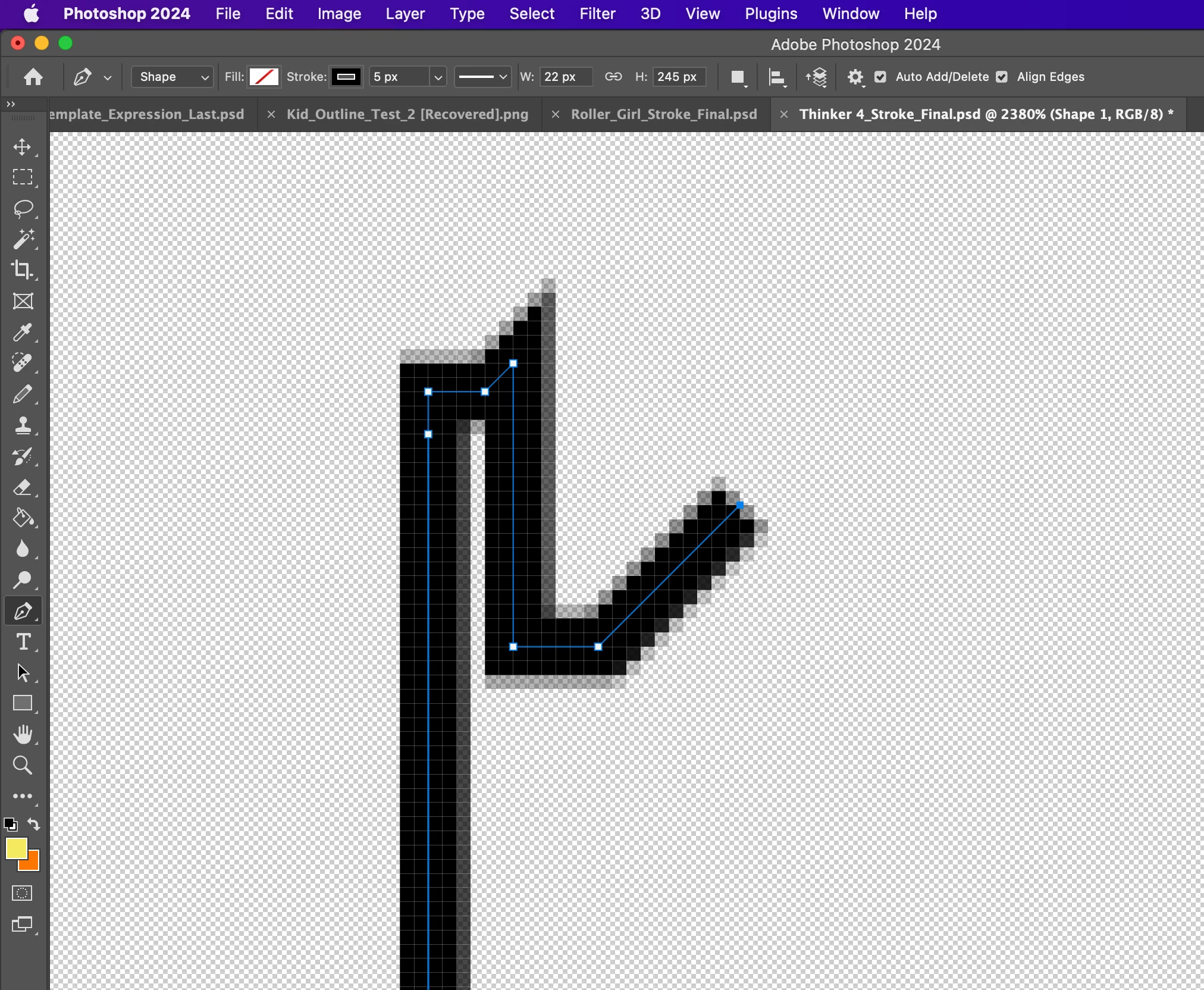

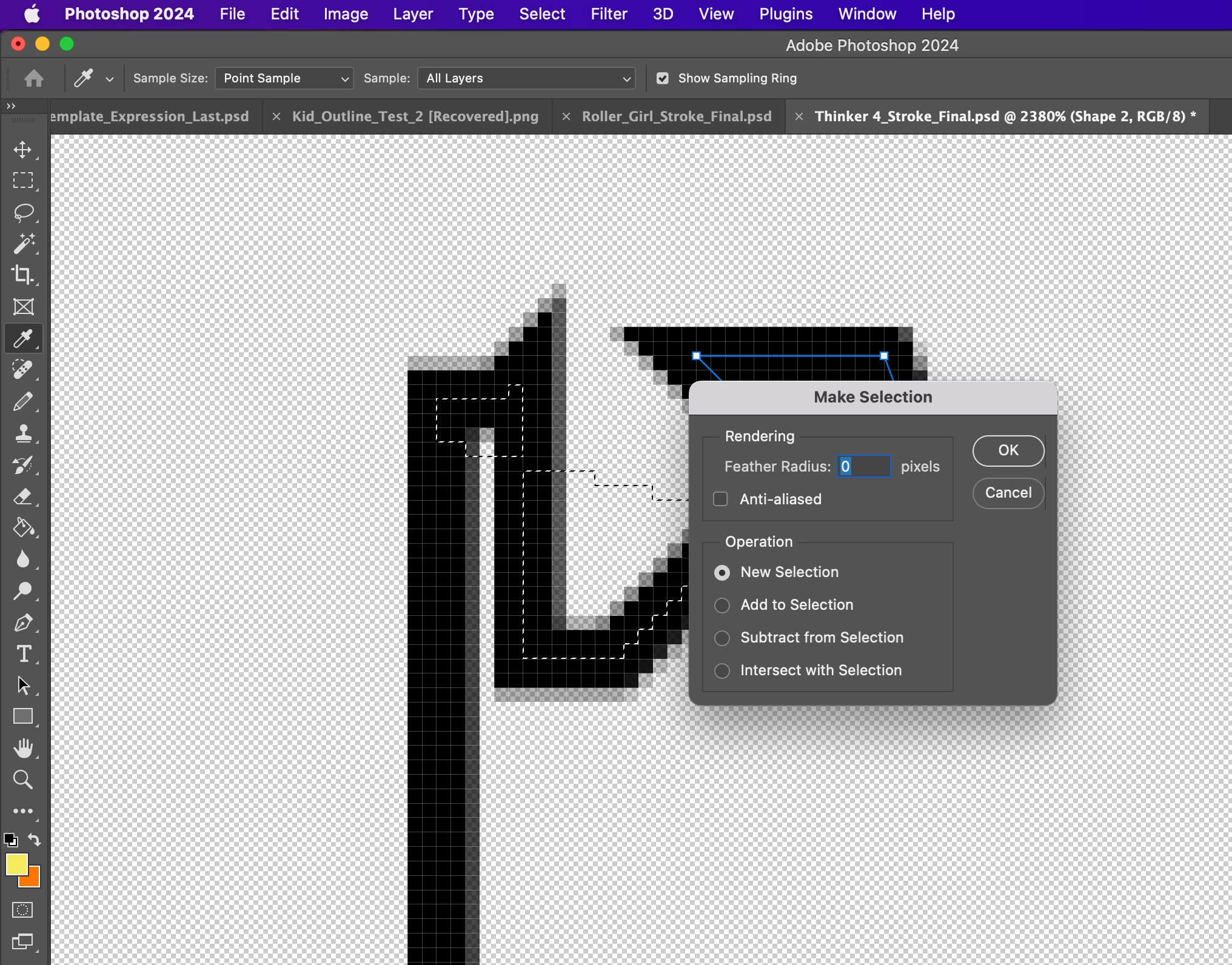

I have tried to turn off anti-alias for the pen tool but no matter what I do it doesnt work. Anti-alias is turned of for everything else but not when I create a stroke with the pen tool. I have removed anti alias on both make selection and fill path. Plese see attached. Its making me CRAZY!! 🙂
Thanks in advance!
/Dejan

What is the end goal with the path? You have the option set to shape. You can switch to path - which is independent of a layer. You can then choose to fill the path or add a stroke later.

November 13, 2023
What you are seeing is the Stroke of a Shape layer. What you want is a garden variety Work Path
The Stroke and Fill of Shape layers is different from the menu commands of the same names. Shape layers are  rendered at the time of display, while the menu commands directly alter the image itself.

I dont quite follow regarding the "garden variety Work Path" ? Do I just choose Path instead of shape in the options menue on top? When I do so I cant choose color of the stroke (or can I). With Shape I can choose any color I want on the Now I need to define pixels of the path and fill it with the paint bucket. It begins as anti aliased here as well but after a few fills I manage to get fully filled pixels so this method works but its a process and i dont have full control since the paint bucket paints a couple of pixels outside of the path (even if anti alias is turned off).
Sorry for all stupid questions...
/Dejan

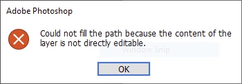

You need to be on a pixel layer to fill and stroke via the menu commands. If you run them on a Shape layer, you see this:
You set the color with the current foreground or background colors when you run the command on an ordinary layer with an active Path. Unlike Shapes, the changes are pemanent, not editable. Shapes seem to always have anti-aliasing, but they remain editable.

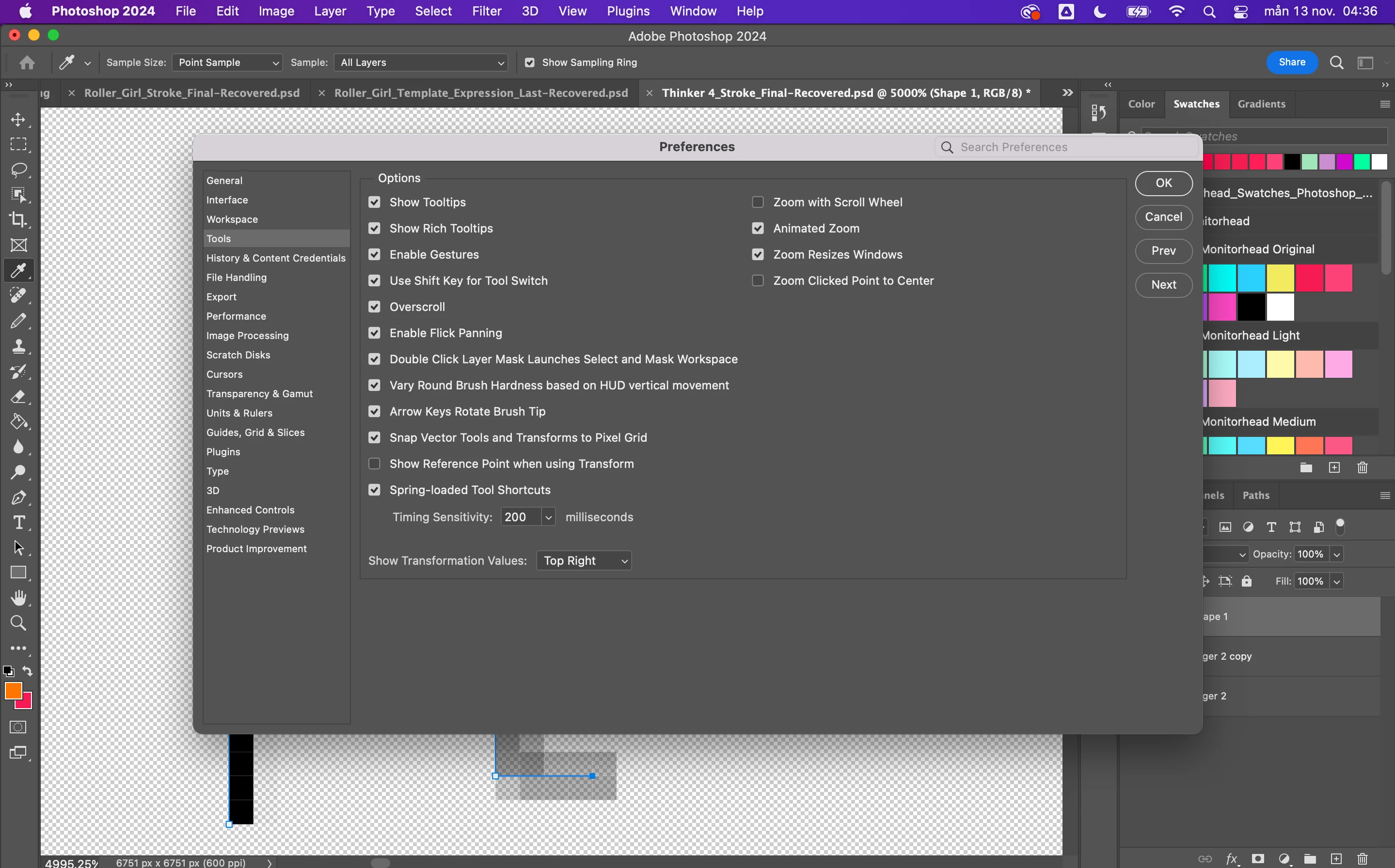

In Edit > Preferences > Tools, make sure the 'Snap Vector Tools and Transforms to Pixel Grid' box is checked.
November 13, 2023
Thanks but that seems not to be the issue since it was already checked 🙂

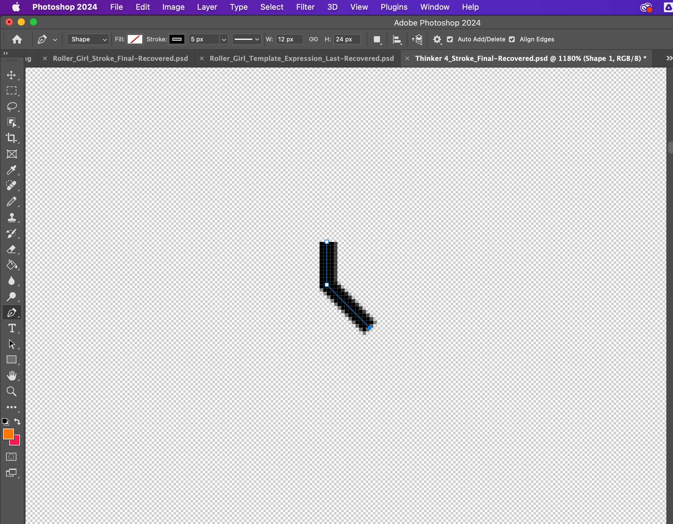

November 13, 2023
The line is perfect as long as it is the first line drawn and it is straight. The minute it changes direction it gets anti-aliased. Maybe this is some sort of clue 🙂
