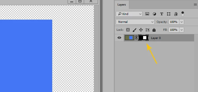

Jan 21, 2018 5:21 PM UTC
Exactly how is it transparent? Can you show a screenshot of the Layers panel?
Try Layer > Layer Mask > From Transparency. Then shift-click the mask icon to disable it:
mtrulyAuthor
Jan 21, 2018 6:53 PM UTC
Thanks for the ideas!
You can see the checkerboard displayed rather than the actual background.  I want to see the object and the actual background... not the checkerboard.
Here is a screengrab of the layers dialog:
'From Transparency' is not available in the Layer Mask menu on PS CS4.
Thanks again.
Mike
D Fosse
Jan 21, 2018 7:00 PM UTC
No, CS4 didn't have this. It came in a later version, but can't recall which.
