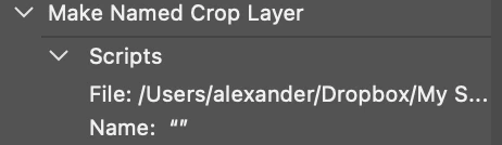

I have a lot of photoshop actions that run javascript files. They all still run fine in 25.7 but I'm unable to record any new ones. If I record a new one and attempt to run it I get an error "Could not complete the command because Photoshop was unable to find the JavaScript file."
When I twirl open the details on the "Scripts" action step, it has the correct "File: path/to/file" but unlike in older actions I've recorded there is now a Name:"" (empty quotes). I'm assuming this is what's causing the problem.

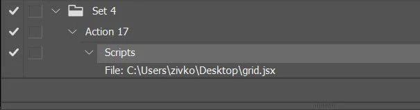

It appears to be a Mac-specific issue. I just tested it, and everything functions correctly on Windows; the script name is recorded as part of the action step and will call the appropriate script upon execution.

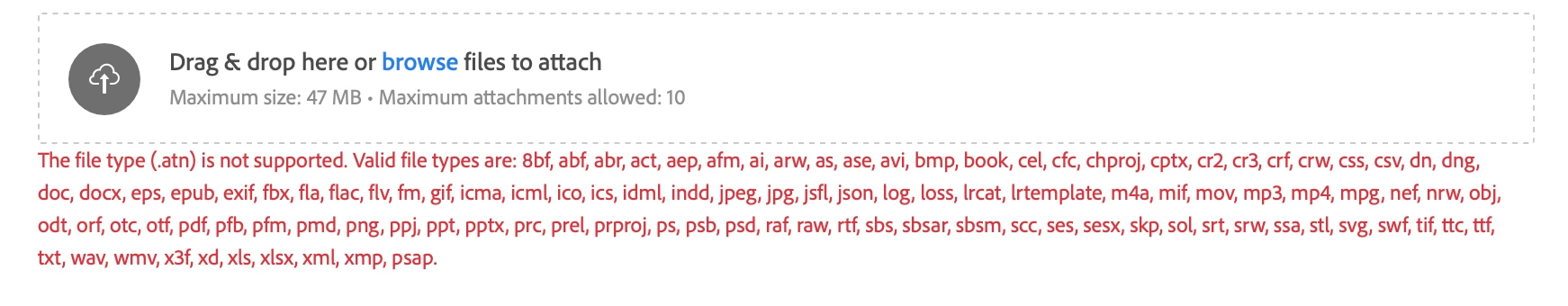

Hi Stephen, I tried to attach one but ironically adobe doesn't allow .atn files to be attached, despite having a rather impressive list of other files that can be..
Attaching a screenshot of it the actions panel in the meanwhile.
