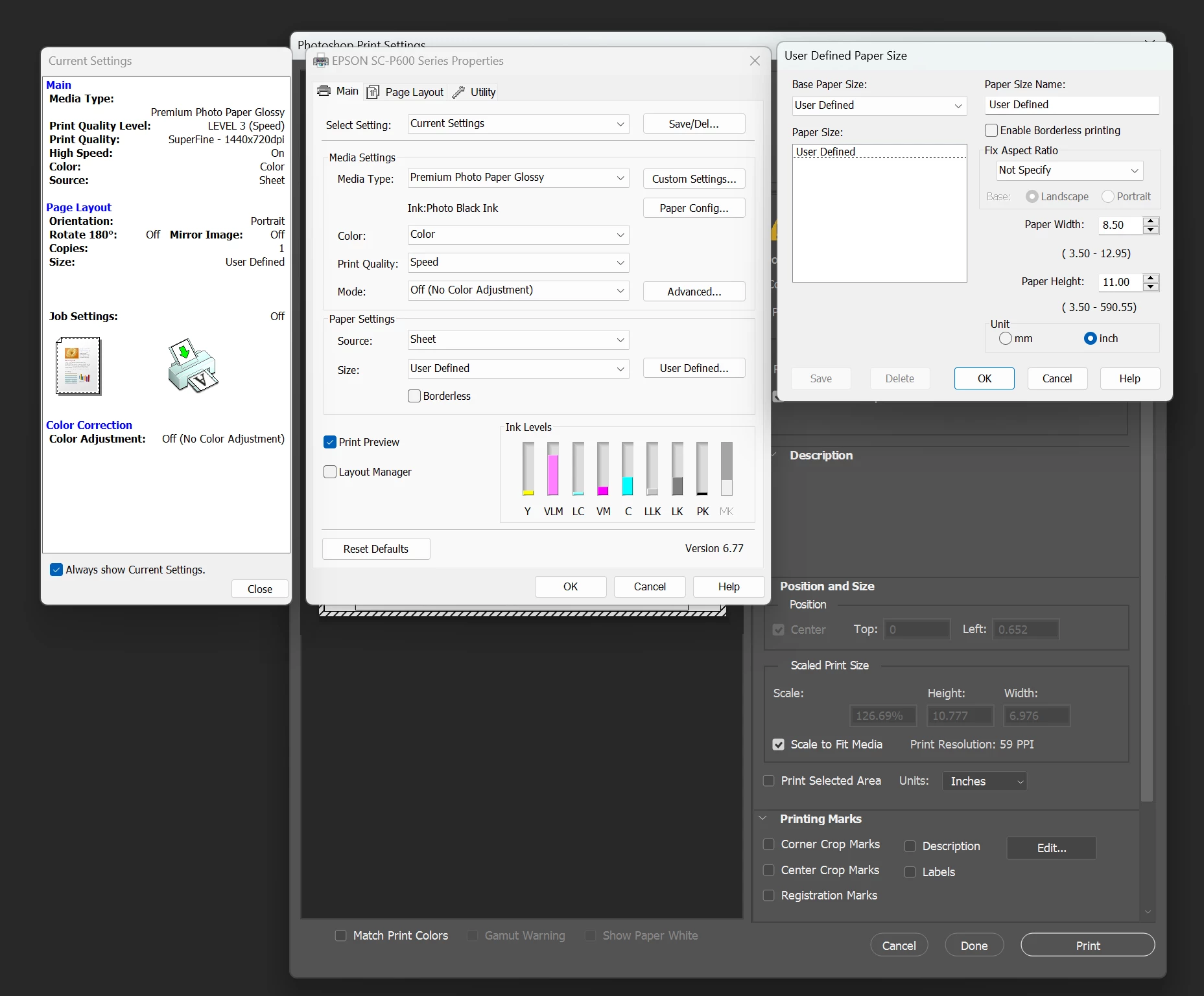

I have done that a thousand times and each time it revert to 8.5 x 11.
my printer Epson P600

@marc28270747vqnp None of those settings are Photoshop settings. They are all settings within the Epson printer driver.
If you want a different paper size, define a new one and give it a name (in the right hand panel). Then go back to the centre panel in your screenshot and select that newly named size under Size. Finally go to the top and Save the setting  with a new name.
On my SCP5000 which has the same driver, I have several settings saved under 'Select Setting' they set the media type, quality etc Then under paper size I have several settings saved which I can use for the common sizes I use for printing. Selecting one of those feeds back the selected paper size to Photoshop's print dialogue.
Current settings is just that and can change if you use the printer from another application, however changing them back is as simple as selecting the named set of settings you created above.

The problem: I have created a "user defined" profile for my 5.5 x 8.5 paper but the system does not save it. It reverst atuomatically to the 8.5 x 11 and my saved one is gone.
