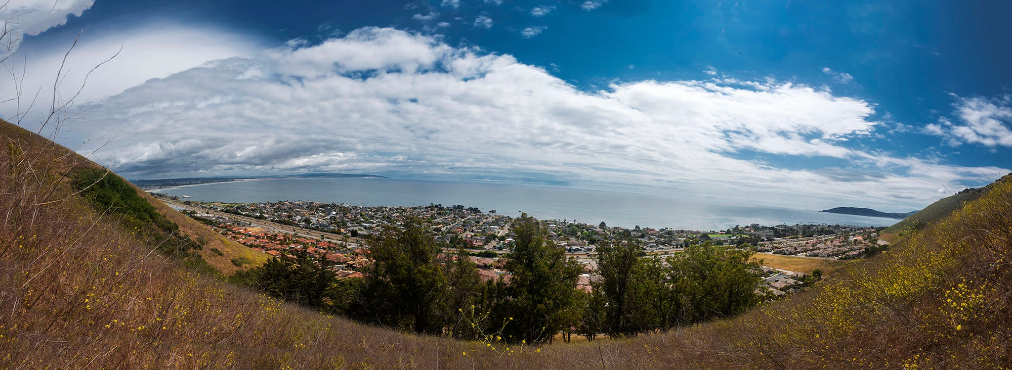

imagexREK
October 14, 2019
unwarp horizon
I have stitched a panorama which has a warped horizon.  The horizon is generally a downward arc, but with upward bends at both ends.  Is there a way I can define the horizon as a series of straight line segments then have Photoshop warp the image so the segments line up as a continuous straight line?

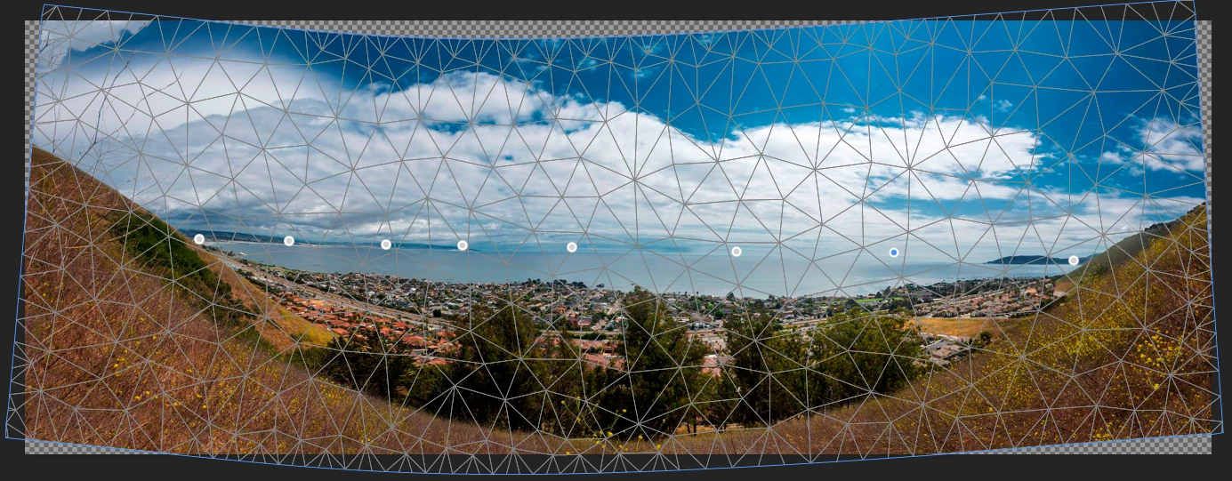

Kevin Stohlmeyer
Kevin StohlmeyerCorrect answer
October 16, 2019
Have you tried using Puppet Warp in the Edit Menu? Convert your layers to one smart object and add pins to the horizon. Then move. Not perfect but better with practice.

imagexREK
imagexREKAuthor
October 16, 2019
Thanks for the suggestions on how to shoot better photos for producing panoramas. But that's not what I'm looking for. I now have a stitched panorama with a problem - warped horizon. I'd like suggestions on how I can fix this photo, not avoid the problem in the future. Chuck Uebele suggested warping the photo, but I'm not clear on what Photoshop tool he used and how he pushed the photo for aligning the horizon. It seems to me that there should be a way to draw a series of connected straight line segments then have the photo warped to align the segments into one continuous straight line. I haven't been able to dupe this out, but I'm not familiar with warping in Photoshop and I haven't found applicable help in the precast manuals or tutorials. Perhaps it can't be done.

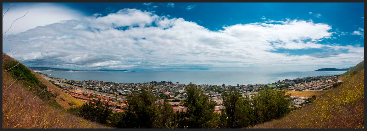

Chuck Uebele
October 14, 2019
kevin, I've had the same issue and neither option works. Here's a sample of what I was trying to correct. Notice how the horison is "S" shaped. I ended up just using warp and nudging everything - PIA!
