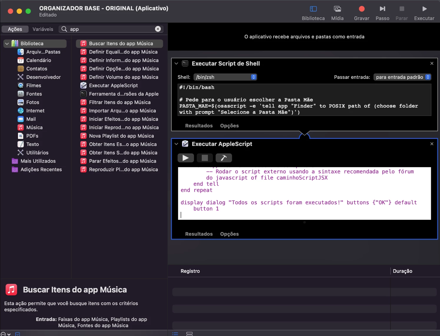

Its for my work, in the office we aalready use automator to organize our files, like making copies, renaming, but now we need to use photoshop through automator, I tried my best to find a way to photoshop runs this script, but nothing seams to work; but when i runs through file>scripts>browse there is nothing wrong with the script:
At first I tried to add to my script for automator "shell", that works perfectly, but when it comes to the part that activates the photoshop and runs the .jsx script nothing happens;
here is some of my trials

this was the test that i tried to add the photoshop part to the old script in the automator;
# NOVO PASSO: Executa script no Photoshop
osascript <<EOF
tell application "Adobe Photoshop 2025"
activate
do javascript file "/Usuários/tratamento/Documentos/Scripts Finais/Mesclagem de arquivos interno.JSX"
end tell
EOF
