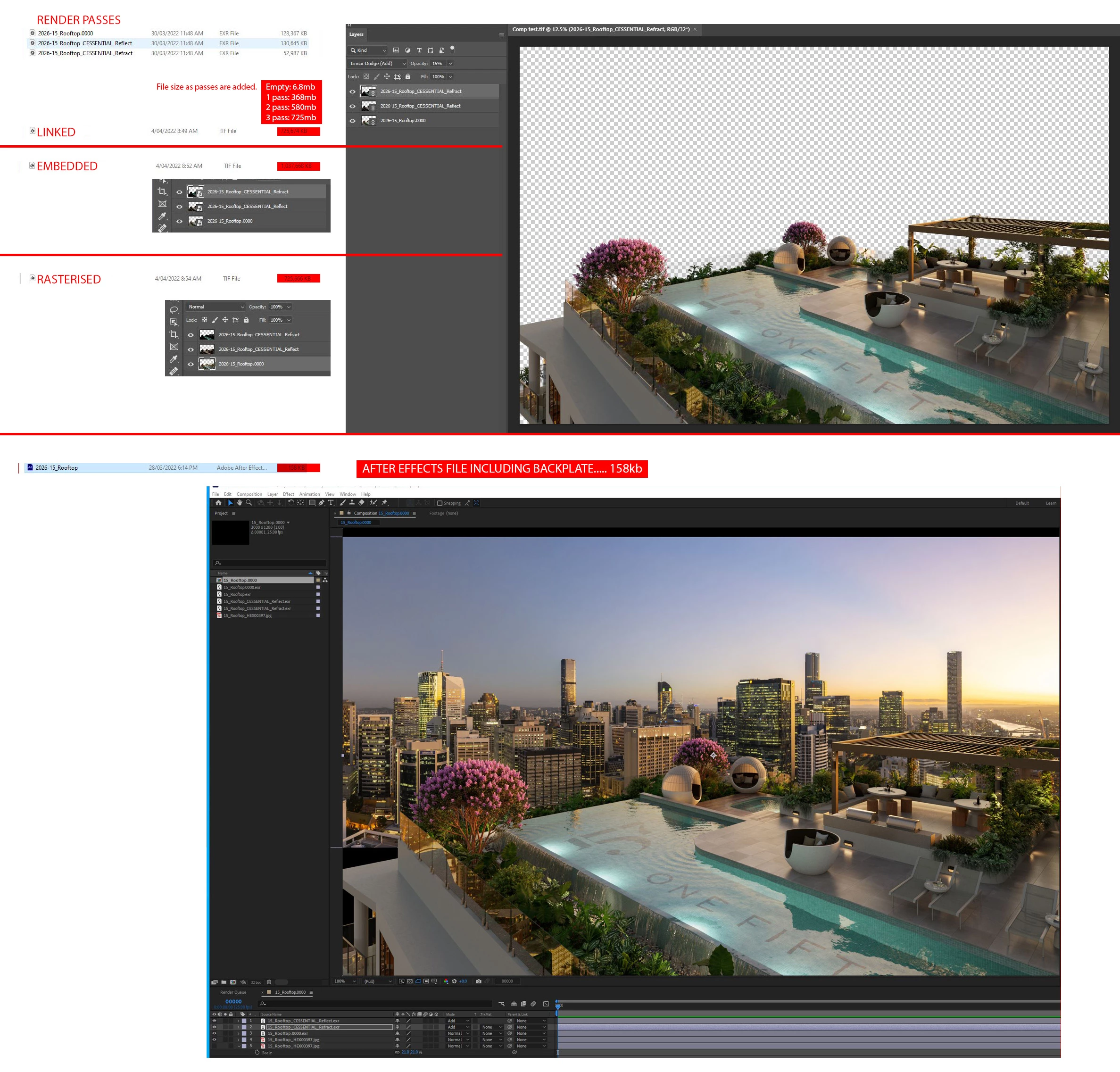

Thanks for the suggestion Bojan. I hae reset my preferences (on reflection, i should have saved my preferences first :))
Attached shows a comparison of linked vs embedded vs rasterised.
Unfortunately the results have reinforced my thoughts about grading in photoshop.
You will notice that the linked file is now smaller than the embedded layers, (so resetting preferences loooks like it has fixed a few bugs).....  however if you consider that the empty file is 6.8mB and the file with LINKED layers has ballooned to 725mb, it is absurd when you consider that the layers are basically proxies??
Also note... the file with 'rasterised layers' is exactly the same file size as the linked??? no logic to me.
Anyway, for comparison, I have attached the after effects file showing th 3 passes INCLUDING the backplate. The file size is only 158kb!!!
Until photoshop make a determined effort to resolve and optimise this technique.... i will have to return to my old method of compositing in After effects. Its a shame, as it is much easier to refine a grade in photoshop. Very disappointing.
Unless someone can prove me wrong, i can only assume that this case is closed.... Big FAIL

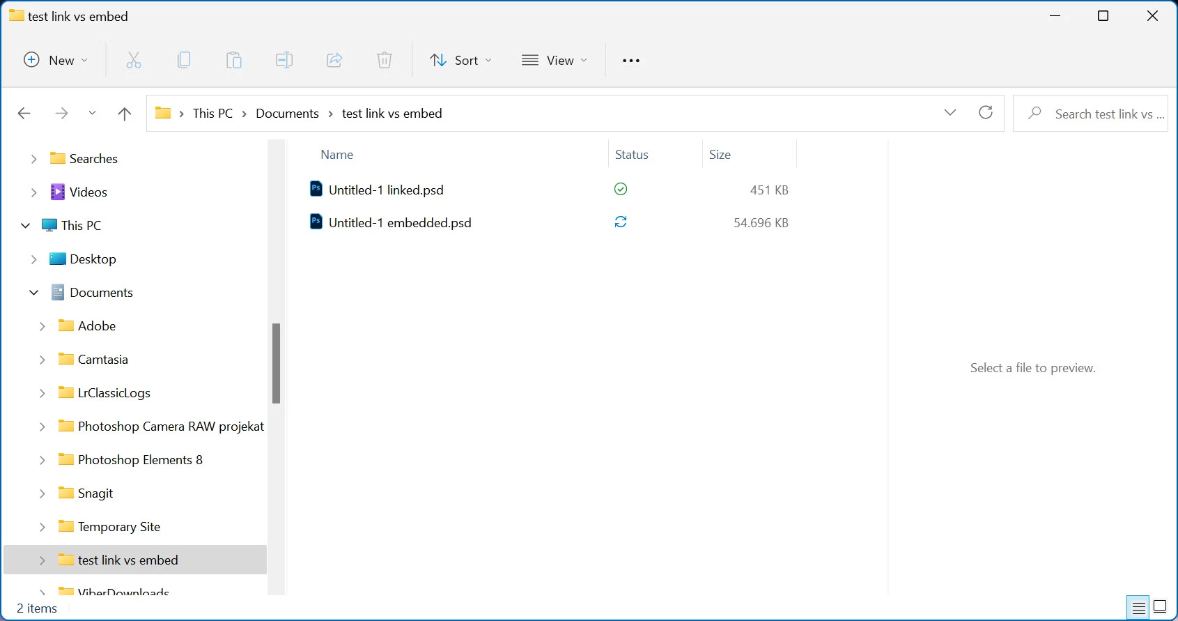

Please try with reset preferences because this behavior is weird Preferences in Photoshop (adobe.com)
Here is result of my testing. I am placing huge file into small document.

"Photoshop on the other hand, when i 'place-link' a file as a smart object, it seems to embed the image into the image rather than simply reference it??"
Place linked should work as desired: create layer from file but do not embed original file. Place Embedded is embeding original file.
I am testing on my machine and things work as expected. File with embeded image is larger then file with the same image placed as linked.
Which version of Photoshop you are using? Have you tested weight when saved embeded vs linked?
