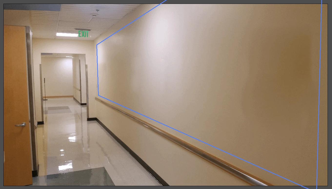

In this project, I am mocking up some new artwork onto one of our walls. Here is the image along with the blue-grid vanishing point buildout:

  3. Now I formally enter vanishing point mode; the blue grid above is, by default, selected
  4. I CTRL-V to paste my artwork from the clipboard. Instead of pasting, I see this:
Big, fat nothing. After that nothing happens, the info panel at the top reads: "Click+drag in a plane to select an area on that plane. Alt+drag a selection to copy an area to a new destination. Ctrl+drag a selection to fill the area with the source image." Try as I click, I can't put anything there. I have tried a number of different types of artwork.

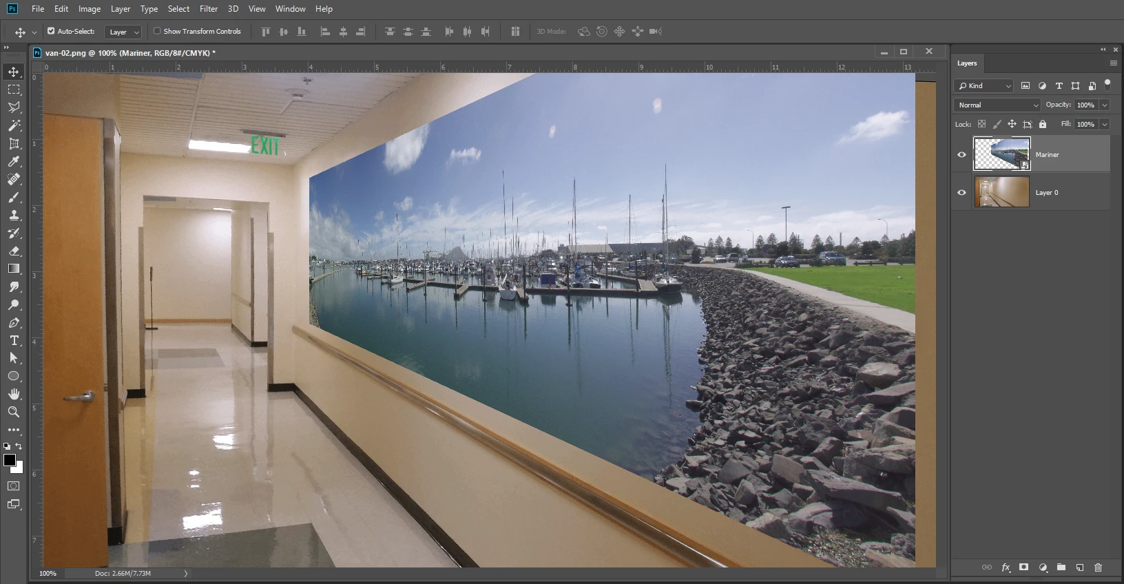

I posted that back in May. I am happy to report that I resolved my Vanishing Point problems. In fact, I dove in and decided to understand as much as I could about the thing. And a few weeks after this issue was resolved I started working on a video. It ate a lot of free time...for the next five months. Anyway, here it is:
I would, of course, love any constructive criticism anyone has. Especially if they can better elucidate a point or, even better, correct an error. Thanks for the input!
