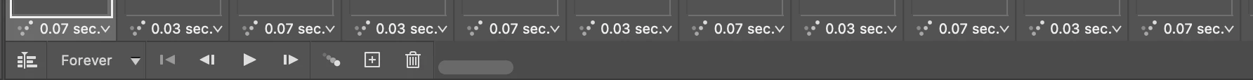

Issue
  • Photoshop version: 26.4.1
  • OS: Sequia 15.3.1
Steps to reproduce:
  1. Create a gif using the video timeline mode (30 fps). In my case, I typically use Import > Video Frames to Layers, but the same exact thing happens when I import images to layers and create a video timeline from it.
  2. Change nothing for timeline speed (leave at default).
  3. Export this gif using the Save for Web (legacy). Options chosen don't appear to matter here.
  4. Reopen exported gif in Photoshop
  5. Frame delay from exported gif using the video timeline switches between 0.03 and 0.07 seconds
  6. Open gif in browser - gif looks very choppy due to inconsistent frame rate.
Expected result
Frame delay from exported gifs made with Video Timeline mode should retain 0.05 FPS when re-opening in Photoshop.
Actual result
Frame delay is 0.03 and 0.07 alternating. Gif looks choppy when playing. Gif must be reimported into Photoshop, manually changed to frame delay of 0.05, then re-exported.
Appears this has been an issue for a long time.

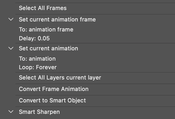

m73531472
m73531472Author
April 16, 2025
@Claire H.hi Claire, thanks for your help. I've updated my computer and photoshop and tried with step 2. I realized while doing some testing that I convert the frame animation to 0.05 seconds before converting to a video timeline. This seems to be the crux of the issue. When I don't, the export works fine, in that the frames prior to turning into a video timeline were 0.03, converted, then exported still remain at 0.03.
I'm attaching my workflow below
I guess I would expect that the 30fps is honored from the video timeline but that's not what eventually ends up exporting. If I don't touch frame delay before converting to video timeline, it seems to work as expected. Otherwise, with 0.05 -> convert to video timeline -> export then reopen, then I seem to get the 0.03 and 0.07 oscillating frame rates.
