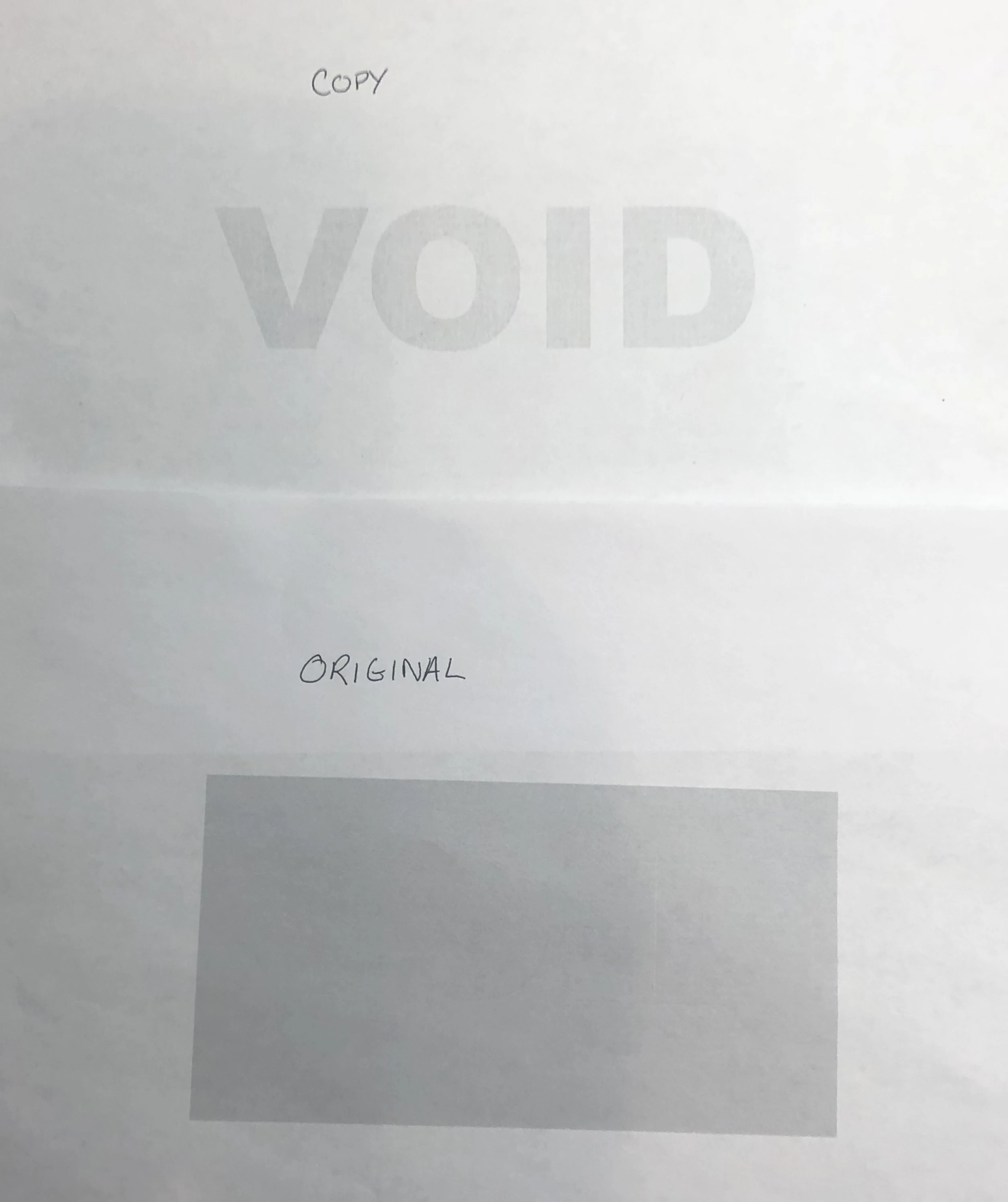

Jake Stanfield
Dec 12, 2019 7:50 PM UTC
Stephen-
The file you provided is INCREDIBLE! I printed the file out on our color laser printer (Phaser 7800) as-is and it didn't work very well (I didn't read/do what you instructed) as the grey box and VOID both printed although the text was just slightly visible against the background. I put the print on the copier and the text did pop out a little more. So it KIND OF worked. I then studied the file and thought maybe if I connected the end points of the lines to the dots with the brush tool it would prevent the text from being visible at all on the original, but even with it set to 100% hard edge there was some blur to the brush. So I converted it to bitmap 1200 dpi / 50% threashold and then connected the ends of the lines to the dots adjacent to them (no brush blur). I printed it out and all I got was a grey box, couldn't see anything else. Put it on the copier....BAM!!! No grey box, just "VOID" appearing on the paper!!! WOW!!! JUST WOW! Thank you so much!
Grateful for your help friend!
