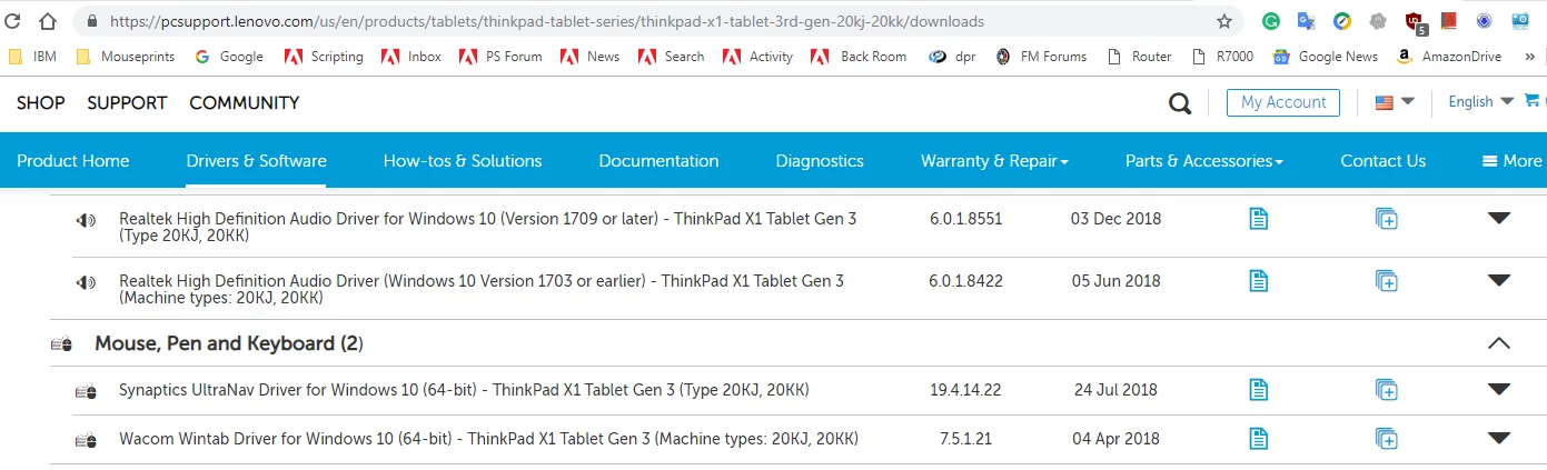

Did you install lenove WinTab device driver for its active Pen?
