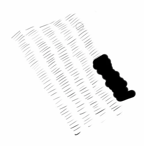

Whilst drawing in either photshop or SAI, the pen pressure sensitivity would just randomly fail and draw solid thick lines as if drawn with the mouse.
See image:
What I also learned, is that once the pressure sensitivity falls out, it doesnt recover until I lift the pen away from the tablet, and then back again, as seen in the following pic:
Sometimes it would fail on the 2nd brush stroke, others on the 100th. It's completely random.

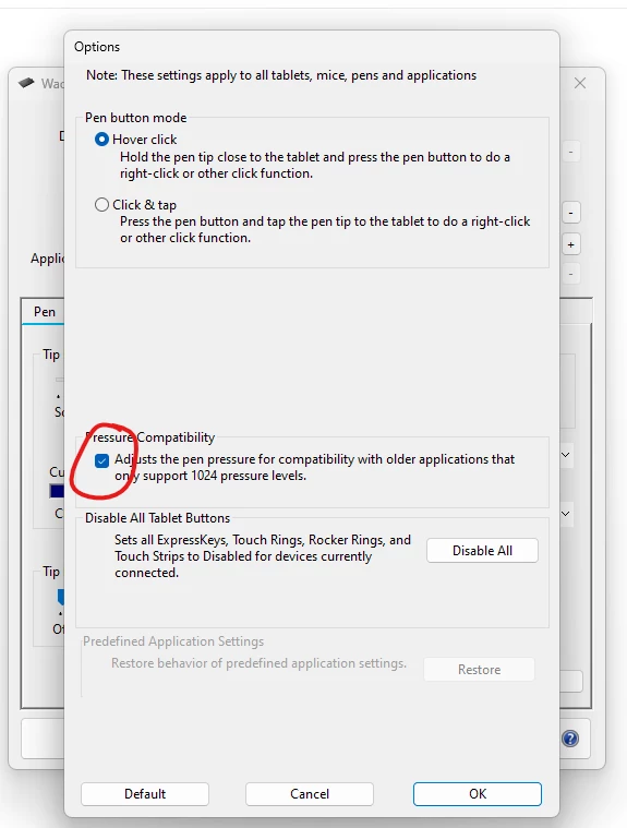

    Hello.
    I had tried many things and seems like turning on the option in the attached image will do the tricks. It solved my problem.

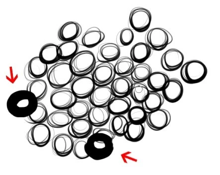

    I have never had problems in Photoshop.  Sometimes in Illustrator I end up with a circle at the of a line.  When it happens I usually redraw the line.

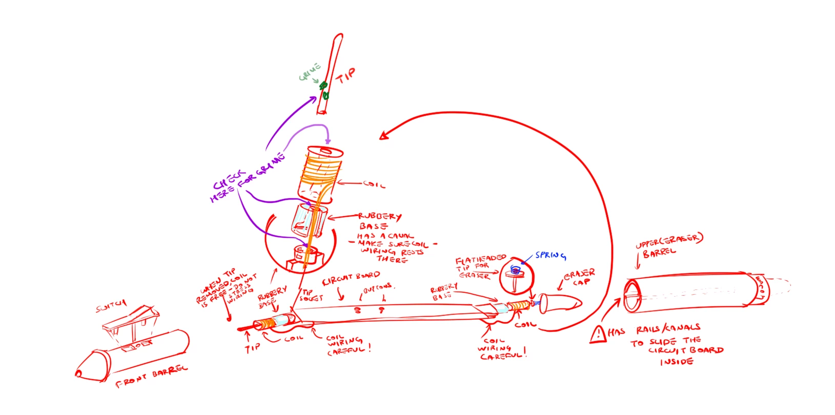

    while it's an old thread, I'm also posting a solution regarding something that @beckyds' mentions: the tablet registering clicks, even when the stylus is not in contact with the tablet. This could be a hardware related issue:
    Sometimes grime gets stuck inside the tip canal and the switch doesn't read values properly (becomes sticky). I would start by removing the tip (it's replaceable after all) and try refitting it. Perhaps even blow some air in the canal hoping to remove any dust particle stuck there.
    warning: proceed at your own peril
    if this is no software issue, and if you are desperate enough (and don't mind the chance of permanently ruining your pen) you may try disassembling the stylus. It's not very difficult - part of the teardown can be seen in the following video (https://www.youtube.com/watch?v=LnhEqRj3YA0)
    I've made a rough sketch of the various parts that can be removed, and what to be careful about when pulling them apart and putting them back together.
    The stylus in the picture is an intuos4 grip pen - but it's similar in other styluses.
    A small correction on the image above: the spring, underneath the eraser cap, is actually, two small springs, one inside the other.
    - here's a quick walkthrough:
    a) remove the grip
    b) pull and remove the side-button/switch
    c1)pull the lower part of the barrel (to expose the front tip mechanism) or/and
    c2)pull the upper part of the barrel (to expose the eraser mechanism) in this case, be careful: there are some very small springs that may easily get lost
    it will slide and the internal mechanism (circuit board) will be exposed
    d)remove the tip you wish to clean (carefully not to stress the coil)
    e)now that the tip is removed, set the coil aside (it's still wired on the circuit board, don't stress it)
    f) remove the rubbery base from it's socket
    g) remove any particles/grime from the tip, the coil's inner canal, the rubbery base's canal, and the socket's canal.
    h) put everything back together.
    - make sure the wiring of the coil, is not loose, but placed in the surface canal of the rubbery base so that the wiring doesn't rub against the barrel when you put it back on.
    - Also when putting the upper barrel (eraser's barrel) make sure it's aligned properly; there are some dents in the barrel that will allow the circuit board to fit right in.
    Hope this is of use to somebody

    Kal, I am on my third Wacom pen going back about eighteen years.  Actually it's four pens because I gave my original Graphire away with a still working pen, but I have had two pens die on me since I moved to an Intuos 4.  I also own a Cintiq Companion 2, but I very rarely use it, preferring the Intuos.
    Your pen assembly diagram is interesting, and nicely done.  Have a look at Google SketchUp with is free (SketchUp Make is free — SketchUp Pro isn't).  It's easy to use, and there are tons of nice video tutorials for it, and you could make a very nice 3D drawing of the pen.
    In fact there is bound to be one ready made in the 3D Warehouse, but it won't be a detailed exploded diagram like yours.  Here you go.  I enjoy SketchUp almost as much as Photoshop.

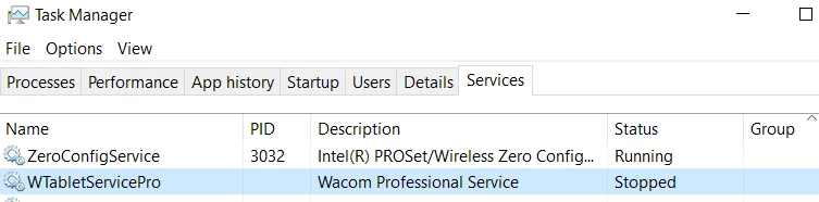

    Here's a Solution for Wacom touch and pen users who are having trouble with the opacity in Photoshop cs6.
    Here's the problem
    When drawing in photoshop your pen/tab seems to not be able to put full opacity even though the opacity is completely toggled up
    This is a simple fix and has nothing to do with the nibs, or driver or even the tablet itself. For some reason Wacom and CS6 do not coincide well.
    Simply go into task Manger and go to services then find a service (should be at the top) called WTabletServicePro and right click then tell the service to stop.
    This should fix the error, just go into PSD and test it. I worked for me so it might for you.
