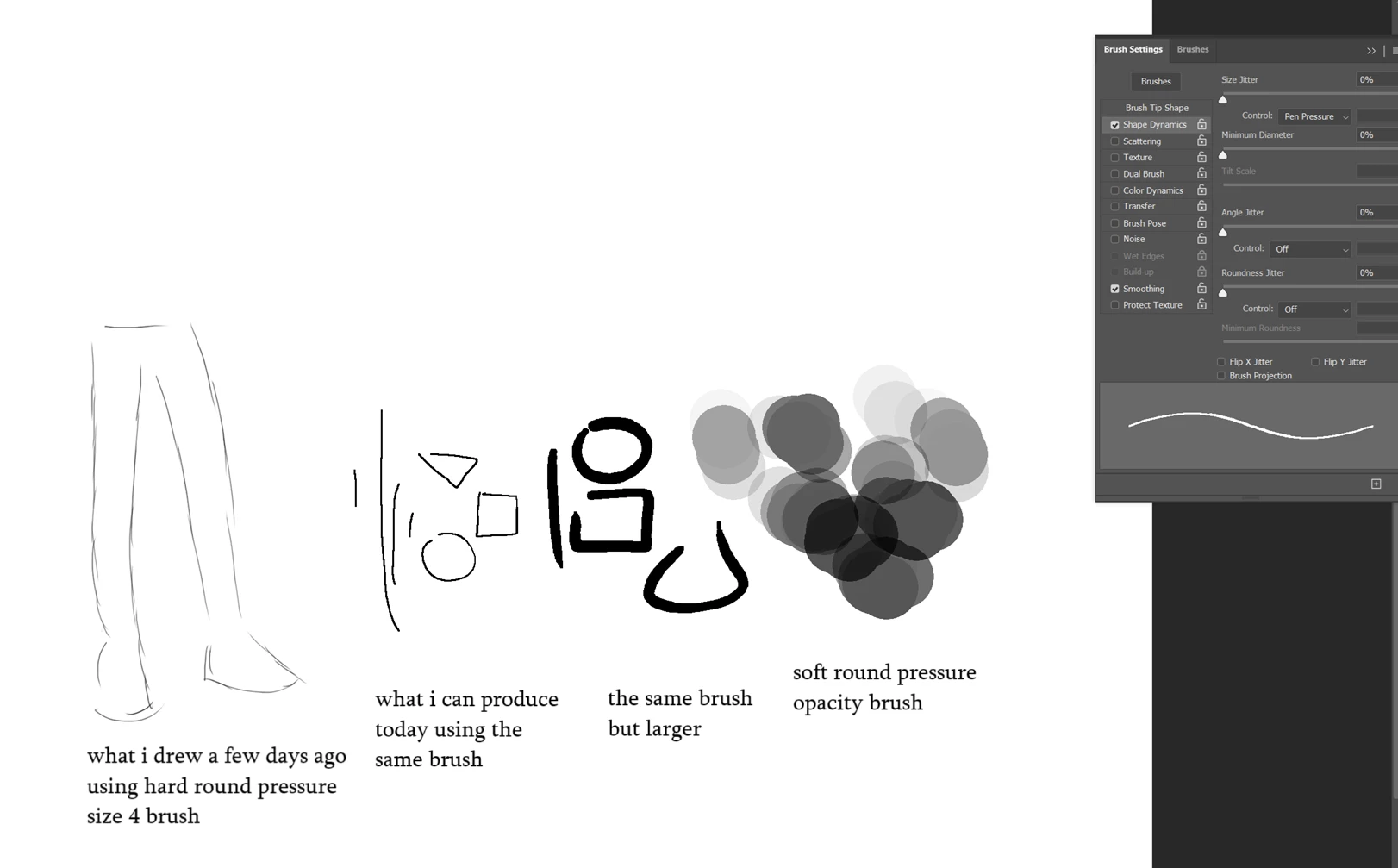

I use a Wacom Intuos Pro and Photoshop 2025 on Windows 11 to draw. Everything was working fine until two days ago when the pen pressure suddenly stopped working. However it hasn't stopped working entirely - instead it acts strangely. Photoshop seems to be able to detect pen pressure and manifest it when the brush is large, but when the brush is small it's like one size only and looks very aliased. I have a recorded a video of what I mean: https://imgur.com/a/769iT8u
In the video, on the left you can see a pair of legs I drew days ago with a size 4 hard round pressure size brush. You can see that the lines are soft and feathery. At the start of the video, I attempt to make the same kind of lines using the exact same size 4 hard round pressure size brush. You can see these lines are blunt and don't seem to be able to get very small.
Also, when I switch to the soft round pressure opacity brush at a large size, it looks really weird as well. I don't even know how to explain it but it looks like it's just drawing circles. Changing the spacing does not help.
Screenshot in case the video doesn't work:

@Jasper2468140311z4 You've already tried a lot of the standard troubleshooting steps, which is great...curious, by any chance did you reset Photoshop preferences? Even though you have uninstall and reinstall, it is worth a shot at this stage.
First save your prefernces so that you can re-use them if you wanted too if it doesn't work out for you.
To open your preferences, Control K and click on the button to 'Reset Preferences.' Restart Photoshop. Hopefully this  resolved it! Great! You might need to redo some of your custom settings (workspaces, keyboard shortcuts, etc.).
If the issues still happens, you could re-load the old preferences, by copying the contents of the old folder back into the new preferences folder, or simply delete the new folder and rename the old one back to the original name.
If this doesn't work, I would look into the Wacom Desktop Center. Maybe see if you have the latest driver/firmware for the Wacom tablet and accessories.

@creative explorer  I've reset preferences and my tablet driver is updated to the latest version. The issue persists.
Actually, it's gotten worse - it doesn't seem to detect any pressure at all now.
Do you have any recommendations for what to do next? Can I contact someone at Photoshop or Wacom?
When I open the Wacom Tablet Properties app, there's a bar that displays the current pressure, and it appears to be working fine. So I feel that the issue is more on the Photoshop or Photoshop/Wacom integration side.
