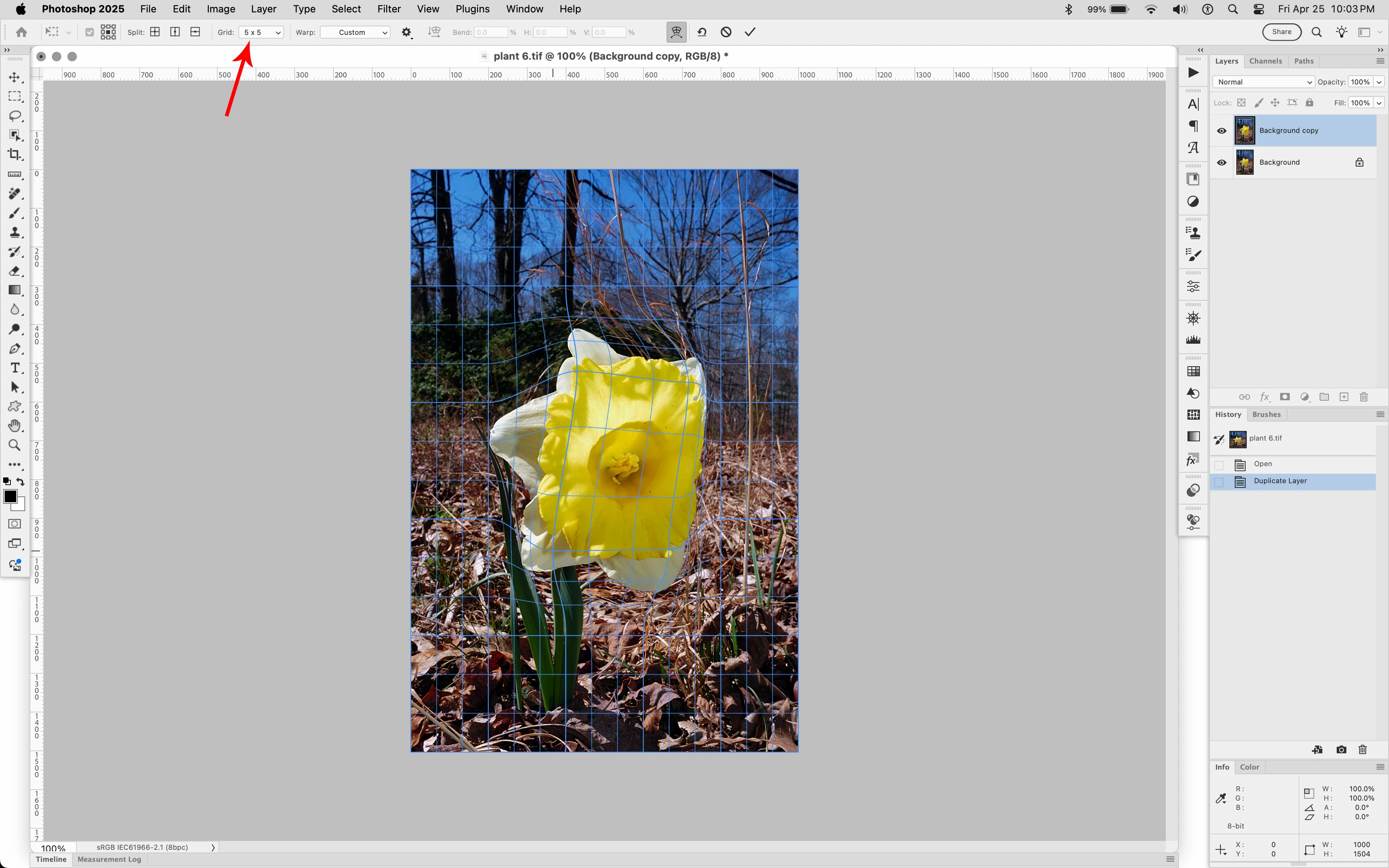

    Newer Photoshop versions have an adjustable Grid size for Image>Transform>Warp
    https://helpx.adobe.com/photoshop/using/warp-images-shapes-paths.html
