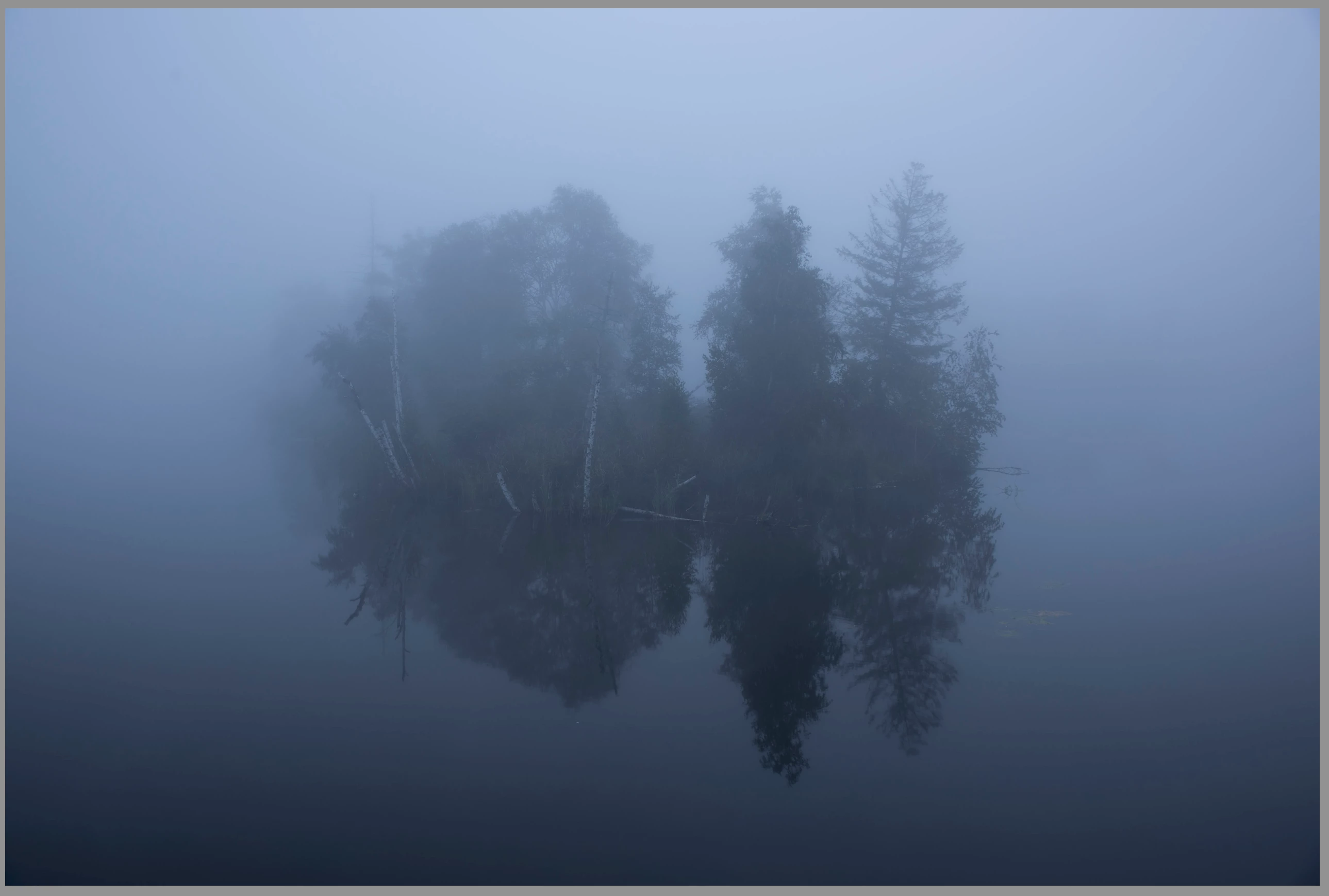

I have a weird issue with just Photoshop, where Images have weird Color Banding when I load them into Photoshop from Lightroom. The unedited RAW file looks fine in Lightroom, but weird in Photoshop, so this seems to have nothing to do with the usual contrast or excessive hue/sat color banding. Both programs use the same Color Space, ProPhoto RGB.
When I export said .tif from Photoshop as a .jpg, the jpg looks fine (even in Photoshop).
When I save the .tif in Photoshop and it comes back to Lightroom, it looks fine.
I can screenshot the issue and the banding is clearly visible. Here's the same picture, once screencapped in Photoshop, once screencapped in Lightroom. Completely unedited (SOOC) RAW file.
Photoshop
Lightroom
In the Photoshop image, you can notice something that looks sort of like magenta colored waves, which go through the entire image. It also has a slightly green tint compared to the Lightroom picture.

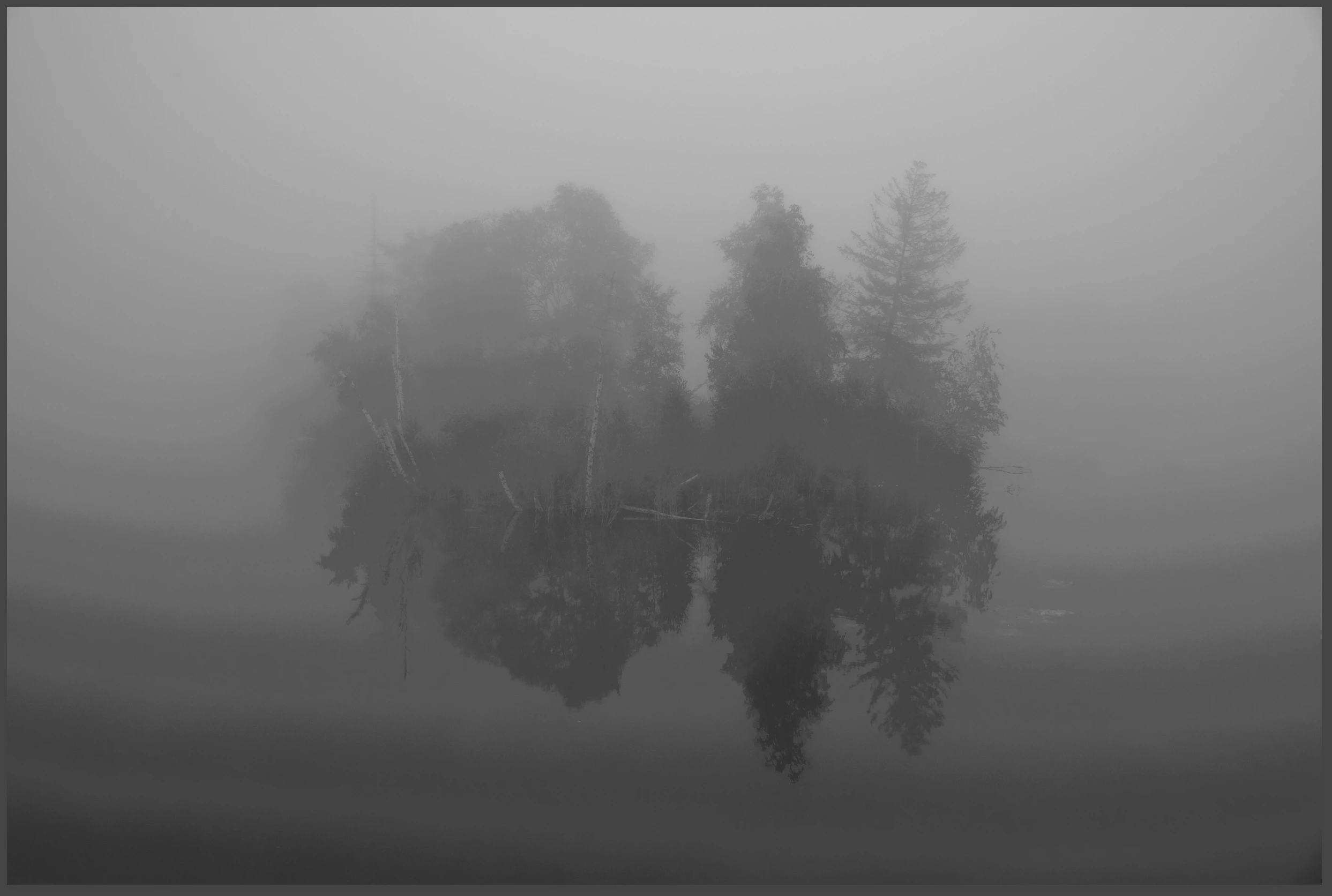

This looks very much like an old bug happening with ProPhoto files when GPU is set to "Normal" or "Advanced" modes.
Look at what happens in the red channel:
It's an inaccuracy in OpenGL code. It happens when converting from ProPhoto into your monitor profile. You only see it in ProPhoto because ProPhoto is extremely compressed in the shadows, causing minor inaccuracies to become amplified.
Try Adobe RGB, or set GPU to "Basic", or both.
