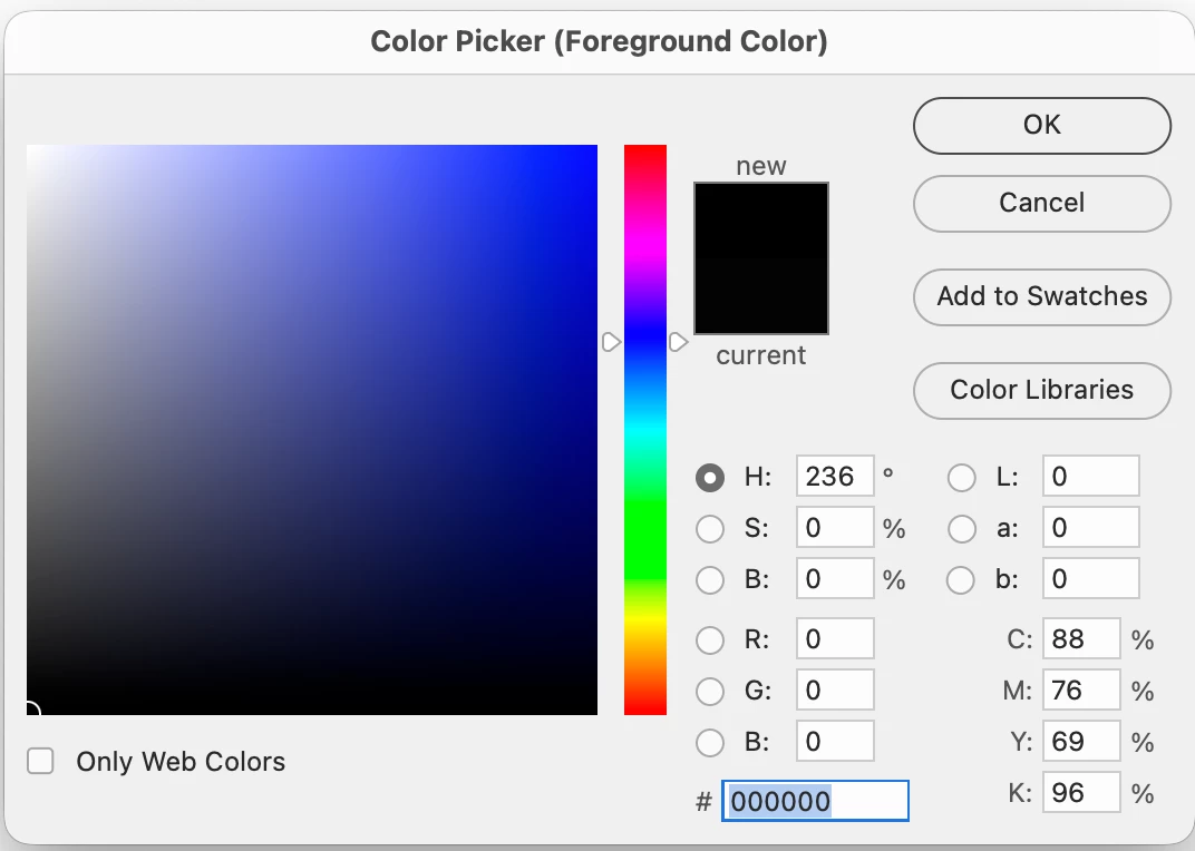

    I’m running 8-bit RGB. I’ll attach the color picker as viewed from the tool menu, as well as the HUD picker.
    mawiroAuthor
    Aug 14, 2026 12:00 AM UTC
    Color picker on tool bar
