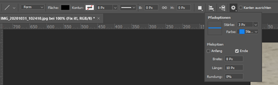

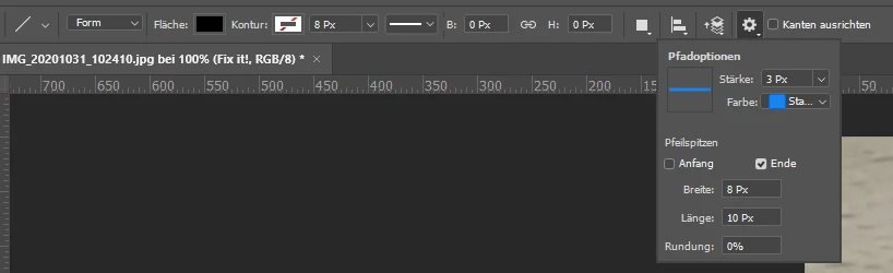

I have Photoshop 22 that was auto-updated and now the Line tool is different.
There is no line thickness value anymore and the arrow values changed from percentage values to pixel values. When I draw a line all I can see is the arrow head, not the line itself.

To adjust the line weight, use Set Shape Stroke Style text box, to the right of Stroke color.
Not sure why you are only seeing the arrow head and not the line itself. I am using the same settings that I see in your screen shot.

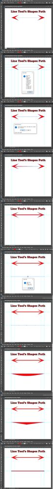

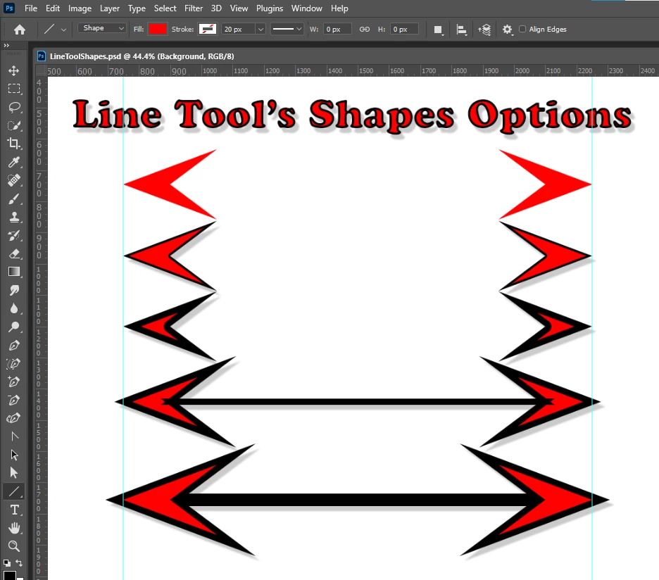

Yes you now have options to stroke Arrowheads inside,  or  stroke Arrowheads and line outline with single width stroke, or  stroke Arrowheads outside single width stroke  and  the line with double width stroke. You have a 50% chance of hitting your target.  When you do it will be without an arrow shaft.
