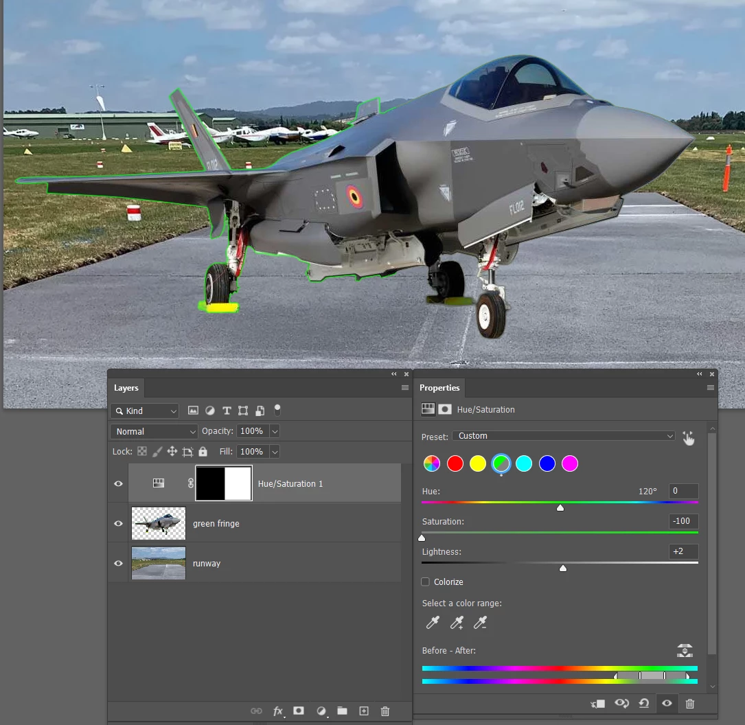

If you really need to fix a coloured fringe, then a Hue/Sat adjustment layer will usually do the job.
I added a green stroke all round the aircraft.  I then added a Hue/Sat layer, and selected Green.
I simply reduced saturation to make the green disappear.  (I filled half of the mask with black so you could see a before and after.
873869iC071CE77E11C111E.png873871i8E2BD84C0F9932C3.png873873iB94AC0A2BD9751C4.png873874iC02B0B3567A88D7D.png

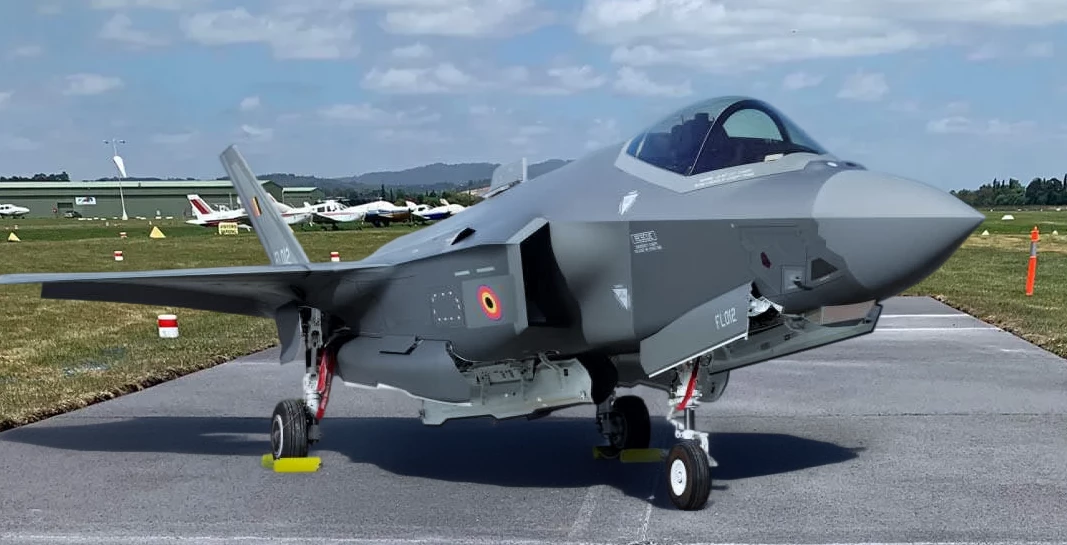

This is how it would look if I used Harmonize to fit the aircraft to the runway background.
You get three options to choose from.  You can see that Photoshop has added shadows and changed the lighting.

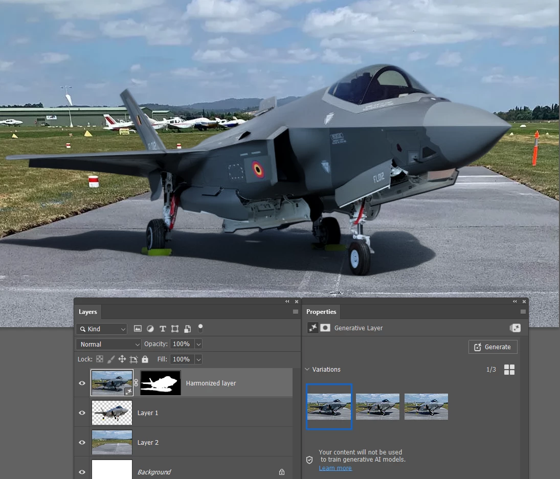

Option 2

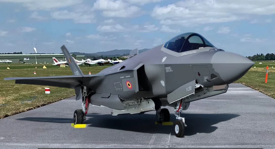

Option 3
