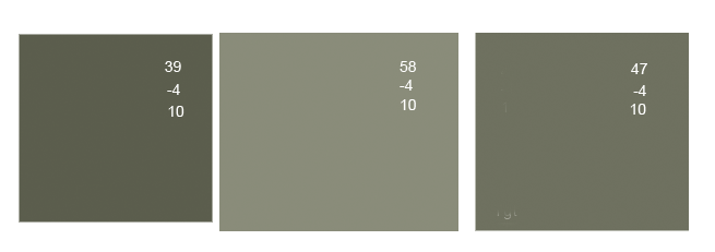

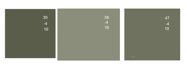

    If I understand correctly, you have three color samples that you would like to vary only in lightness. Working in RGB where lightness and hue are combined is presenting a problem. If that is the case, consider this:

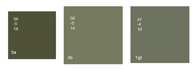

    Since, with Lab Color, Lightness may be adjusted separate from Hue it may be the best way to get the desired result. In that regard, and since we don’t know the current color profile, I brought the color samples into Lab and they provided the following numbers in the Info Panel as shown in this illustration (I suggest that you take your own readings}:
    Top number: Lightness. Scale of 0 to 100. 100 is white
    Middle number: Green value. Scale of Green 0 to -128. 0 is no green.
    Bottom number: Yellow value. Scale of Yellow 0 to 127. 0 is no yellow.
    For example:
    Comparing 3b to the Tgt, 3b is a tad lighter, a negligible amount greener and more yellow.
    Comparing 3a to the Tgt, 3a is darker, a negligible amount greener and more yellow
    To provide a common Hue:
    At this point you may go to the Color Picker and provide a common  a  and common  b  value. To match the Tgt:
    The  a  channel for each sample should be -4.
    The  b  channel for each sample should be 10.
    To key on the Tgt Lightness:
    The Tgt value is 47
    Currently the lightest value is 50 and the darkest is 34. Since the current spread in Lightness is 50 – 34 is 16:
    3a should be 8 less than 47. 39.
    3b should be 8 more than 50. 58.
    You need not choose an 8 point Lightness difference. Suit yourself. The HUE won't change.
    Note that, in the Color Picker, the equivalent RGB values in your chosen color profile will appear as you adjust the Lab values.

    find attached one task I have.
    image 3a creates image 3b when run in a pc game,
    I need to adjust image 3a by the amount that 3b differs from my target colour., hoping that then when played I get the target colour appear.
    Or in other words show Pshop progression from 3b to target, and ask what is that progression if applied to 3a ?
    I can see that for 3b to match target, it needs to lose a bit of yellow and maybe a little saturation and go a bit darker, or maybe the darkening will be enough, forget the slight loss of saturation.
    so how do I do that in pshop (I am CS6)
    There used to be lessons in school , as bone is to dog, mouse is to....answer cat !
    or as shoe is to foot, glove is to.....hand !
    here it is 'as 3b is to target', 3a is to...answer ?
