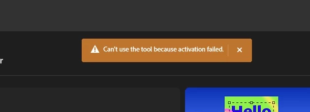

when I use the remove tool I am getting an error message
I am using Adobe Photoshop updated version, when I use the remove tool I am getting an error message that is "could not complete your request because of a program error" and can't use the tool because activation failed. Can you help me fix this?

Sep 30, 2025 1:49 AM UTC
For those that are seeing this issue, if you have an Intel GPU, can you share its name (see * below)?
Anyone seeing this who does not have an Intel GPU?
Temporary workaround:
  • Open Photoshop
  • Go to Edit->Preferences->Image Processing
  • Find "Remove Tool Processing" option, change value to "More Stable"
  • Click OK
  • Close and restart Photoshop
  • This should avoid the error by forcing the use of the CPU instead of GPU. When the issue is fixed in a later Ps update, you will want to reset this option to "Faster" for best performance.

Oct 3, 2025 11:11 PM UTC
Intel(R) Arc(TM) 140V GPU (16GB)
Oct 4, 2025 12:55 AM UTC
Hi @Karen30534490ovyq , thank you for responding - that is one of the GPUs on which we observed the issue, and I believe Adobe will be addressing the issue in a future update.
Did the above workaround help?
