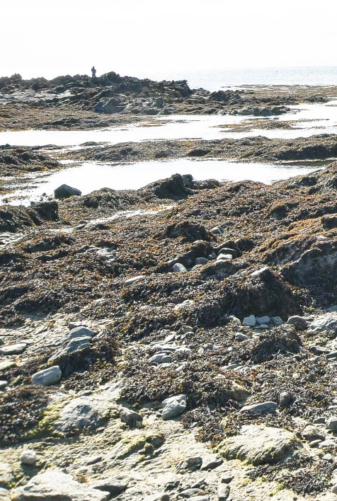

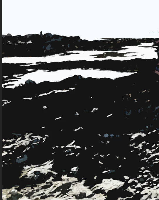

I want to make some of my photos look like watercolour images.  I am following a (very good) tutorial, but when I use the Dry Brush and Cutout filters, the image becomes very contrasty and parts of it go totally black which doesn't look great and doesn't look like a watercolour either (haven't tried other filters so not sure if the same thing will happen). I've clipped a part of the image to illustrate.

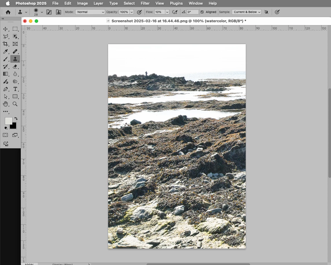

Could you please post screenshots taken at View > 100% with the pertinent Panels (Toolbar, Layers, Options Bar, …) and the Filter dialog visible?

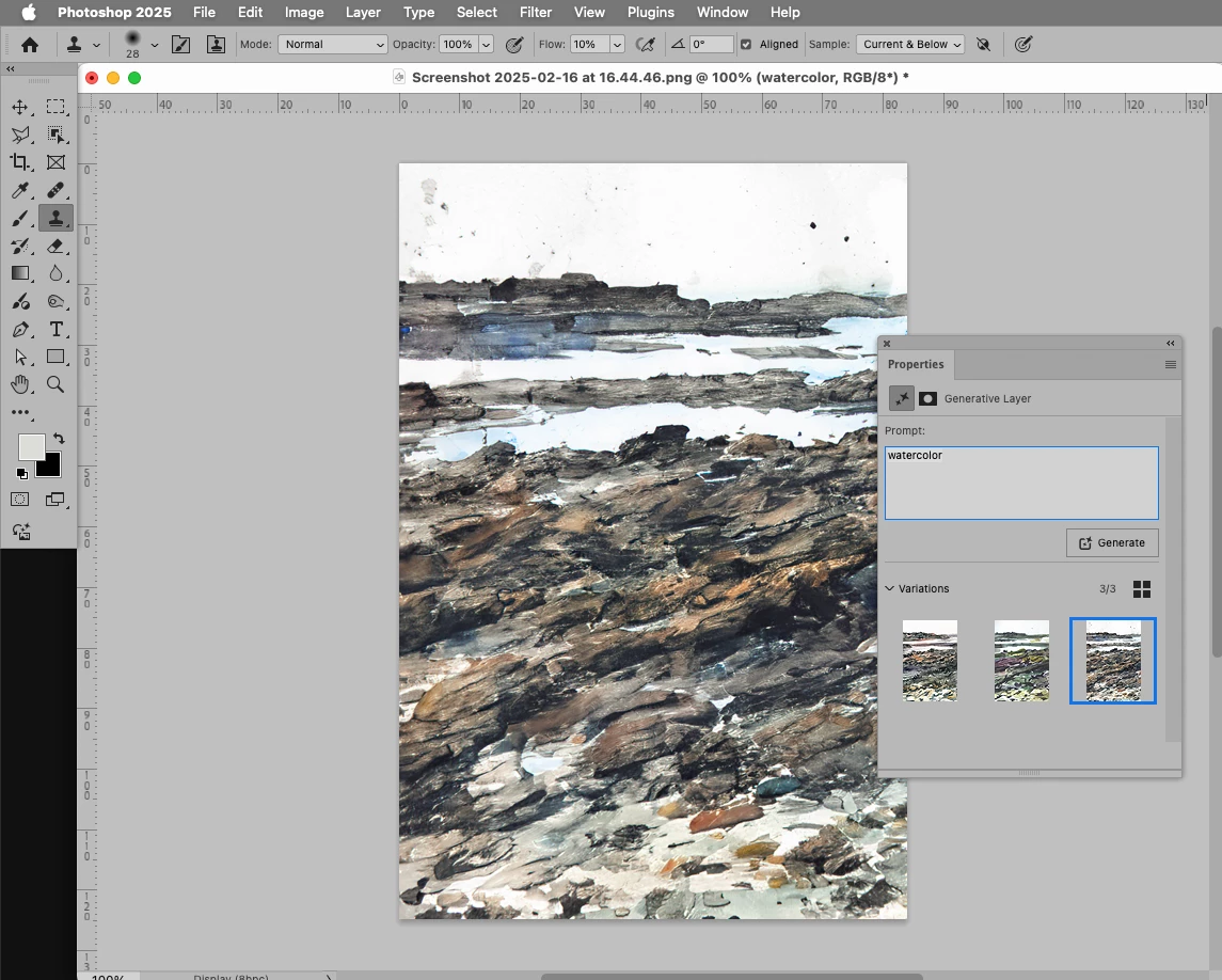

Another option would be using Generative Fill with a low Selection.

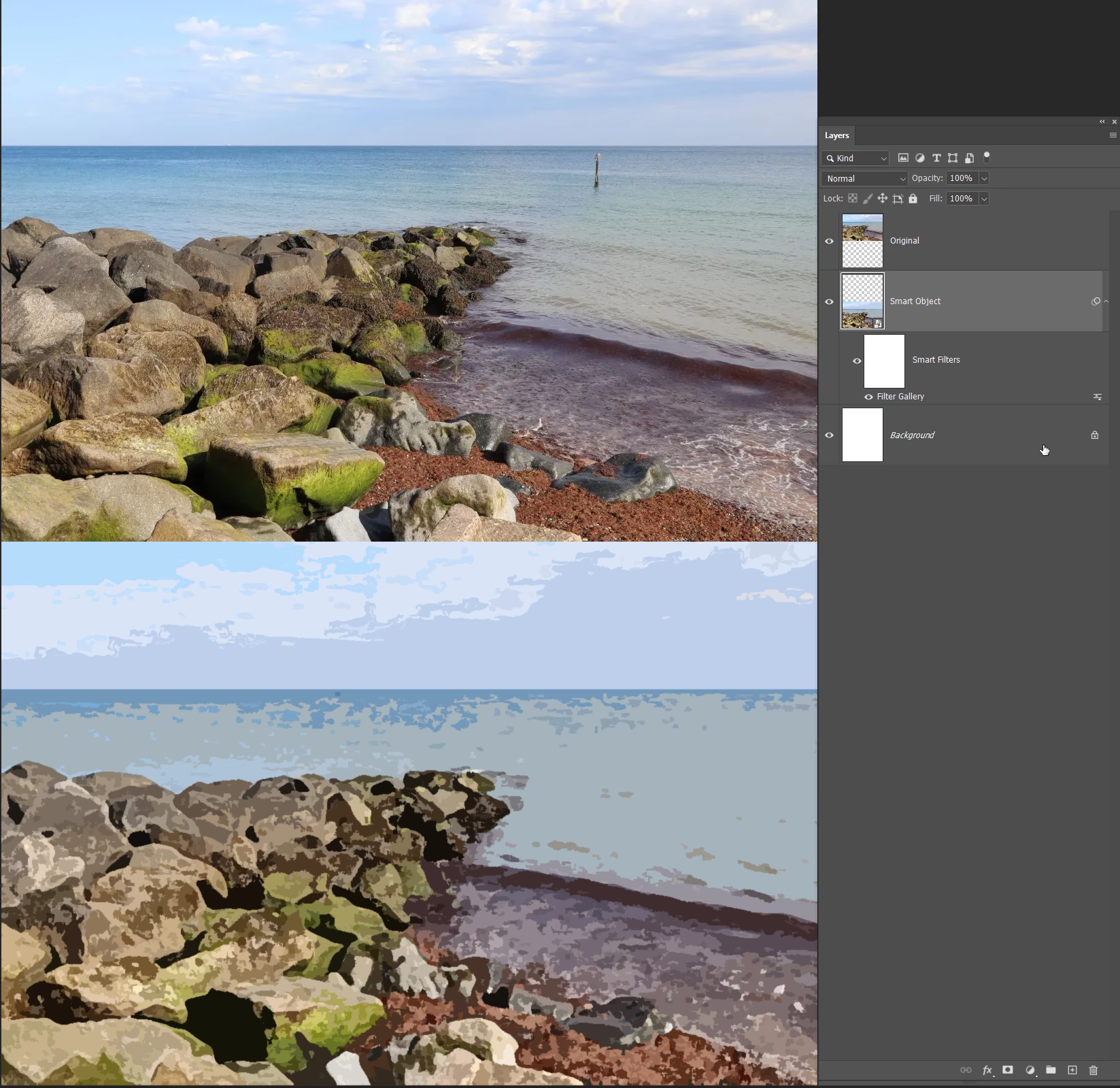

Hi Janet.  That image is not a good fit for those filters.  It has a limited colour range and the back light is causing its contrast to be high. Something more colourful will work better.  Make the layer a Smart Object so you can use Filter Galery non-destructively.

Dry Brush: I think your Dry Brush's Brush Size and Texture sliders are turned up too high.
I'm guessing the Edge Simplicity slider is set too high.
Are you using the two filters together? That would accentuate the blocked blacks even more.
