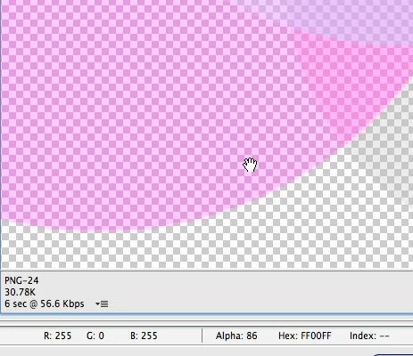

    PNG files do not support Alpha Channels but they do support transparency.  If you Command or Control click on the Layer thumbnail to load the selection you can then add an Alpha Channel in the Channels Panel. That will allow you to "see" the Alpha transparency for what its worth. It will not be saved with the PNG.  Alternatively you can bring up the Save for Web dialog and as you mouse over the image areas you will get an Alpha indication in the bottom of the window.

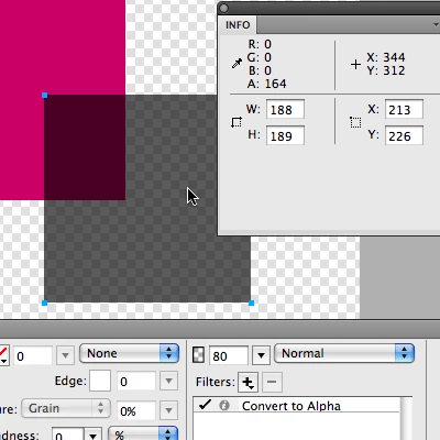

    In this image you can see the A value. The object was pink and then converted to Alpha with a transparency of 80%. So, the Alpha object and properties are editable.
    When opening the file in Photoshop you will see the same as you have been. 3 channels with transparency but no additional channel.
    So to answer your ultimate question. Photoshop does not do what it apparently did for you in Version 6.
