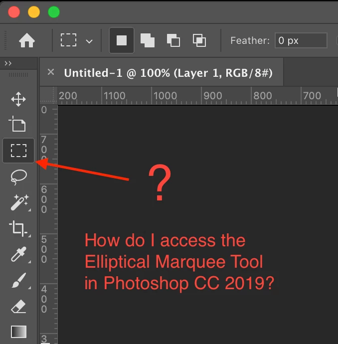

I can longer access the alternates for the Marquee Tool (M) in version 20.0.3 and I can't find any documentation about this change.
  • There is no triangle in the lower right corner of the tool button indicating alternates
  • Pressing M does not toggle the Elliptical Marquee as in previous versions
  • I uninstalled the app and reinstalled it to see if there was a problem with my installation — no change
Is this a bug or a UI change?

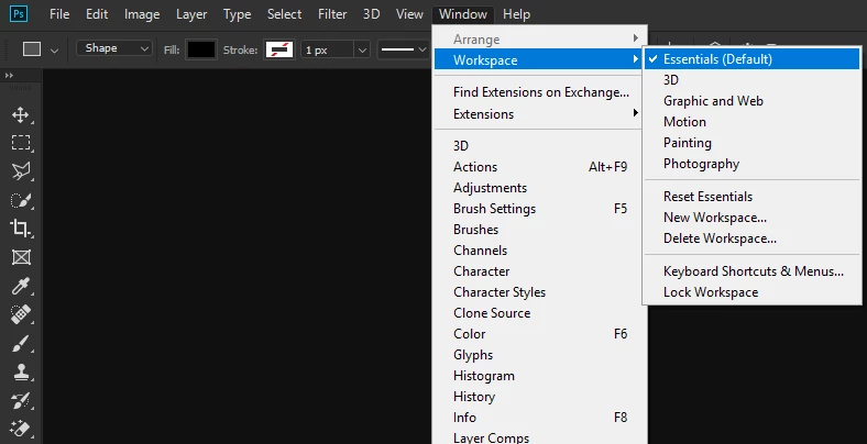

Hi
What option have you selected from here

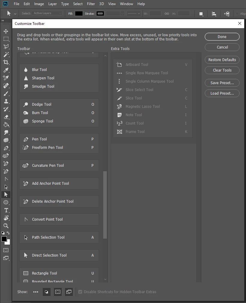

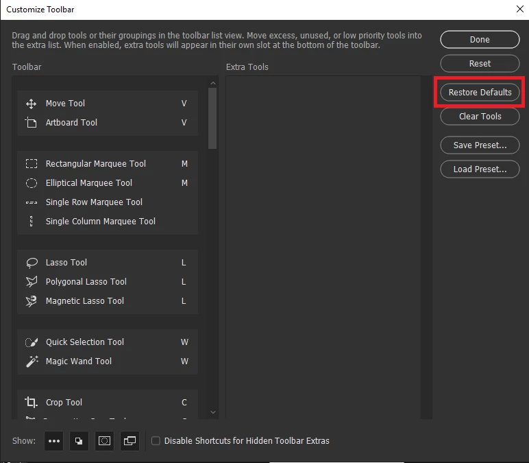

Also check Edit > Toolbar

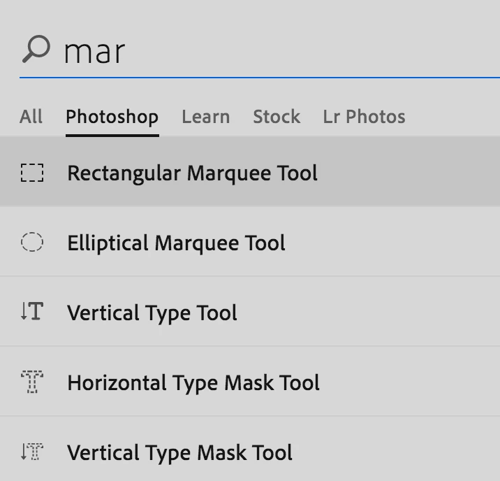

Hi Greg,
Ged's answer is best as a permanent solution. Another thing you might find helpful is using the search button in the upper right:
Here I set it to "Photoshop" and started to type "marquee". Clicking on the tool name will take you to the tool, even if it is hidden.
~ Jane
February 20, 2019
Thanks for the tip, Jane! I was using the (unhelpful) help menu and overlooked the search feature in the upper right corner.

Its a good way to extend the toolbar and eliminate tools you don't use. Like I do not use tools like Artboards, Frame, slice and other tools I want quicker access to switch to them so I add their icons into the tool bars. Like I not good at switching Pen function with modifier keys so I brake out pen tools selecting.

Thank you! I had the workspace set to "Graphic and Web" which eliminates the Elliptical Marquee Tool option. Changing to "Essentials" brought it back.
