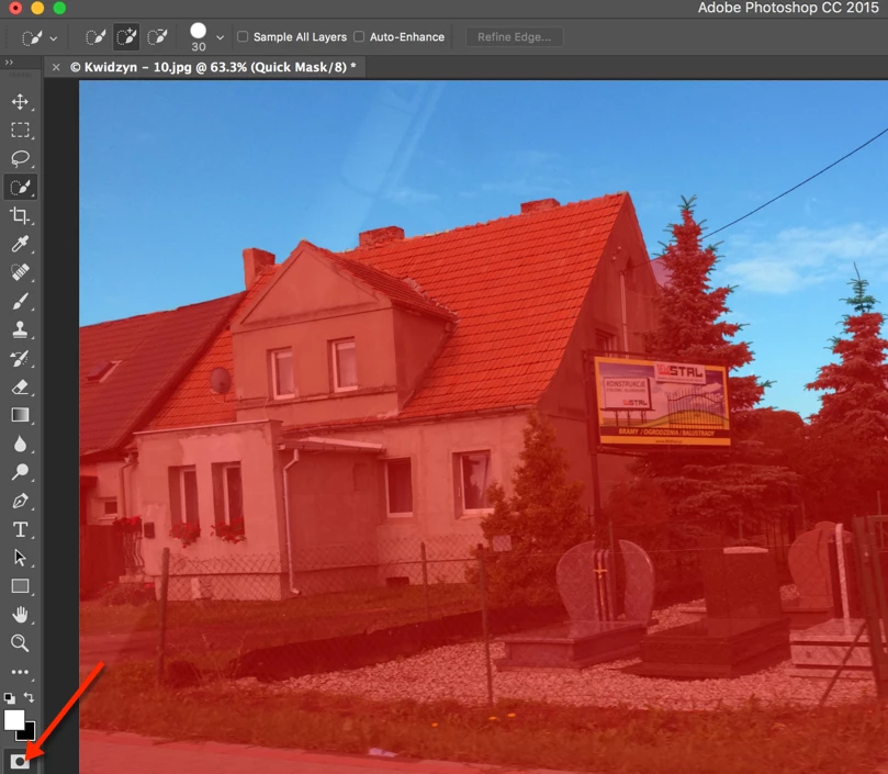

I agree with Paul; it sounds like you want quick selection. After pressing "Q" to toggle quick mask mode, you'll paint or draw with any brush or other painting tool, using white color to select and black color to deselect. The mask shows in rubylith (red) color everywhere except where you are selecting (selected areas are normal color). Another "Q" toggles back to normal selection mode with the marching ants.
There's also an icon on the toolbar to toggle Quick Mask. Here's an image showing the sky selected in Quick Mask mode. The quick mask tool icon is highlighted with the arrow:
