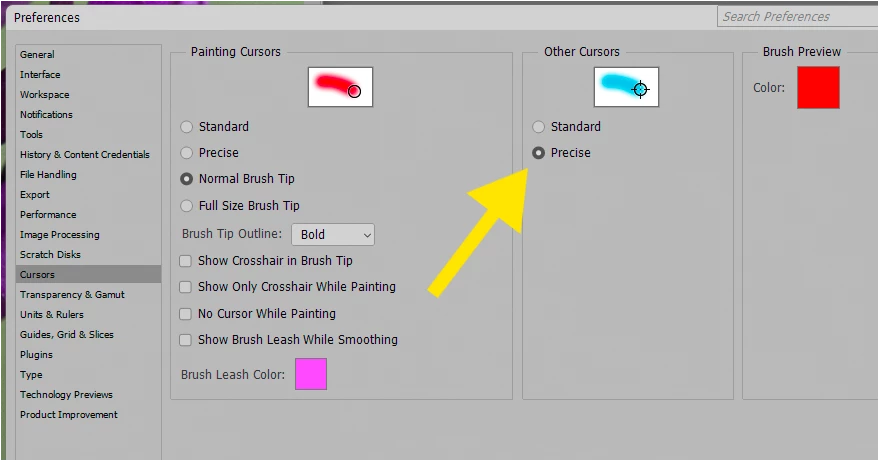

    D Fosse
    Feb 21, 2026 10:06 PM UTC
    If you go to Preferences > Cursors, and set it to “precise”, you get a crosshairs cursor:
    And then you can try different sample sizes in the options bar.
