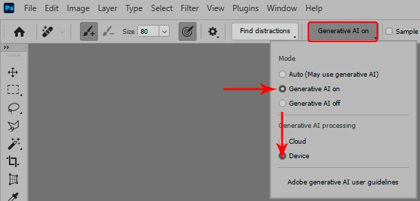

    D Fosse
    Aug 24, 2026 10:40 AM UTC
    ​@Corniger
    Generally, anything that stops working when you pull out the internet cable. Generative AI is not processed locally by your machine, but remotely on Adobe’s servers (or third-party vendors’ servers).
    The only exception is the new “Device” mode Remove Tool, but to get to that you first have to enable it in the rolldown:
    A global kill switch has been an active feature request for a long time.

    D Fosse
    Aug 24, 2026 5:35 AM UTC
    The Remove tool will also trigger it when generative AI is on. The rolldown in the options bar needs to be set to “Generative AI: off”.
    The Crop tool set to “expand” will use generative AI.
    All the tools that can optionally use generative AI will have a rolldown in the options bar to disable it. For the dedicated AI tools, go to Edit > Menus, and remove them from the menus.
    It’s important to be aware that some applications don’t read the Content Credentials flag, they use their own algorithms. In that case you may get false positives.
    And yes, machine learning is not the same as generative AI. Those functions don’t add external/non-native image content on their own.
