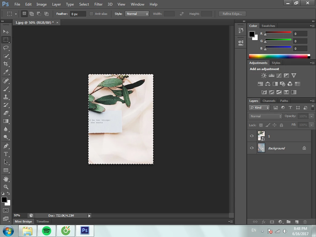

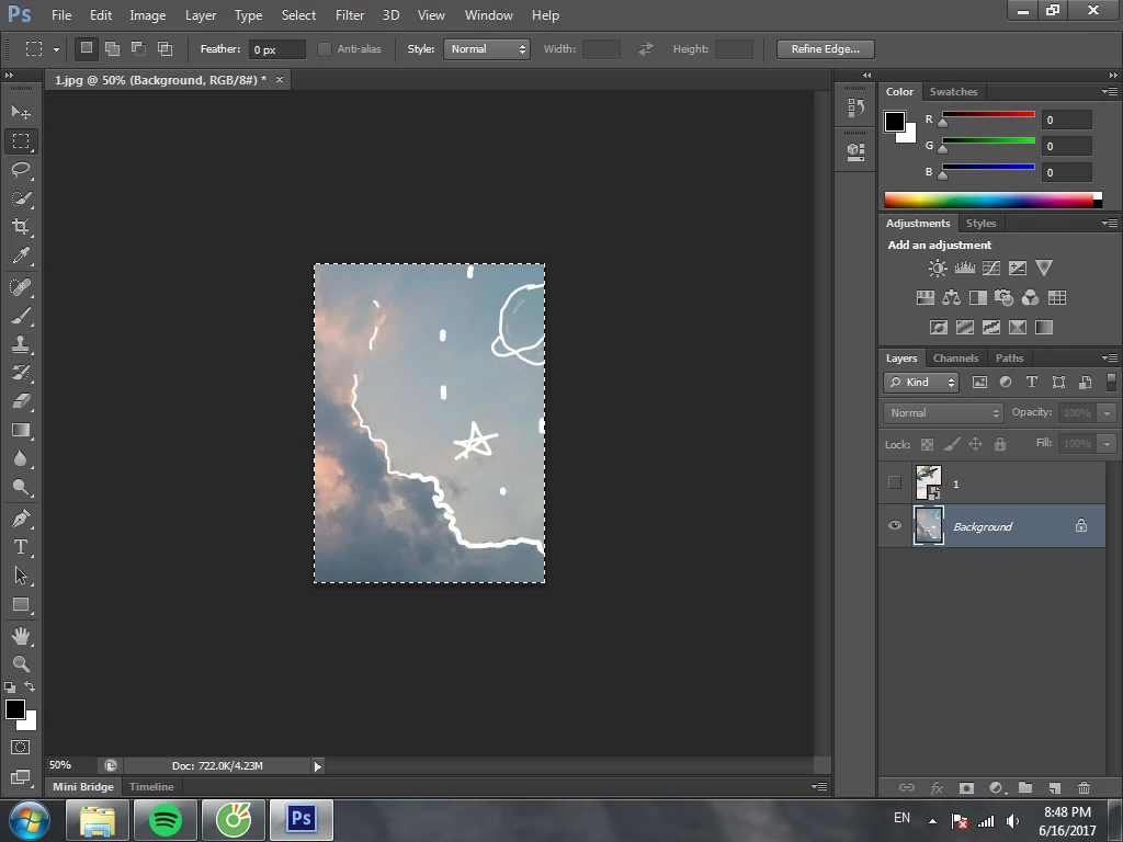

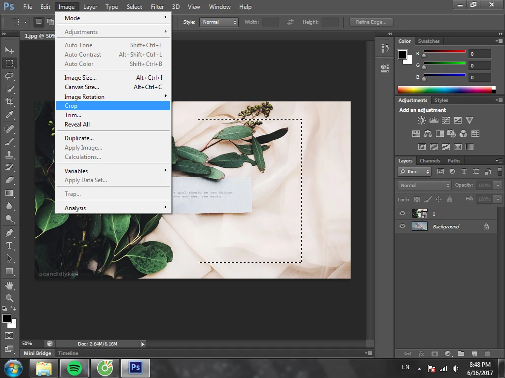

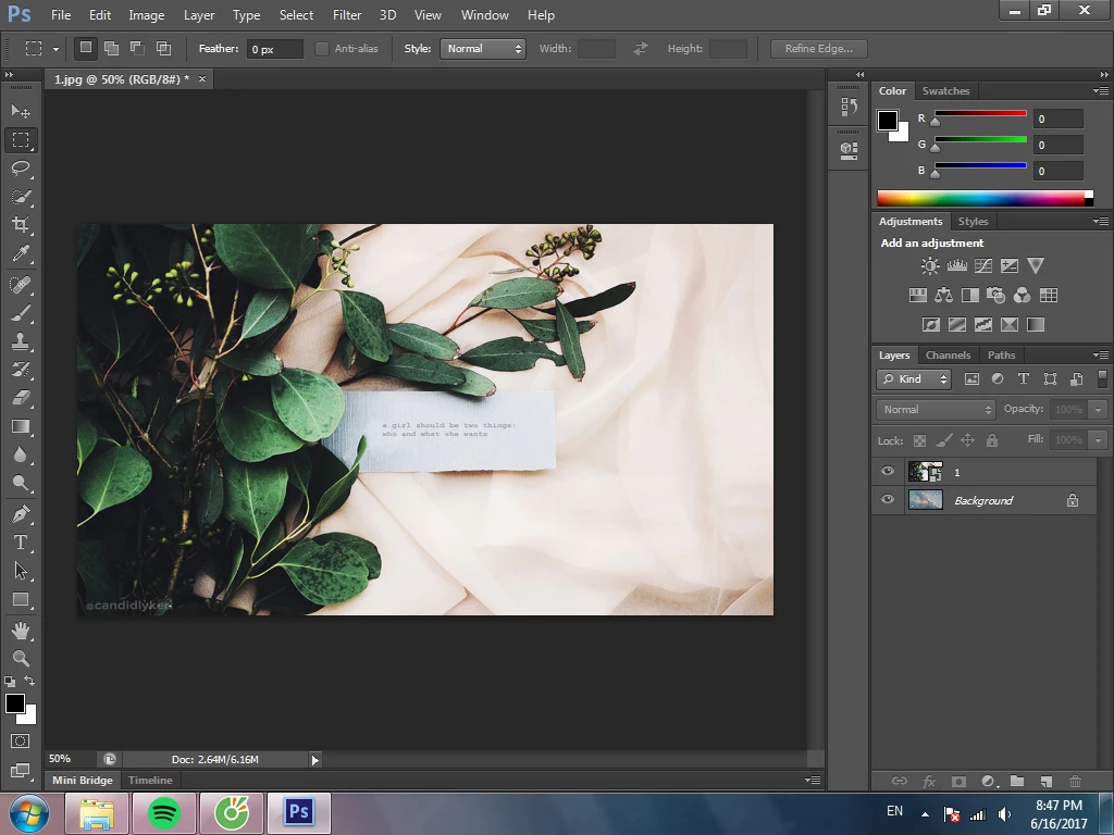

I have 2 layers. When I crop the one, the other one is cropped, too. I don't know why this happens. I tried restarting my computer and reinstalling Pts but they don't work. Please help me!
Thank you so much!
Here are the original layers
I crop one layer
Result:
          The layer I cropped:

Image Crop crops the image not just one layer
Try this
Make your selection then, with the layer you want to cut down selected in the layers panel , go to Layer - Layer Mask - Reveal Selection (or click this symbol at the bottom of the layers panel )
This will add a mask showing the layer in the area you selected but showing the layer(s) below elsewhere.

As the Layer you seem to want to crop is a Smart Object deleting is not an option so apply the Selection as a Layer Mask (Layer > Layer Mask > Reveal Selection) instead.

Apparently you do not understand what Image > Crop is supposed to do.
If you do not want to crop the image but a Layer just apply a Layer Mask to the Layer or invert the Selection and delete (though that may leave content that is off-canvas).
