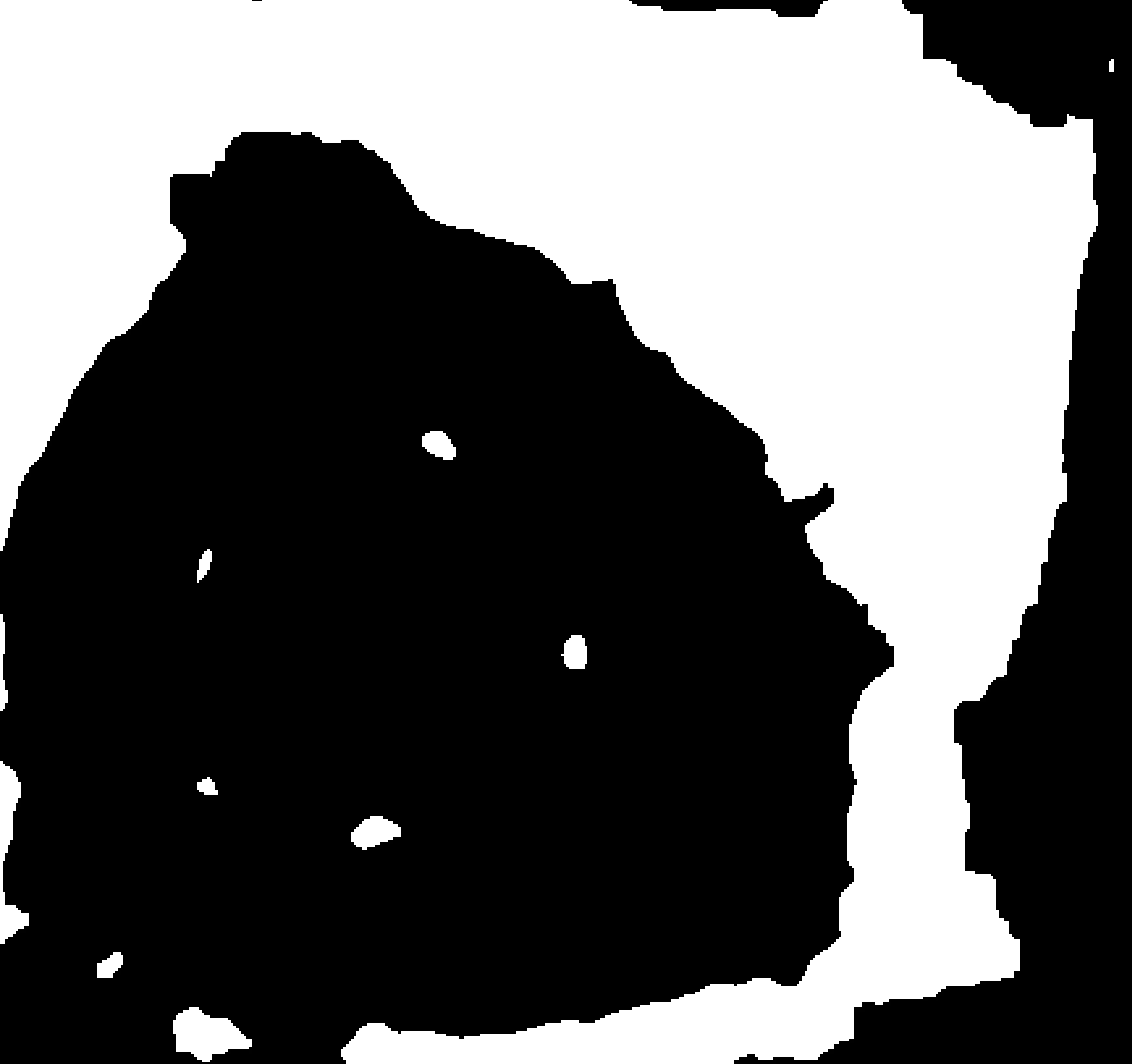

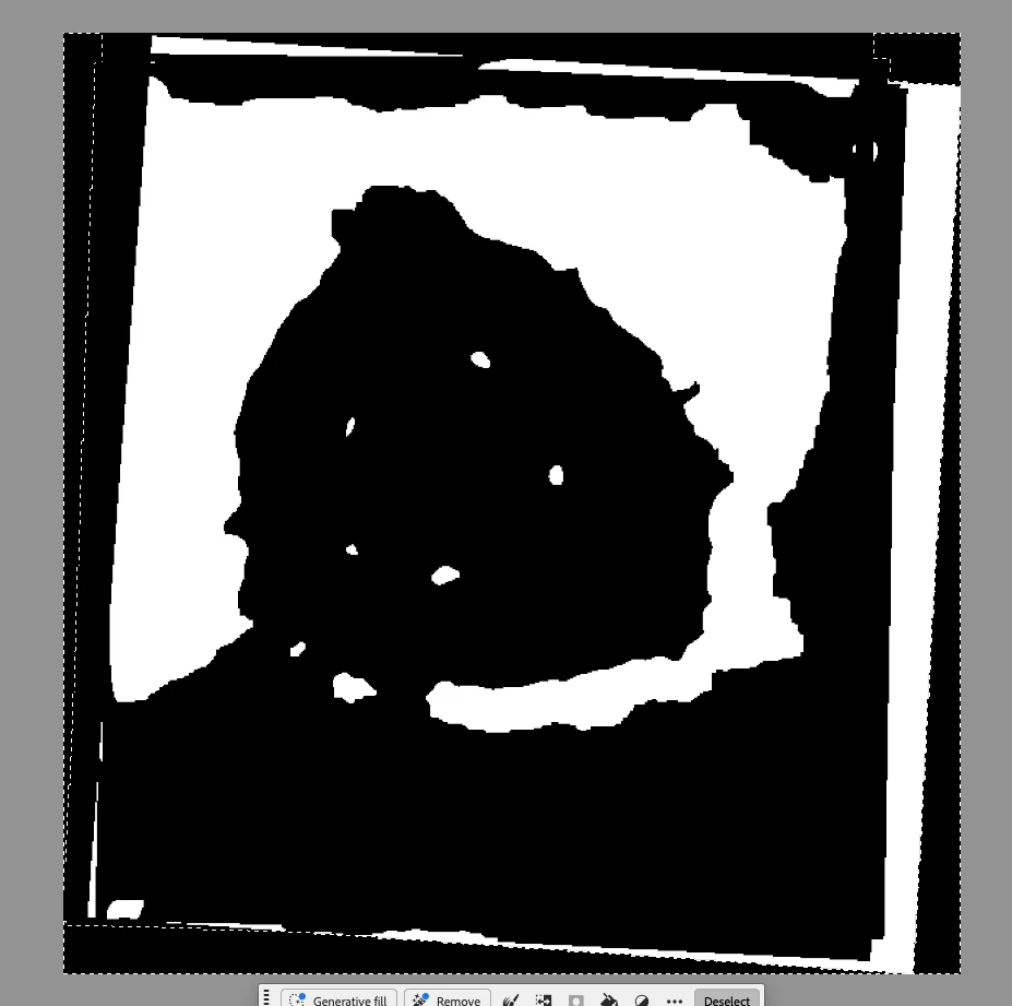

    ok here it is:
    looking at the mask, it looks like this
    but looking at the whole, it looks like this:
    those unrequired undesired selections were stopping the mask behavior.

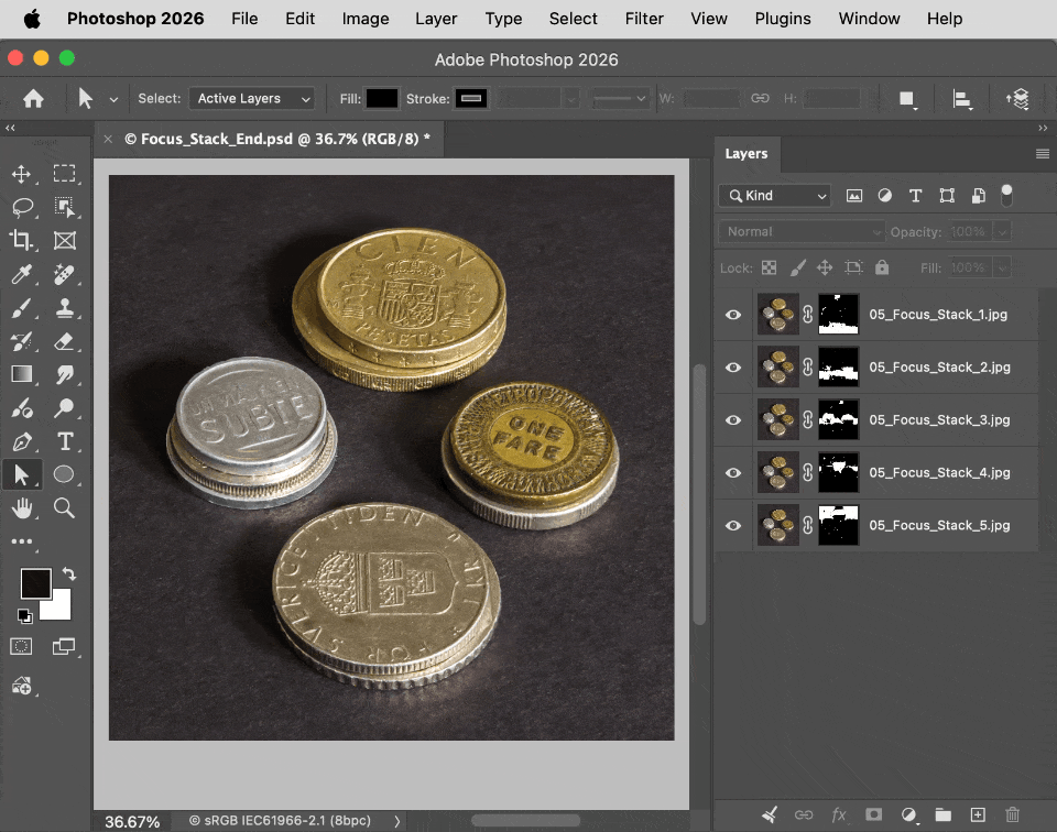

    Photoshop doesn’t have a feature specifically labeled “focus stacking,” it’s sort of an unlabeled benefit of using the command Edit > Auto-Blend Layers on a set of limited depth-of-field photos taken at different focus distances. So the question is, are you talking about a focus stack built using Photoshop, or built using separate focus-stacking software and then sent to Photoshop?
    If your focus stack was built in Photoshop using Auto-Blend Layers, then a focus mask should have been created for each layer in the document. And each layer’s mask should be viewable and editable using normal masking techniques, as shown in the demo below. If yours looks different, that’s why others have asked for screen shots of what it looks like to you, so we can figure it out. But the demo below shows how it normally works to edit the layer masks created for a focus stack by Auto-Blend Layers.

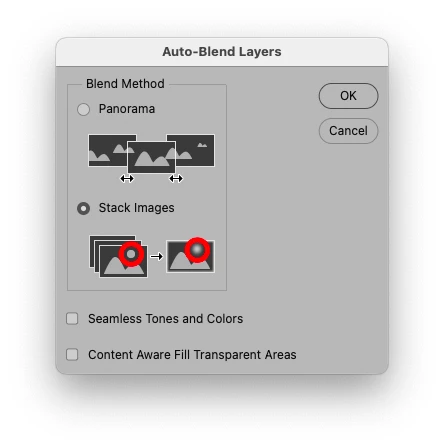

    Correct, but there is the blend option called “stack images”, so that should for all practical purposes be considered a dedicated focus stack option:
    The one to watch here, however, is “seamless tones and colors”. This adjustment will be hard baked into the pixels, and so a ghost of the mask will remain after editing. It might be better to uncheck this and do the tone correcting later.
