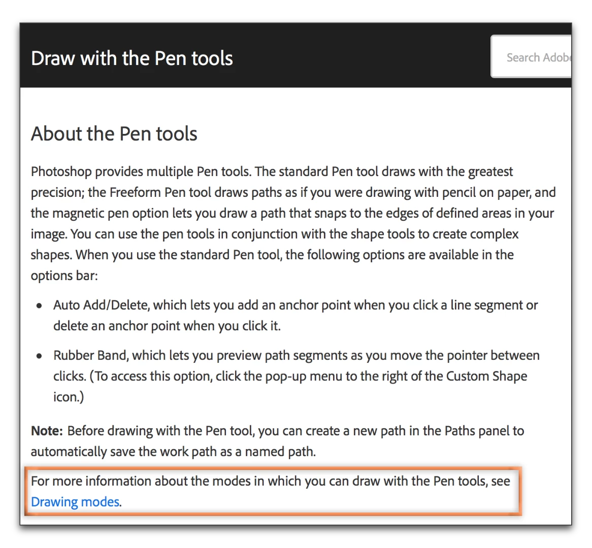

I am trying to get pen lines to stay after drawing them.  I have closed off the pen lines as indicated here Draw with Pen tools in Photoshop .  Then I select a new layer and select a circle shape and all of my lines disappear.  I am trying to draw a guitar fretboard and add different coloured circles to certain fret positions but this is seeming impossible to do.  I don't understand why Adobe make simple things so complex.

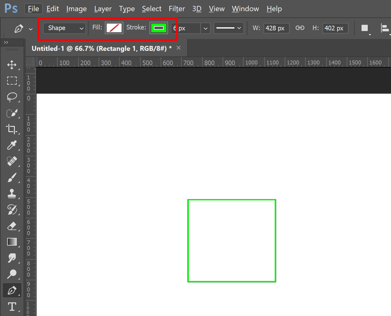

Correct answer Chuck Uebele
Use the shape selection rather than the path when using the pen tool, and set either or both the stroke and fill colors.

They all have their uses, but for your use, follow Chuck Uebele​'s advice and use Shape Layers in Photoshop, or fenjas29325284's and switch over to Illustrator.
As a trainer, here's my issue with the link you provided. Adobe mentions the drawing modes in a single sentence, and if you didn't follow the link they provided then you missed the discussion of the three modes and when to use each one. And while I'm critiquing Adobe's help files, the link they offer is to an older version of Photoshop. The info is still correct, but the modes now appear in a list (see Chuck's outline above) and not as the three linear buttons.

Chuck Uebele
Chuck UebeleCommunity ExpertCorrect answer
February 11, 2017

Chuck Uebele
December 12, 2018
Can you show a screen shot of before the shape disappears and one after? Are you sure you have shape selected, and if you do, do you have a stroke fill selected also?
