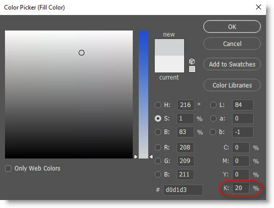

My document mode is Grayscale, but when I use the Color Picker, it offers me colors.  Specifically, When I do an Edit -> Fill and set K=20% (see below), the color actually added has unequal R, G, and B components (208,209,211).  After filling, if I check the color with the eyedropper, it reads 18%, not 20%.  Clearly, I misunderstand Grayscale mode.  What is the correct way to fill with a specific K value?
Photoshop 21.0.3 on Windows 10.

But how can I use the color picker to choose a specific grayscale value?  When I entered K=20%, I got K=18%.

The numbers in the color picker relate to your working spaces - except for the open document, where the embedded profile overrides the working space.
But there is no grayscale readout in the color picker. A grayscale value is not the same as a CMYK K value. Grayscale is subject to color management just like any other mode. The numbers will vary according to your working gray. The same gray tone will give different numbers in Dot Gain 15% and in Dot Gain 25%.

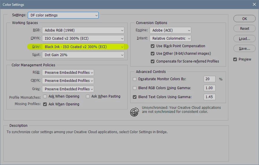

Is this for printing on the black plate only? That's the usual scenario for working in grayscale. In that case you'll get better consistency by setting your working gray to <black ink> in your preferred CMYK profile:
You do this by clicking "load gray" in the rolldown, and picking the CMYK profile you want.
