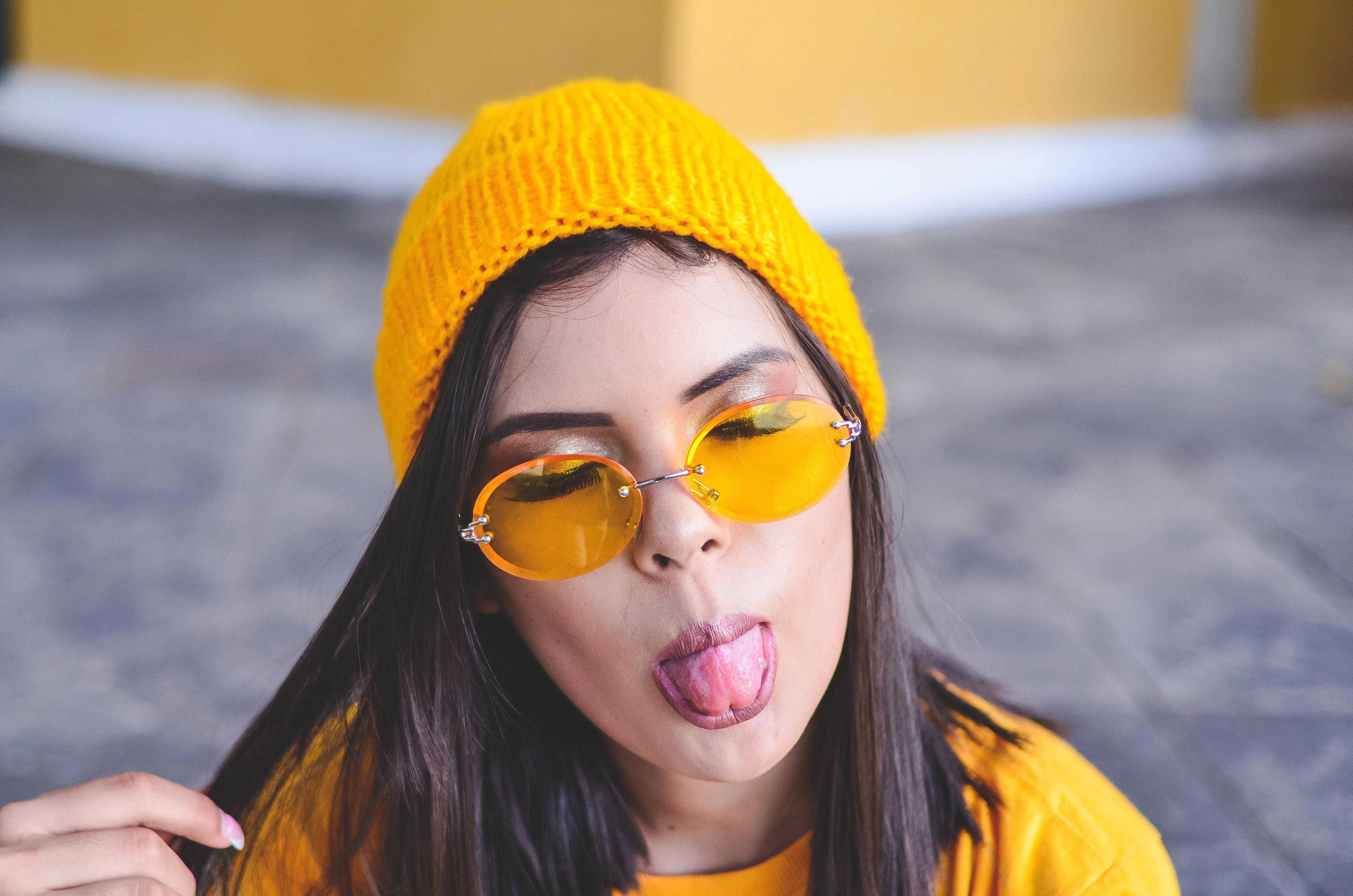

I have changed the hat and glasses in the image from yellow to pink.
For some reason the resulting colour looks bit glary/harsh and unrealistic.
I have tried playng around with hue and vibrance etc but with no better end results.
(Sorry for the poor selection, it is just for the purpose of practice.)

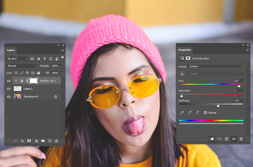

Here's how I would change the color for the beanie:
  1. Make a new layer just for the color
  2. Use the Object Selection Tool to select the beanie
  3. Go to Select > Expand to enlarge the selection (I did it by 2 pixels)
  4. Go to Select > Modify > Feather to soften the edge of the selection (I set it 2 pixels)
  5. Select the pink color you want to use and go to Edit > Fill and set Contents to Foreground
  6. In the Layers panel, change the Blend mode from Normal to Hue
  7. Use the Eraser tool and/or Blur tool on the color layer to touch up the edges
  8. (Optional) or touch up the edges by adding a Layer Mask (with the color layer selected, click the 3rd icon from the left at the bottom of the Layers panel or go to Layer > Layer Mask > Reveal All) and using a brush to apply black where you don't want the color to show and white where you want the color to show
Additionally, if you wanted to have more control over the color, saturation, and brightness, you could add an adjustment layer that's clipped to just the color layer. To add this adjustment layer
  1. Click the 4th icon at the bottom of the Layer
  2. Select Hue/Saturation...
  3. In the Properties for Hue/Saturation, click the Colorize button
  4. To clip it to just the color layer (in other words make the adjustment only apply to the color layer), hover your cursor between the Hue/Saturation layer and the color layer and Alt (PC)/Option (macOS) + click (you'll see the cursor change to an arrow on a right angle and when you click, it'll put that arrow to the left of the Hue/Saturation layer.
Now you can use the sliders to make changes.
March 12, 2020
Thanks so much Myra for your help!
I learnt a lot from what you wrote.
I think I have done something wrong along one of the steps though as somehow everything tuned to a coral colour?
Prior to the colorize button, I made it this shade of pink.
Nicer shade of pink I think, but still unatural, harsh and glary looking somehow.
And like the colour somehow isn't "infused" into the fibres of clothing like they are in real life clothing (I hope that makes sense!).
If you wouldn't mind helping with these questions?
Step 8:
Painting black works for me but with white doesn't. Is this because I am trying to paint outside of the areas of my (poor) selection to fix it and this cannot be done?
Adjustment layer Step 3:
When I click colorise the image turned like a "sepia red effect".
Step 4: When I clip it it turned the coral colour mentioned above.
